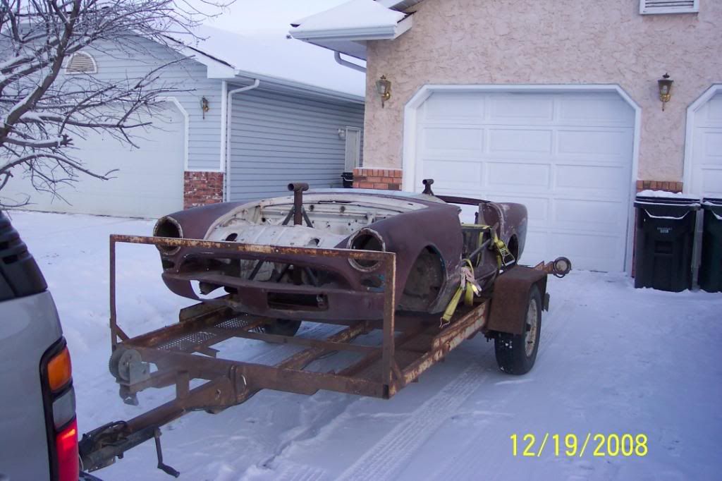

Ok so here goes... a little over a year ago i picked this car up for my dad as a restoration project... I've had his garage tied up with minis and various projects of my own since i was 16... 5 years ago... my dad always said he wanted a project of his own once i was out of the garage... after much effort i just couldnmt convince him to get a mini...we had discussed what sort of car he wanted and though he was unsure he did mention he would enjoy a small convertible... at that time we had things like triumph tr6 and mgb's in mind though... he was out of town on business and i was almost finished the resto on my 79' mini so after convincing my mom that it wasn't for me and stating my case she agreed with the idea so i went and picked it up and had it stowed away in the neighbours garage when he got home... i pushed it out on the street and had a ribbon on it in the morning as a surprise for him hahaha....

here are pics as promised... 56k be warned though...
on the street in front of my neighbours house as my dad saw it for the first time...

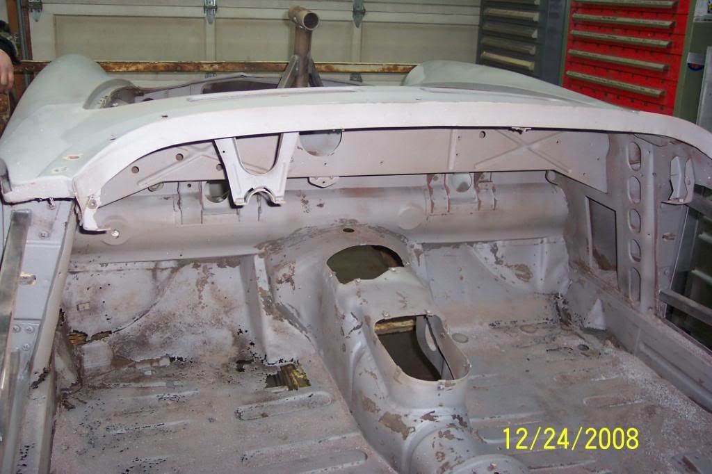

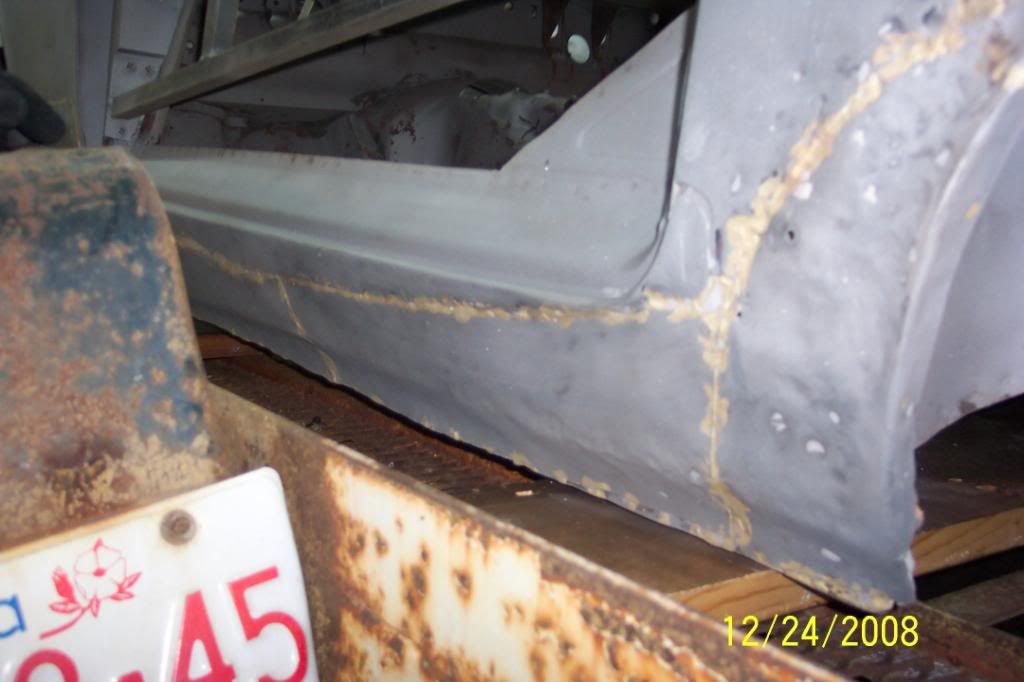

Posted 28 December 2008 - 06:46 PM
heres the car back from the blasters... no more secrets all the poor repairs from this cars past life are on display and obviously need attention... rough patches brazed over rust and probally nearly 3/4" of filler in places...

-well cars do rust pretty bad out here as well... if you need proof look at the minis that i have rebuilt... this particular car has been off the road since 1986 and had quite alot of undercoating on it so that makes a big difference... though it is alot worse than those pics make it seem... the frame crossmembers are rottten as well... so although it isn't terrible all the rot is from only 22 years on the road.
