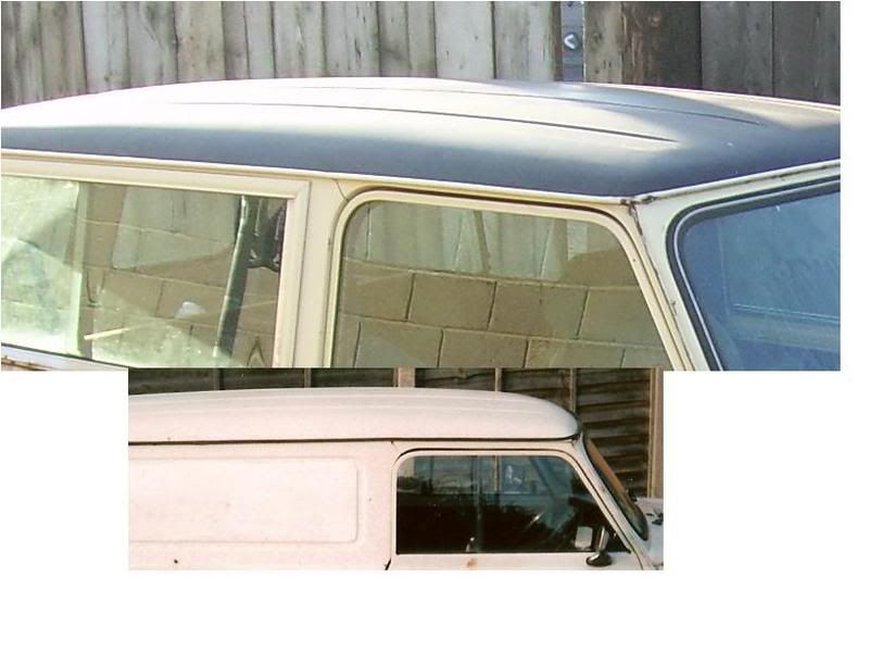

Sorry i wasn't talking about the gap i was talking about the amount of metal. The door appeture is a different size the early one is shorter ie more metal between the gutter and the door top than a later internal hinge car where the distance down from the guttor to the door top is smaller. if i can in the light tomorrow i will get two pics to show comparison.
Edit just found two of my pics i could use. top one is of an estate internal hinge door the lower of my mini van.

I dont see that really being a problem if I try this. As long as the sloping section of the frame is the same angle, then the height doesnt matter. The wind-up window will just not wind up the full amount when its closed.

Yes that's the easy bit. If you want to make the upper part of a later door fit an early aperture all you have to do is drill the top hoop away from its welds where it joins the door shell and weld it back in place lower down, the actual top is the same shape. It's the lower part of the door that's a dramatically different shape and that's where you need to swap the door frame pressing. Although the easiest way is probably to swap the whole pressing rather than graft the two together.

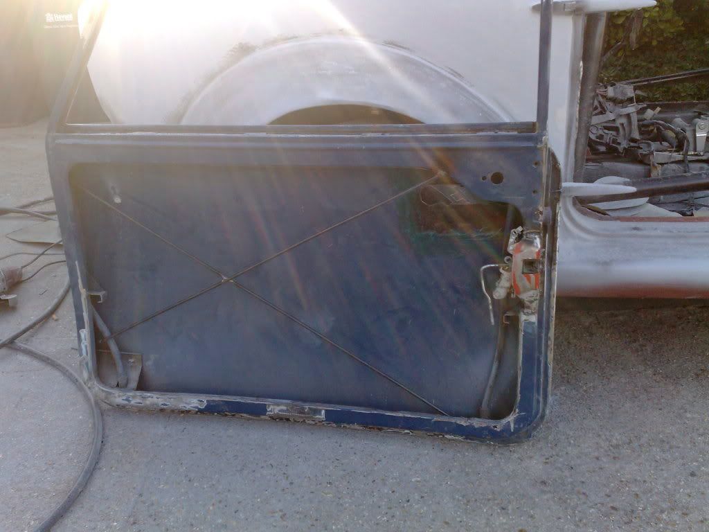

I have a bare old van door and an old "wind-up" door to experiment on before trying this with my "good" doors. A bit of grinder and welder action revealed that its actually very simple indeed to fit the wind-up windows to an early door.
Feeling all smug with myself, and about to start chopping the good doors, I then realised a fundamental problem - the van door handle mechanism crosses the cavity of the door, preventing the glass from dropping. Bummer. I briefly looked into changing to later style door handles and latch mechanisms on the van doors, but it all starts getting very complicated. I will measure up finally tomorrow, but it looks like its a no-go, with not enough space to mount the modern latch to the door and the striker loop to the shell.
This has hacked me off somewhat, as I HATE sliding windows, so I think tomorrow will be spent scrap-yard diving to see if I can find an alternaive door latch and handle mechanism. My brother in law reckons 2cv stuff might be up to the job.
