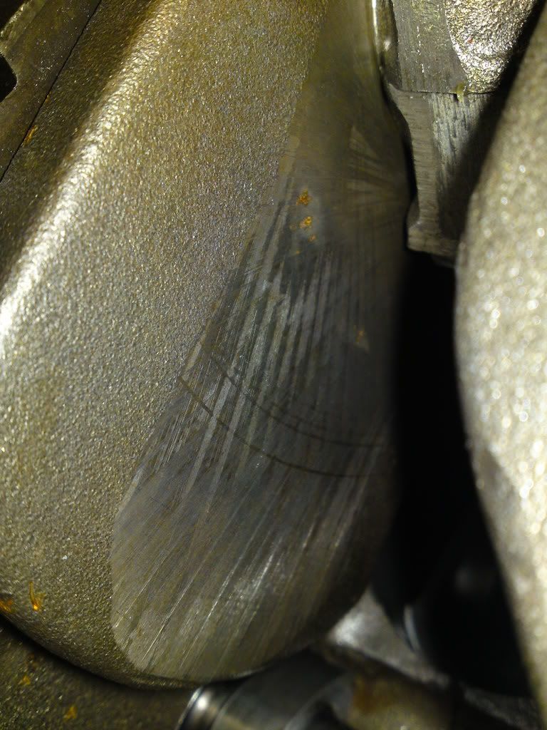

Well about a year ago I bought a dismantled MG 1275 engine from a lad on here and decided it would become my 1330 project after I alredy fitted a 1275 into Frankie.
I sold the head and cam to fund machine work and am pleased to finally annouce the build is under way!! ;)
So on 25/09/08 I dropped my block, crank, pistons, cam etc to the machine shop for it all to be balanced, bored, ground and checked over (all new bearings to be measured fitted too).
Time went by and I didn't like to pester the guy as it was a mates rates kind of arrangemnt through my uncle. But i picked it all back up a week ago.
But he did explain theat when he faced the block he noticed a crack between 2 and 3 - obviously not good. So he put it back on the mill and decided to mill a bit off, didn;t work, milled again, didn't work - then he started to get worried. Milled it a 3rd time and the crack disappeared. So just to make sure he milled it a 4th time and all is well :)

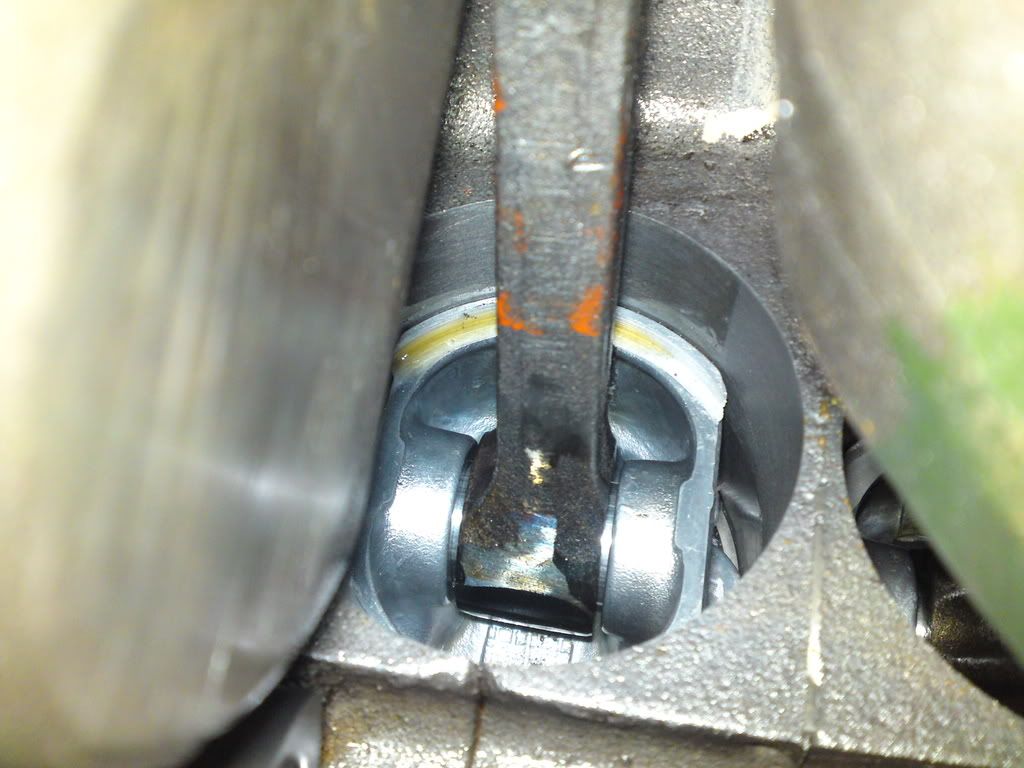

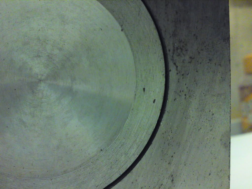

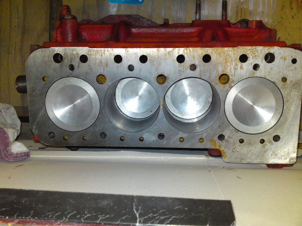

Time to fit the pistons then - disaster as now the pistons hit tdc above the face of the block :) - no worries he says i will machine the pistons too :)
(notice lack of part numbers etc)
So the block and pistons have been decked 15 thou as well - slightly upping my CR - can only be good lol!

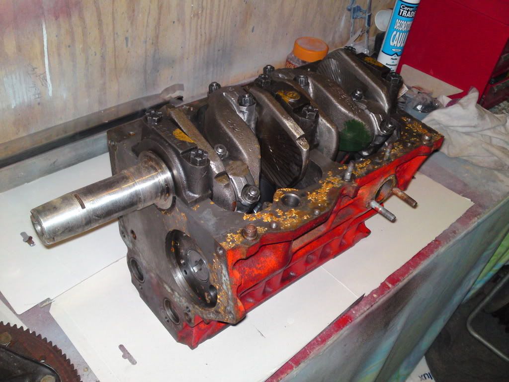

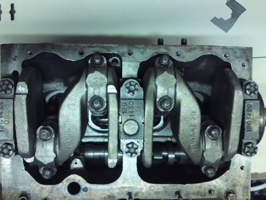

And the guy had built it all up as well!! Apparently he always does to check things out.
block
Posted ImagePosted Image
can just see grinding marks from balancing
assembled
