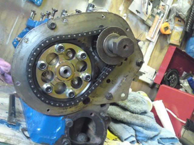

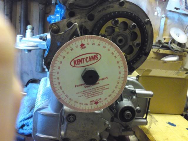

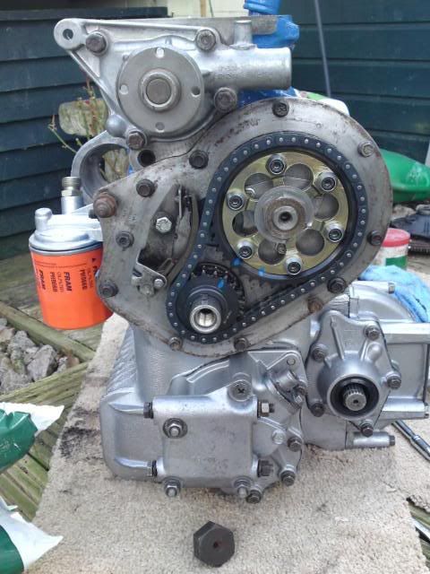

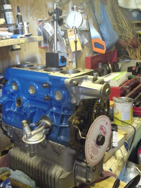

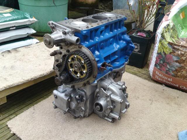

Well time to update this a bit........
Had a day off work last week and got the cam timed in and stuff (lots of patience required)
Posted ImagePosted Image

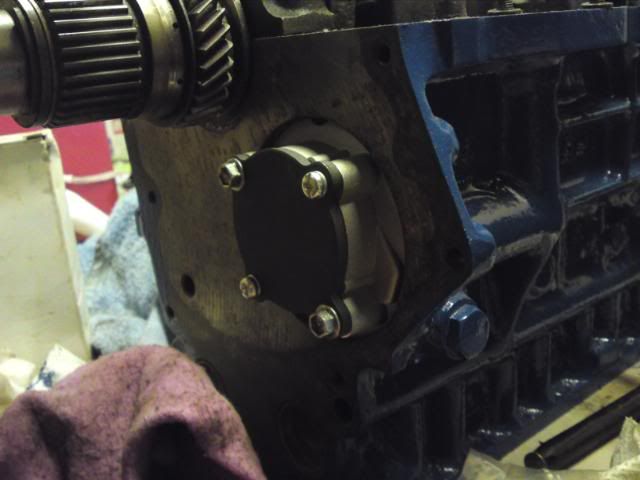

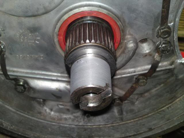

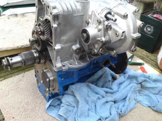

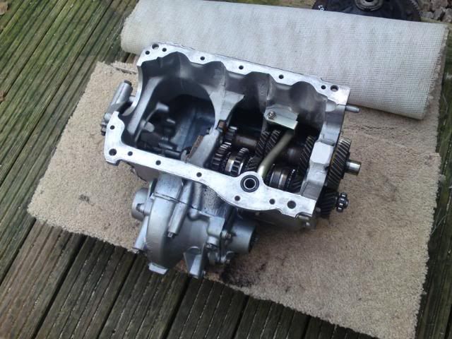

The gearbox came back last Friday with a price tag of £325, but all the bearing cases were split and totally shafted, the diff pin had 1mm worth of wear from the planet wheels!! The guy that rebuilt it said he'd never seen one so bad!!
So after a week of evening fannying about with endfloat clearances (which all turned out ok with me only having to buy a new c-clip and primary washer thingy) I took the stpes of mating the block to the gearbox.

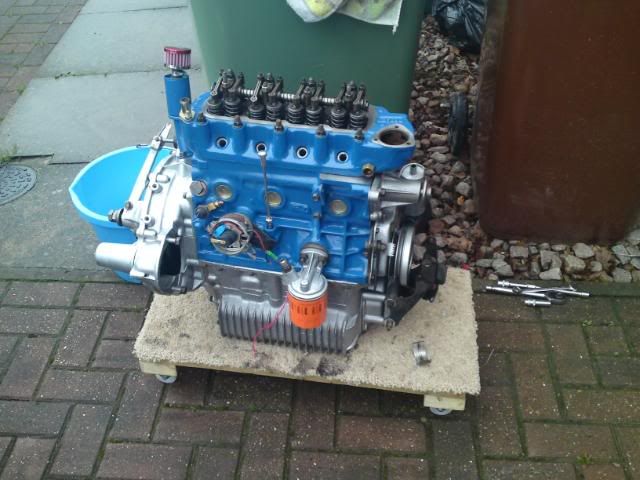

right way up:
ooooooo vernier :cry:

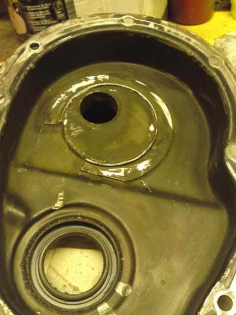

modified timing cover

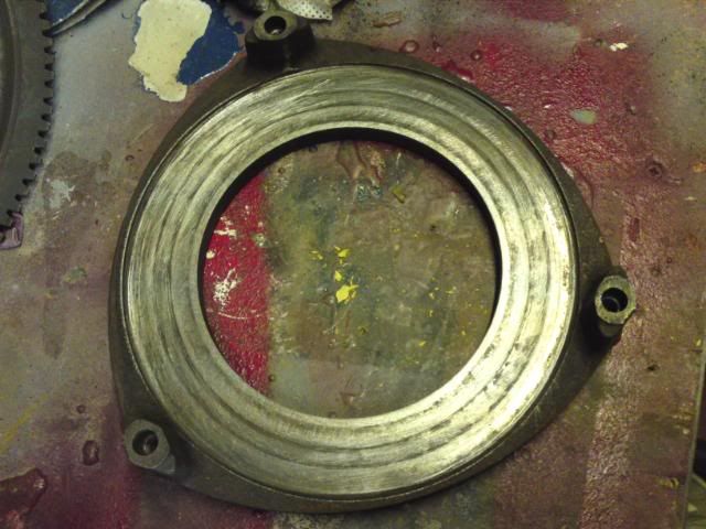

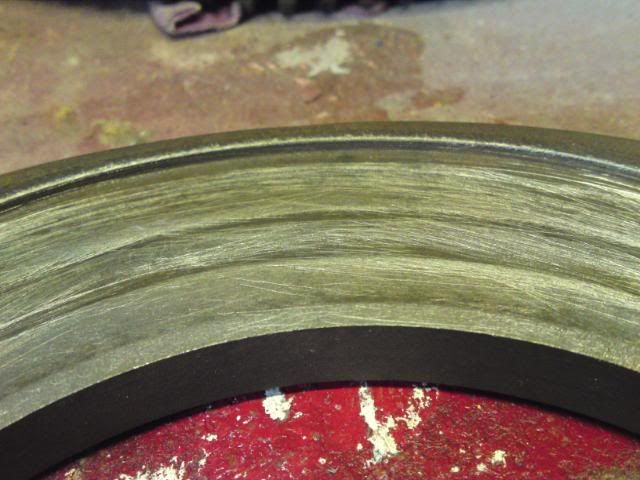

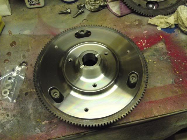

Next problem is my flywheel and back plate, flywheel has inertia 107 tooth ringear - boo and back plate is scored :xxx:
Do i just buy new and not tell the wife ;)................

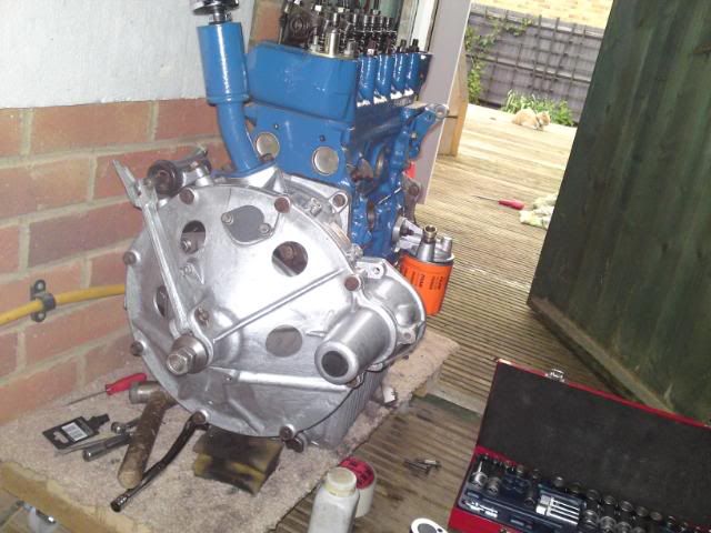

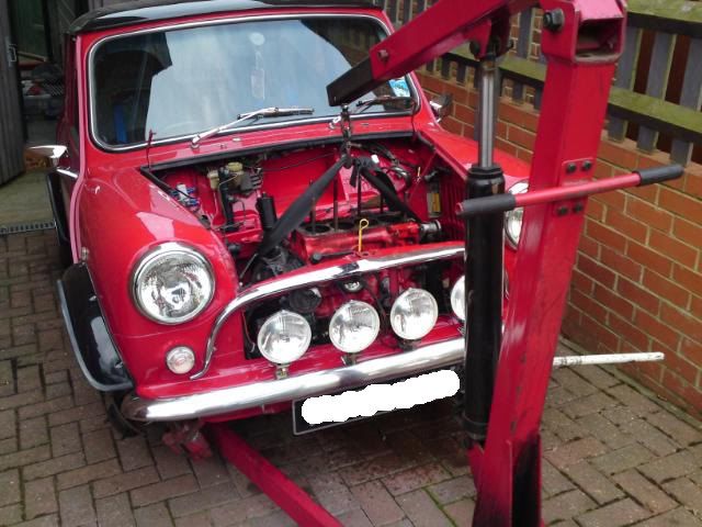

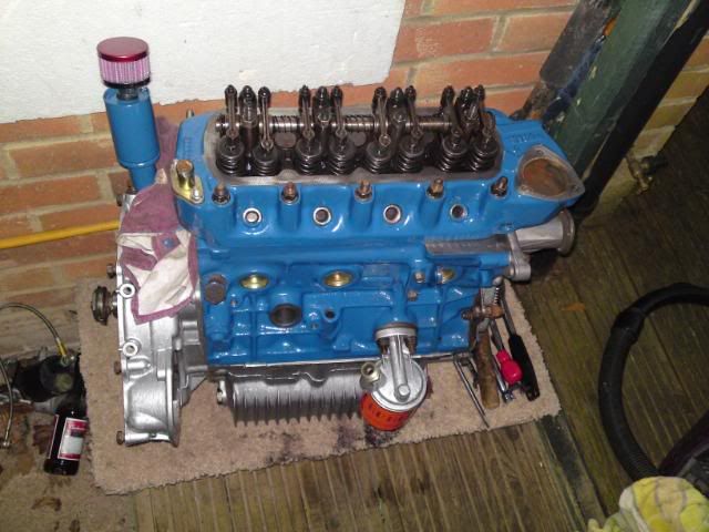

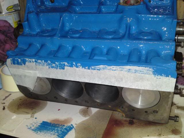

Well has been another week or so and had this week off to get the engine fitted etc, but we took a few days out to go the The lakes but this is where I'm at now..........
New flywheel as old one had wrong starter gear and backplate was fudged..
Old engine stripped

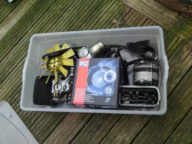

Handy box of bits..
New flywheel lapped onto crank

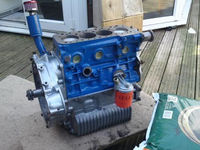

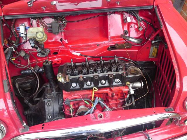

Engine built and gaps set
Posh flywheel cover (from shifty)
Old engine on it's way out

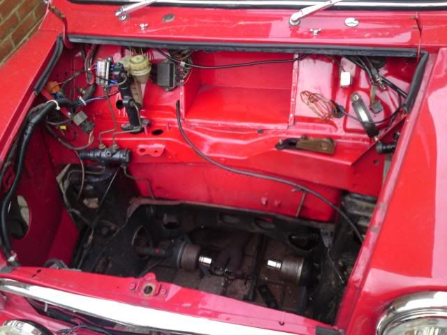

Bay cleaned ready for new lump
Hopefully weather permitting I will be able to lay the new lump in and replace the leaking clutch master cylinder and maybe get it fired up, got a weird feeling of excitement and worry as I have put a lot of time and money into this build............

I like the Blue on the new lump, something different. Best of luck for the fire up, try and get a video of it >_<

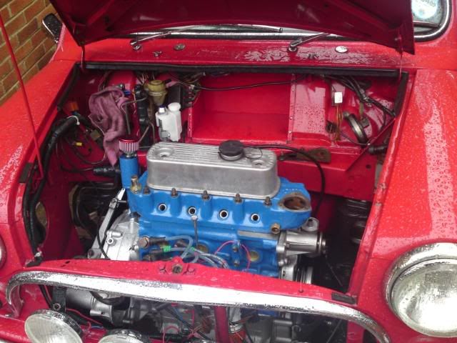

Well the engine is bolted in but rain has definately stopped play which is really annoying as the 2 days I have off work to do it it rains :dontgetit: country!!
Also need to check the dizzy drive is the right way round but in this weather it will just hve to wait >_<
#27 WiredbyWilson
WiredbyWilson
    WiredByWilson
  • 5,004 posts
  • Location: Kent
  • Local Club: WiredByWilson
Posted 17 April 2009 - 04:06 PM
On home made wheelie-trolley >_<
In it's new home...............
