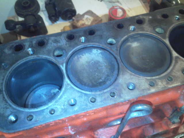

Right well heres a quick pic of what i'm trying to clean up:

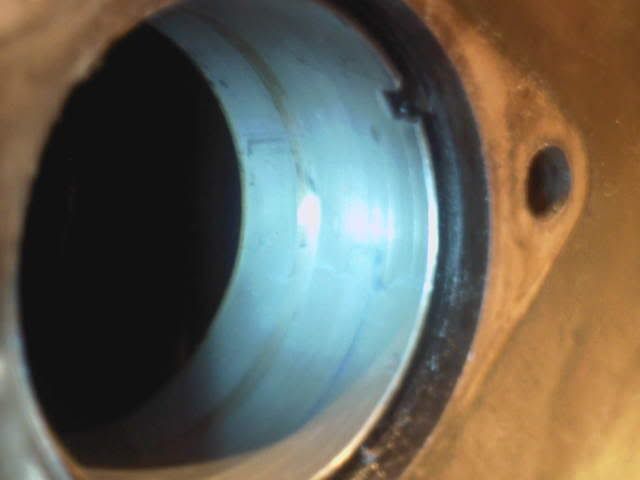

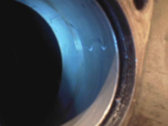

Also since i'm now considering rebuilding this engine. Take a look at the cam bearings. I noticed they look a little scored/worn, does this have an relation to how worn the crank bearings may be and does this ware look significant?

most engineerin firms would relace them bearings with the score marks uless they knew the age of them and then engines history lol

It's really hard to say from a photo. A few dinks won't matter too much, as long as there's nothing protruding above the bearing face. I would agree with Jordie that it's well worthwhile doing the job properly. New crank bearings, oil pump and big end bolts. The super cheapy "beam" torque wrenches with a pointer and scale are, if anything, more accurate and you could always borrow a wrench or chat up a local mechanic.

Cheers, that sounds like a good method. I did have a quick go with the wire brush attachment before but it look liked it scratched the top of the piston so i stopped.
