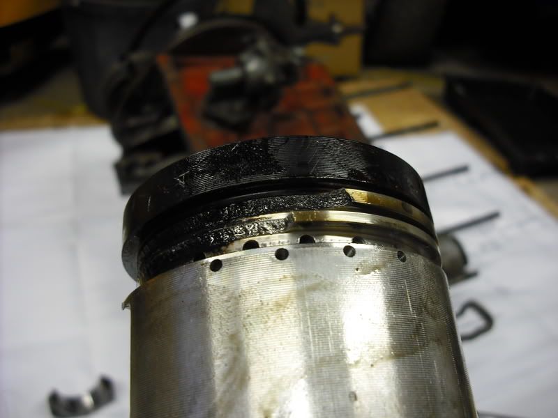

The reason im rebuilding it is that i was running 12:1 and ive managed to damage my pistons but i suspect the octane additive i was using was useless.

But after a couple of hundred miles i found this. Im putting it down to running 12:1 on shitty fuel but i could be all wrong? I also dident really stick to the running in procedure, giving it full throttle a bit which probably dident help :thumbsup:

Odd! What make are they?
Ive only ever run in my engine for 20 mins at 3,000 revs then nail it.
If it was compression I would have thought there would be signs of fatigue or melting on the crown, particularly on the edges.
This looks more like an oil issue to me, crap pistons or maybe the ring was damaged upon assembly

Powermax pistons, i have a new set of them arriving this week. theres no sign of melting at all, pistons are immaculate otherwise and onlt 2 were affected, does that rule out a compression problem so?
Now that you mention it about ring damage, if i remember there was a problem with the ring compressor when it was done, this could be my whole problem?

Posted 01 April 2009 - 01:23 PM
I would think so. Get a new one
