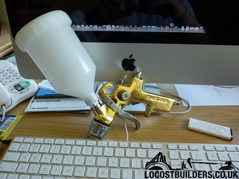

I have been doing a bit of research and the Sealy gold air gun looks ideal for my use. Worth having a look as it is a very well liked gun generally.
Click this link
Edited by andysmini1, 26 May 2009 - 06:14 PM.

Got this in the post today! Woo Hoo!! Can't wait to use it.
Sealey Gold G701G Refinishing Gun £37.95 from Tooled-up.com

Pressure at gun should be about 3 bar, i recently purchased a devilbiss gti copy from ebay and it is every bit as good as the original i use every day.
I only bought it as it was cheaper to buy for the paint cup and service kit but it is just as good ! if i can find the details iwill post them as it was only about £40

I used the sealy gold gun at night school and it was just as good as the devillebliss guns you won't be dissapointed

Thats good to know thanks! I have read that it's a good one and am looking forward to using it.
