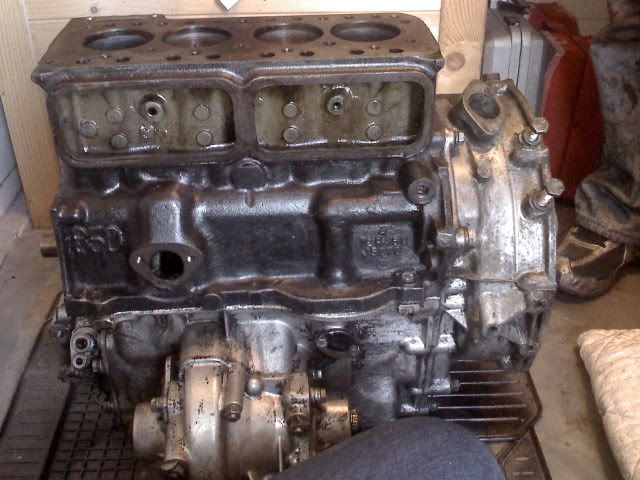

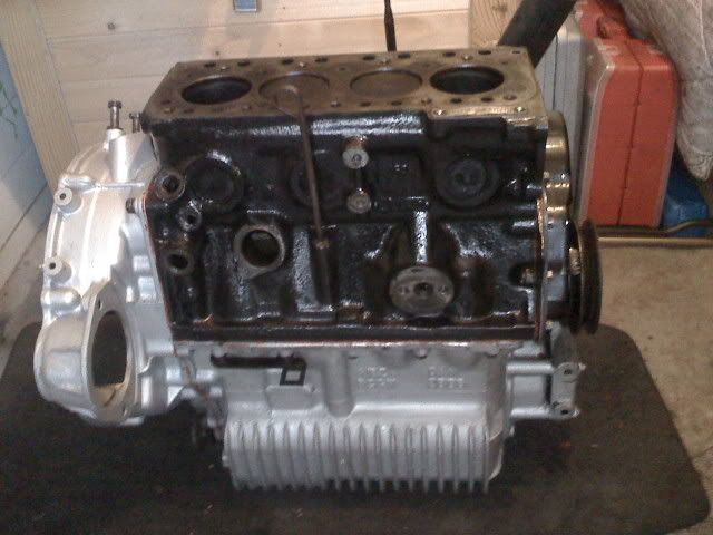

do these pics help to work out what it is
#20
Posted 11 August 2009 - 09:00 PM
A series engine block with an A+ gearbox...
See the three holes in a triangle on the back of the transfer case, this one of the modifications made to the case for A+ and is the mount for the engine steady/mount for the metro.
The gearbox itself is an A+ but will have the 4 bolt main bearing retainer and A series profile gears.... this was also common to the Mk1 metro up until the introduction of the Mk1 Metro Turbo which is where the 3 bolt retainer came into effect.
You could consider the box to have to be a cross over box, as you'll notice it still uses studs on the diff casing and not the flanged bolts common to the later A+ gearboxes.
