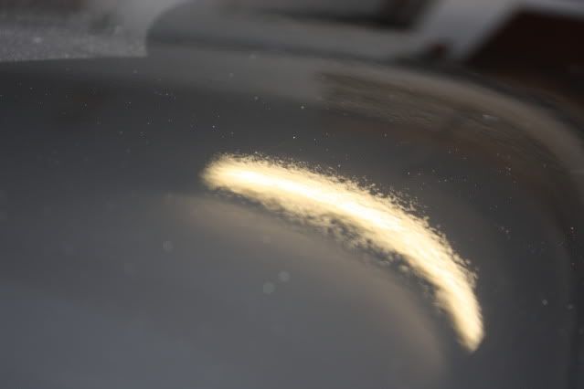

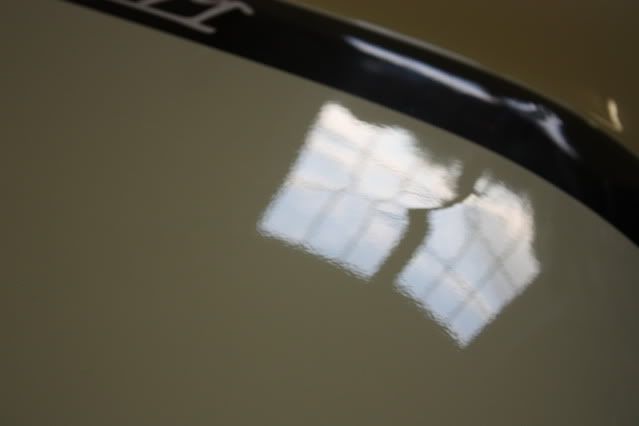

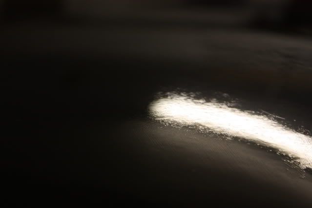

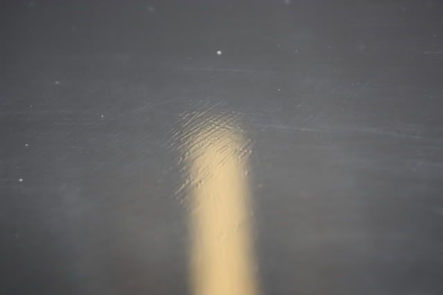

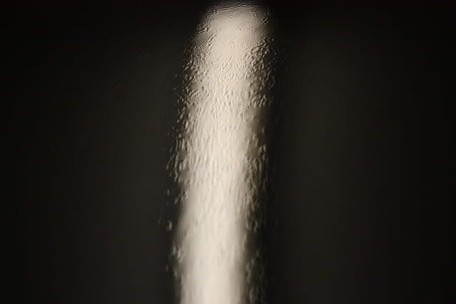

Hey all,
Just wanting a bit of advice as to what this paint defect was called and caused by?
It was fine a week ago, when it was fresh but now it looks almost like leather!
Thanks for advance for your help!
Kit
#2 petwar
petwar
  • 241 posts
Posted 15 September 2009 - 06:41 PM
that looks like a chemical reaction in the paint probable caused by whatever you painted over.
I didnt do it myself was done professionally, I thought chemical reaction but wasnt sure, it seems to be happening under the laquor layer.
Oh and its on the roof
#4 petwar
petwar
  • 241 posts
Posted 15 September 2009 - 06:50 PM
i know what i would do! send the bugger back to the professionals mate! maybe they laqured it before the colour coat had time to dry.
#5 kitroxin
kitroxin
  • 494 posts
  • Local Club: Celtic Minis
Posted 15 September 2009 - 07:01 PM
So its definatley a reaction of the paint?

Posted 15 September 2009 - 07:08 PM
also tell them to sand it properly because you can see all the sanding marks in the paint

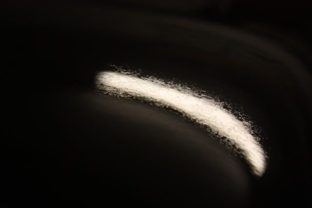

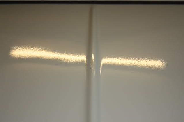

Posted 15 September 2009 - 07:10 PM

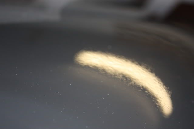

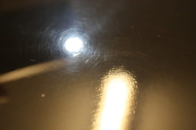

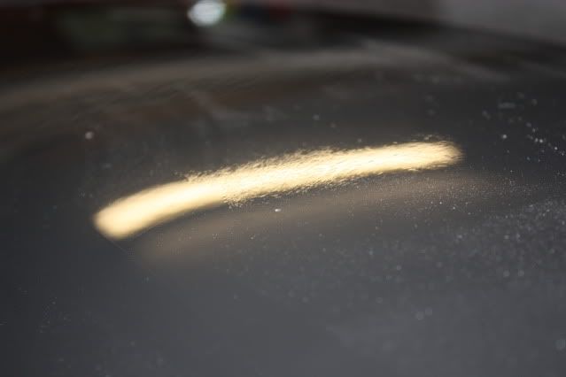

Oh and also what is this called?
This is on the front end in these pictures but the same effect is all over the car.

Posted 15 September 2009 - 07:14 PM
Looks like the 'orange peel' effect & again just in-proper painting techniques.

Posted 15 September 2009 - 07:40 PM
From the pics in the first post looks like they gone mad with sanding down primer (if they sprayed primer...i have doubts)
In the shades i see some reticulation, caused by paint reaction, it happens if you paint over the old coats without isolatating it properly, or if the surface wasnt degreased before applying the top coats.
Usually happens with rattle cans painting without applying bar coat before.
Contact the garage, asking to sort it out.

Posted 15 September 2009 - 08:12 PM
Sinkage. Caused by using a too coarse grit to abrade the surface underneath, and using no or very little primer, or priming, and prepping with paper too coarse. With most spray jobs you will get orange peel, it should be polished out if it's that bad, although saying that, I've seen worse on cars from the factory. No bodyshop should be able to get away with putting a car out looking like that, you should definitely bring it back and give them a chance to rectify it, if they don't, then demand a refund. If they don't do that, then threaten legal action, usually does the job :)
