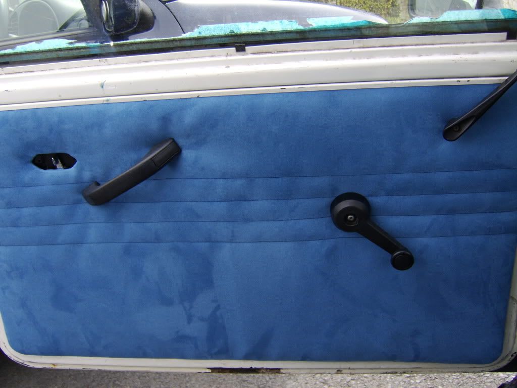

They look really good :D Thought I'd show a picture of my ones as well, I used the original door card put some wadding onto it and covered it in like a suede material which I sewed some stripes into so it broke up the colour a bit:
(Not the best pic in the world but you get the jist!)

Brams they're really good, nice one :(
And thats what I was about to do with mine edgrrr, but decided I've got so much of that sort of thing to do I just ordered the retro retrims ones instead :D they're a lot better than I could have done!!
