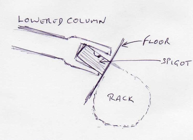

In an effort to explain the problem I've done this quick sketch:
It's very basic and a bit exagerated but I think shows what is meant by missalignment.
When a drop braket is fitted the 2 U bolt clamps must be slackened and the rack must be rotated in them so that the spigot is at the same angle as the new position of the column.
Edited by MINY, 06 November 2009 - 02:00 PM.
#8 cooperdan
cooperdan
  • 3,729 posts
  • Local Club: N/A
Posted 06 November 2009 - 09:47 AM
Good diagram

Joe, as you will be striping the column down I would strongly suggest that you replace the top and bottom bushes whilst you're at it, they're not expencive also you should use a new pinch bolt and nut.

really appreciate your help man, you dont realise how much the picture helped.. haha, I bough the drop bracket from minispares, I followed the instructions from miniworld, I remember un doing the bolts massanger side & driver side, I dont remember doing anything with the rack, Im working 10 x 5 " wheels, but on 7.5 cooper S, not spacers, Thanks again for your help mate, much appreciated. Just had to cancle my order with minisport, it was cheaper there, so I think I would give them a chance & making a good sale ( first time order because ive hurd there down falls ) email this morning - * this item is currently out of stock * lol, so order cancled, see what happens.
