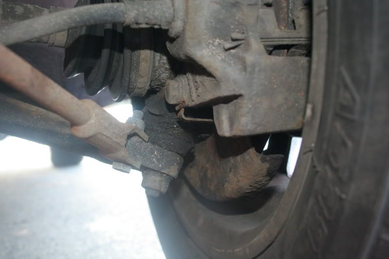

I bumped the kerb head on at about 5mph earlier today. Now its pulling hard to the left, have to keep the wheel at about 3 o clock to the right to go straight.
Too dark to check much but checked the tie rods and they seem fine, they are also 2 months old.
Anything else to check? I did a search but results are all for people who are slightly pulling either side, mines pulling very bad indeed.

Another common cause of pulling to one side after a frontal impact on the wheel is a bent tie-bar 'ear' on the sub-frame.
If this is the case, and you'll need to measure the sub-frame accurately frm tie-bar front mounting to the rear of the sub-frame, then you have to remove the tie-bar, heat up the 'ear' with a blow torch, bend it straight (big club hammer does the trick!) and make sure it's as accurate as you can get it, re-paint locally and re-fit the tie-bar.
The best thing to do then is to fit adjustable length tie-bars to takje out any residual inaccuracy.
However, check the steering arm and tie-bar first.

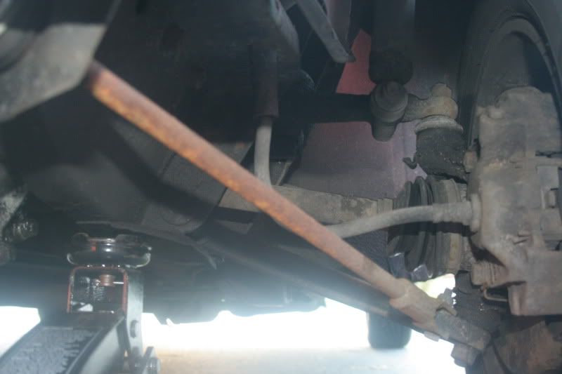

#15 MonkeyHugger
MonkeyHugger
  • 174 posts
Posted 01 January 2010 - 03:38 PM
Holy late reply!
Thanks for all the ideas :P I took some pictures but dont think theyll be any help, tie bar seems fine, the wheel doesnt feel loose if i give it a good shake. The only thing I noticed is that guard behind the brake disc is loose.
