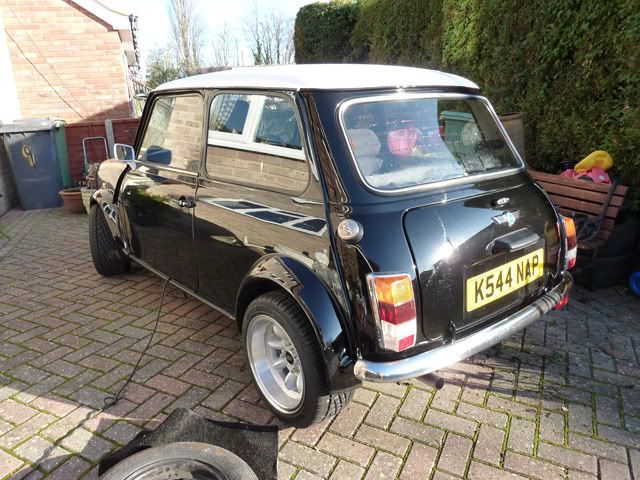

Its taken me ages to find a mini that just seemed to make me think thats the one..
It got its name from a previous owner who spotted me putting pictures up on here..
I collected yesterday, had no problems driving it home, which must be a good start with some of the threads you read on here..
The body and paint are as close to perfect as it can be, the interior could do with a freshen up along with the engine bay, both are practically fine, just not shiny and fresh enough for me..

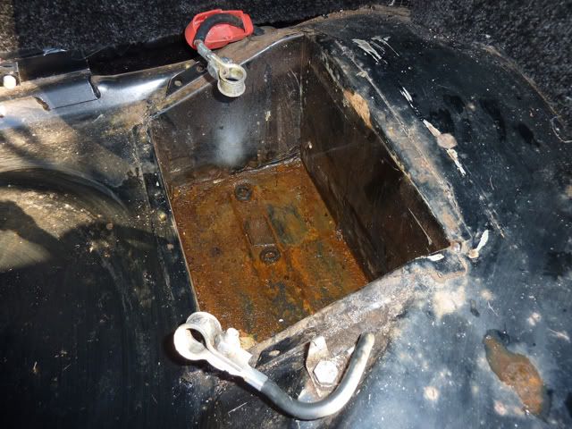

Needs a wire brush and a paint, the battery tray is solid but has a good layer of surface rust..
This is first on my list, along with a new heater matrix..

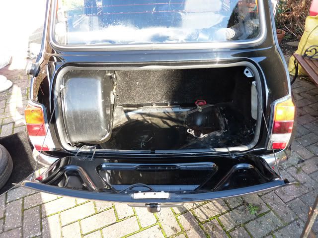

I have a question. What's that thing in the top right had corner of the boot. I just went out to look at my car and I don't have one of those.

Simon tells me that it was originally a SPI and its been converted to carb, my guess is.. it looks like a position for a switch?

I see. I hope you don't get too many problems MOTing it then. I'll have a look at Lees mini next time I see him and see if he was one of those in his boot.

Its the switch holder for the boot courtesy light.
Doesnt apear to have a switch isntall though.
All Minis after a certain year had it, but not all had the light. :)

yer its deffo a spi converted to carb, good move in my opinion. the paint is absolutely brilliant on it, completely flat with hardly a mark on it.

The bracket in the top right hand corner is for the factory fit Rover Mems alarm :)
Most of the 1275,s had the bracket but they only started putting the alarms on cars from aroun N plate Onwards ie/ SPI cars though ive seen ealy N plates with an immobilser but no Alarm :)
Ive also seen much earlier Coopers with Both :)
I think because the Cooper had Throttle Body Injection earlier than the Sprites,Mayfairs etc they altered the tooling so the shells were ready for the aditions needed for injection :)
On Cars with Rover Mems that bracket has a switch in it and if you open the boot without disabling the alarm the alarm will sound ;)

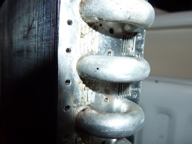

Well its been cold over the last few days and its started getting to the point where inside my windows was freezing up before the outside.. :D
This was due to the heater not working! :)
I knew it wasnt working when i bought the car but have only just had time to look at it.. It would have *drunk* out water on the drive home the but we bypassed the heater matrix from the loop so the leak wasnt a problem..
The tiny black dot is the hole, im suprised at the amount of water that came out of here..
I'm going to try and block it up with some plumbing putty or something and if that doesnt work it looks like i'll be buying a new one..

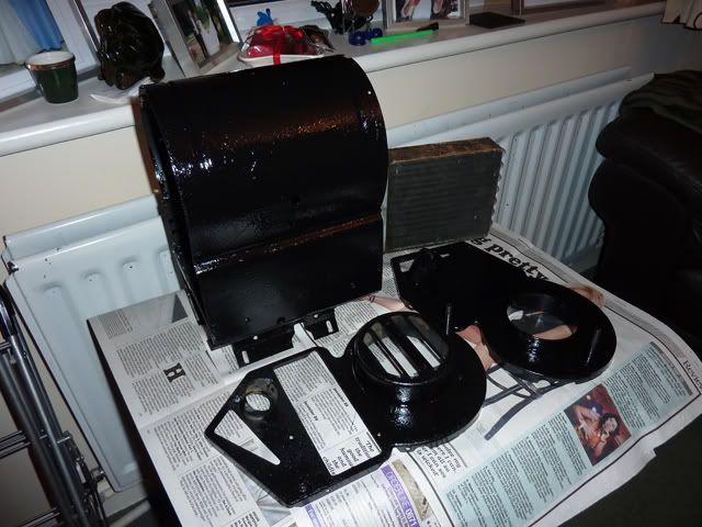

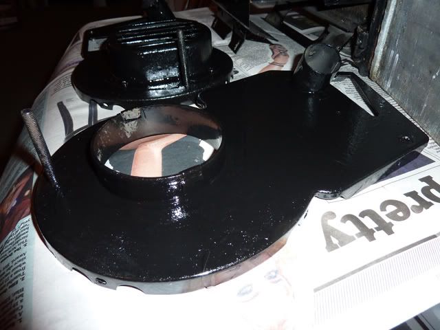

And i though whilst it was out i'd give it a little paint, even though its hardly seen due to the centre console..
There's a few hairs from the paint brush etc.. but i doubt i'll bother sanding them out probably just paint over it again as its not like its an easily seen part..
