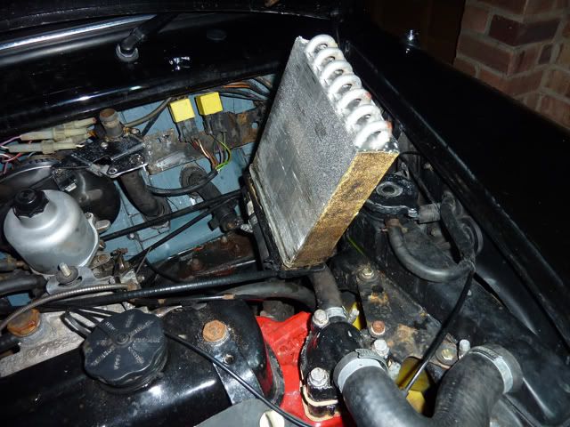

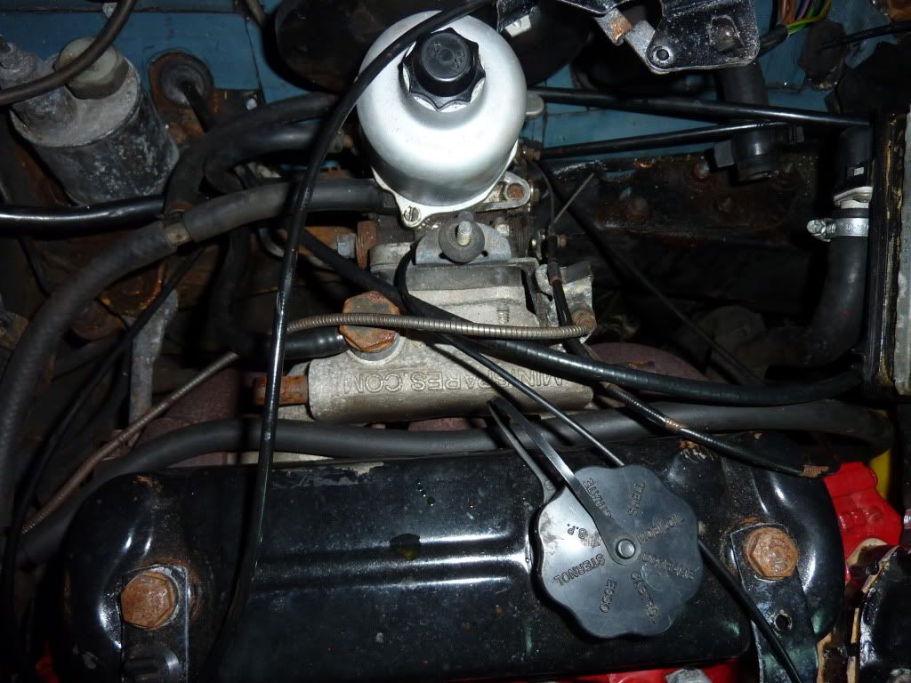

Well, fixed the heater today, I know have a warm car!
Mashed my finger a bit by trying to find where a blow of air was coming from, what a suprise, maybe the fan?! (Yeah blonde moment..)
Note to self. Don't go poking about engine bays with bare fingers >_<
Testint the fixed heater matrix.. :(

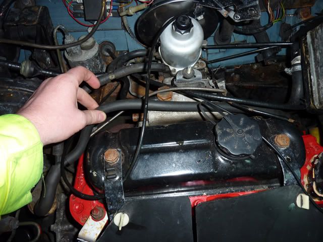

Also, i want to run a pip through the inlet manifold, as been as its there and its rather cold at the moment it can't do any harm helping the carb warm up a bit!
But what pipe do i use?!
This one..
That goes too..
Anyone?

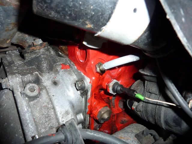

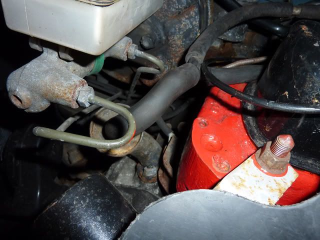

Also i think i have an oil leak coming from..
Common, not so common? Just a case of tightening the nut up a bit?
And a couple of general photos..

the pipe you have in your hand doesnt hold water and isnt part of the cooling system if it goes to where you say
ill have a look at mine if i get chance and show you where the heated inlet manifold is plumber in from, as i have it fitted

Both my mini`s are from a similar time bot are 93 and 94 both are carb models not spi`s,there are relays fitted to the bracket on the bulkhead.Also the washer bottle is in the boot when theres no real need.
As for the electric fan on the inner wing, the radiator should have a switch on the bottom front corner,its just behind the grill with two wires running from it.These go to the fan.
Your oil leak,i wouldn`t try tightening it to much as the pipe which goes into the bolt only has a rubber olive type seal on it which is probably knackered,the best option may be to get a braid oil pipe whick goes from the block to the oil filter housing.
Hope this helps.

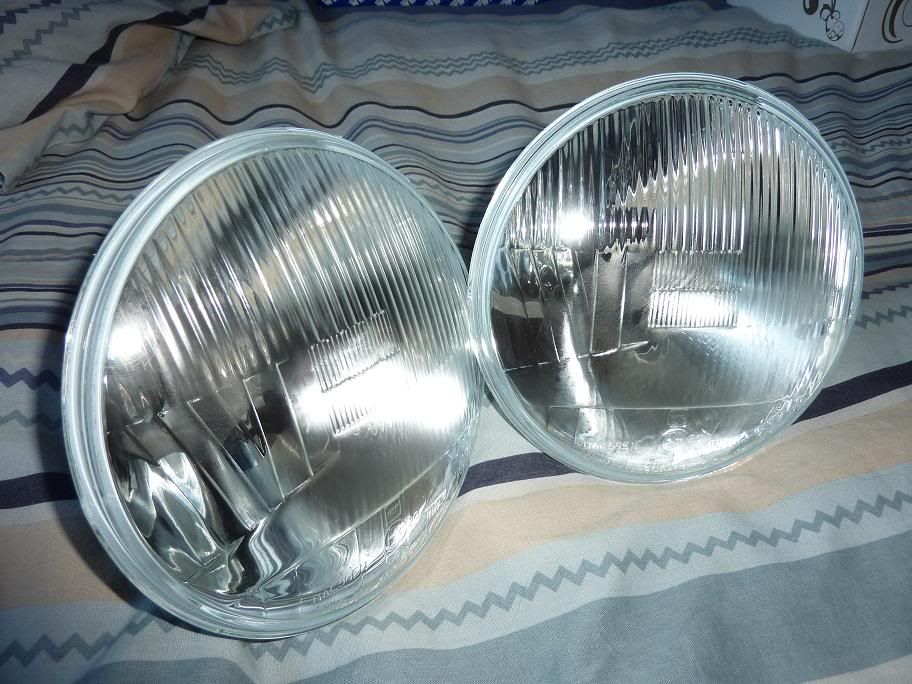

Posted 30 January 2010 - 11:27 AM

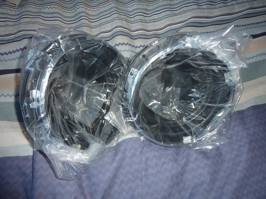

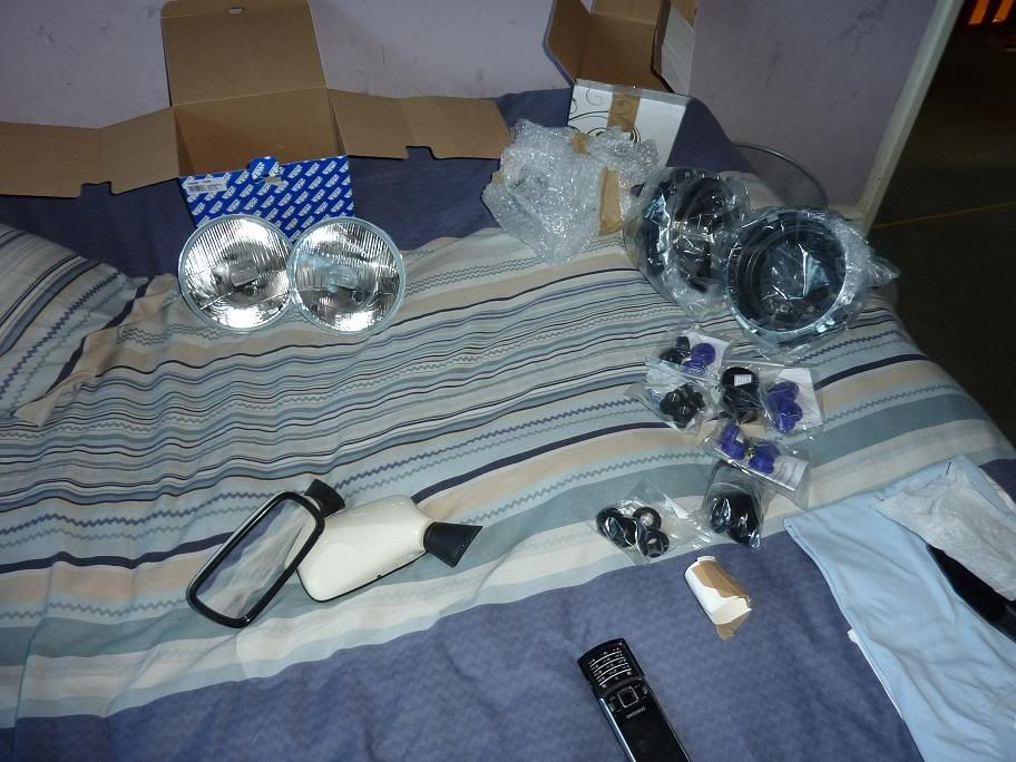

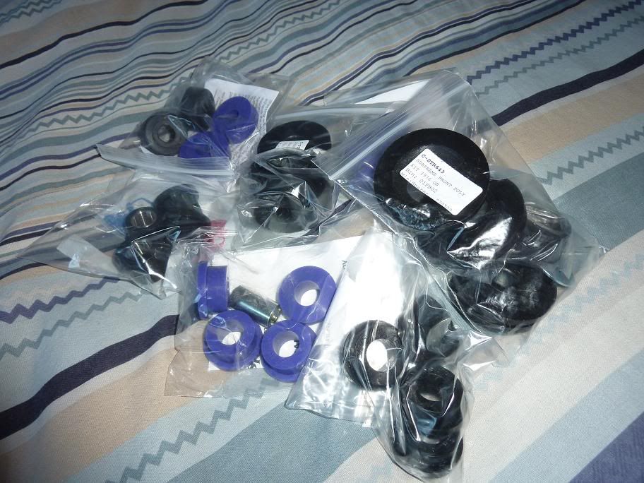

Ventured out to mini spares yesterday bought leeroy some belated christmas presents..
Wipacs.
New Bowls.
Poly Bushes.
The guy in the mini spares shop kindly explained where each set went, I'm not going lie, I listened then didn't really have much of an idea other than the subframe mounts.. I just asked for a set for the complete car..

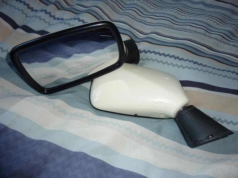

Then a few other bits i've acquired.. Not sure if this is for this car or the other one, except the mirrors..
Proper mirrors rather than painted ones.

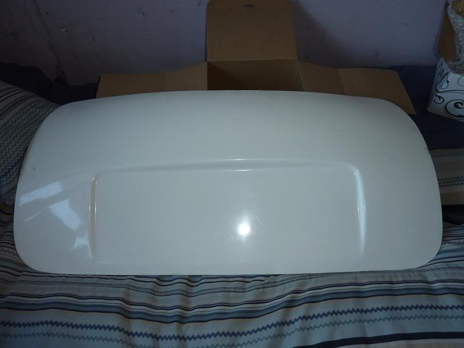

Fibreglass boot panel.
I was so suprised how little it weighed..

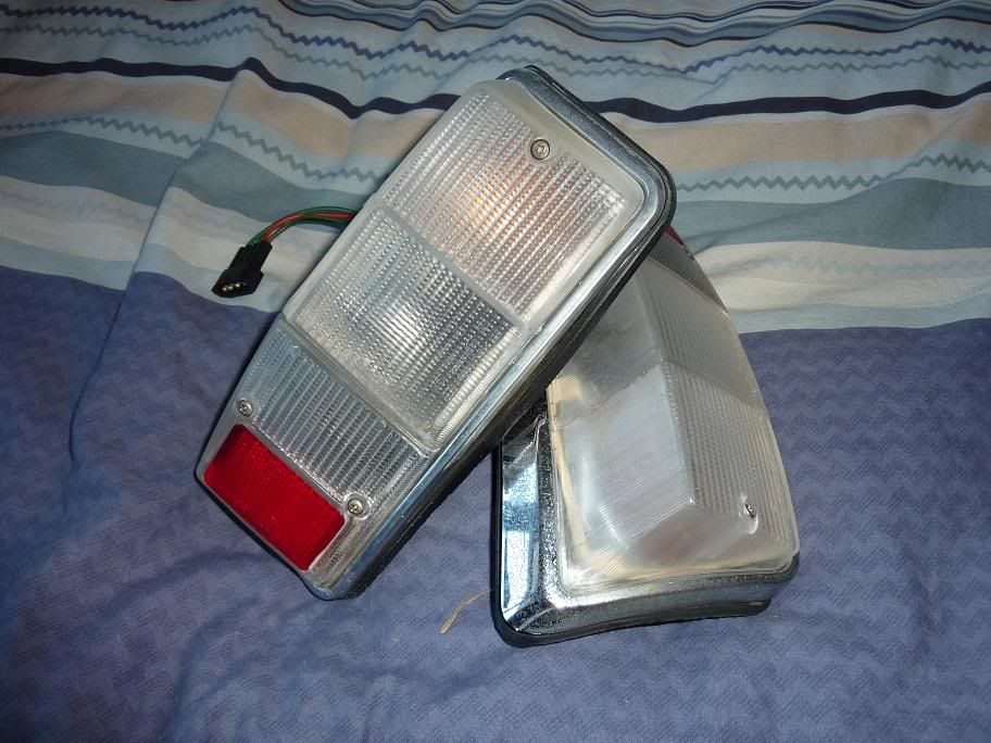

Clear rear Lenses.
Also about to have a bash at fitting my centre exit RC40 and Maniflow manfold from the project car's pile of bits as its not going to get done anywhen soon..
Oh, and i'm going to chuck these on for good measure..

You need to run the pipes that go to the heater matrix through the inlet manifold, they are the only ones that are the right size and hold water, bit of fancy pipe routing on your car me thinks. :-
