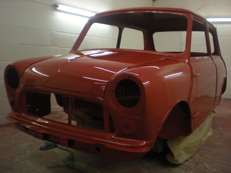

5. With cellulose you should apply around 4 to 5 coats mixed at a ratio of 50:50 with the thinners, no need to rub down between coats at all, unless you have any major particles or bits of sh*t, runs etc. Before the final coat, and making sure the paint is dry enough to flat, rub it down with 800 wet and dry, removing any imperfections. For the final coat, mix the paint at a 60:40 ratio, the 60 being the thinners, this helps the paint flow out, and gives a shiner final finish.
6. This is a mini I painted recently in cellulose, using the above techniques, and without a booth.

What pete has said is spot on, especially about the celly, mix it 60:40 for the final coat to get the shine, otherwise it will dry dull and will take longer to flat and polish.
