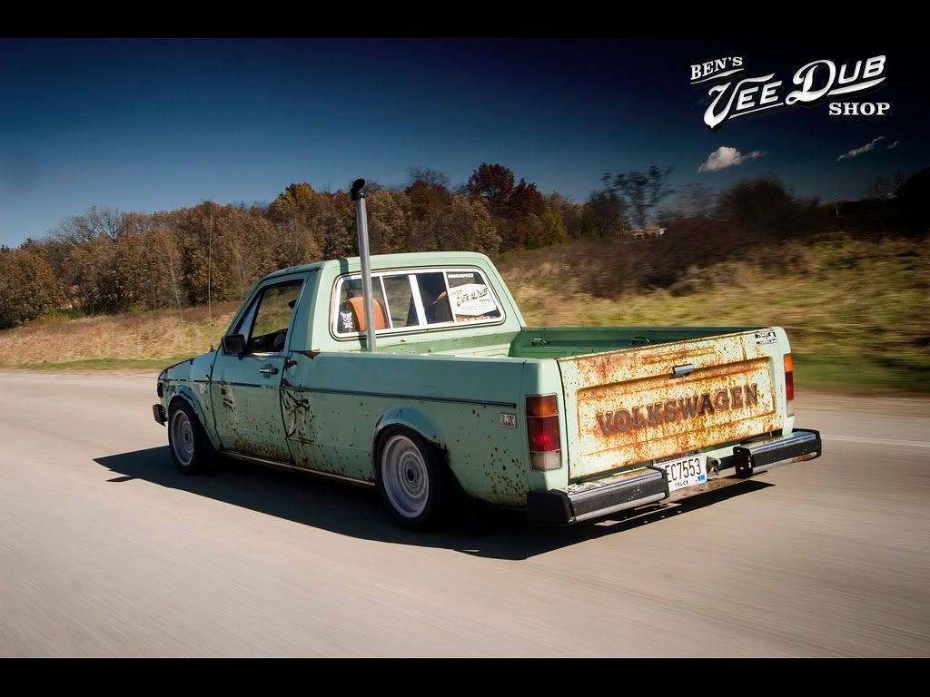

Before i start this isnt for a Mini so put your bibles down :D!
Heres how it is.
Van is currently white.
I want it a light blue/green.
But i also want a tatty rat look paint job.
If possible can i paint it with rattle cans or anything to keep the costs down?
Heres a couple pictures of what i want to achieve (Minus the stupid pipe):
And i kinda get how to do the rusting thing but what lacqor do i use to seal it on? I'm preferably looking for a brush on stuff if they do it.
Also how do i get the "spekled" rust effect. Do i just rub down little tiny marks i suppose?
And lastly how can i dent the body like it is behind the passenger door?
Thanks :)

Thats what i was thinking but how would i get that crease bit? Would a short piece of wood held up to the body and hit work?

for the dent hot it with a hammer alot to dent it all in then just try to knock it back out thats how you get the creases

paint it with rustolum and a roller, flat it back but dont polish it (only go upto 1000grit). then wash it with fairy liquid and leave it out in the sun allot :tumble:
Thanks Burnard :)
When you say flat it back, i take it you mean sand it?

yer, with wet and dry paper.
should give you that, worn, ratty, uncared for look.
They are generally all things which shouldnt be done to paint work :tumble: so id hope they would give the right effect.
As for the rust dots just chip bits off, throw stones at it etc.
