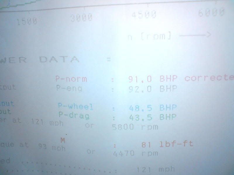

Anyway, a bit about my car and the supposed problem. I bought a completely standard 97 Rover Mpi and have gradually added a Stage 3 tuning kit from Minisport, with a few parts a bit better than their standard lot, also fitted the car with a 52mm throttle body. It went back there to go on the rolling road and came back with 91bhp at the fly (the tester said he could have squeezed a bit more out of it although it would have been a bit fussy around 2k revs), overall he was very happy with the engine. What surprised me though was the loss from the engine to the wheels, which were reading out at 48.5bhp. I thought this to be quite a large loss, as the percentages I've heard thrown around for the loss being quite a bit less than this. Since then I have heard a few people say it does happen sometimes, so yeah... Now I'm not going to get into the number chasing game or anything, but I was wondering what stage of tuning I could go to to try and reduce this a little, and if it actually is worth trying to do so. I also don't want to throw a lot of money into new gearboxes etc if I'm not going to notice much difference. So if anyone has gone down the same route, I would really appreciate some feedback on what they did and ultimately their results. Thanks in advance! :bah:

Argh, why do people not believe me? Sorry about the bad quality but took this on my phone. It's 91 at the fly, 48.5 at the wheels.

How is it even possible to measure transmission losses without removing the engine from the car? Surely you would have to run the engine on a test stand and then compare that to the figures from a rolling road after install to see the true losses?
My understanding was that the flywheel figures that you see on these printouts are calculated back from the roadwheels by basically assuming what the transmission losses will be...

Transmission losses are calculated on the run down of the rollers.

Ah thanks, that makes sense. It's more than just transmission losses that you're measuring in that case though isn't it? You'll also be getting all the drag from the engine. It still doesn't feel like a good assumption to say that this figure means that your transmission losses are excessive. I can see why the figure might be high though. Compared to modern cars a mini with an A series generates a ferocious ammount of engine braking.

You shouldnt really listen to the flywheel figures, the rolling road can only accuratly measure the reading at the wheels (even this can and does change from one RR to another), any other measurement is just a calculation and therefore inaccurate. To get a true flywheel figure you need to have the engine setup on an engine dyno machine out of the car.
A RR is only really a tuning tool, and the so called power runs are just a gimmick really to make some money, understandable with the cost of these things! You should think of a rolling road as just a good tuning device and ignore the final power out put but concentrate on the power gains and engine running improvements made from the first run to the last run.
