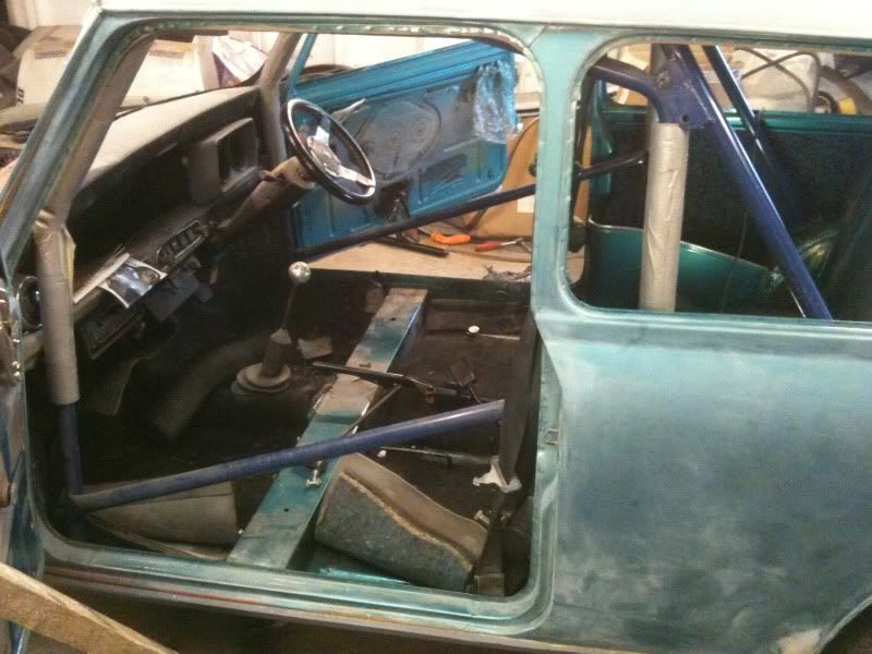

The roll cage trial fitted and etch primed now,exscuse the jumps in stages as it has been ongoing for about a month now

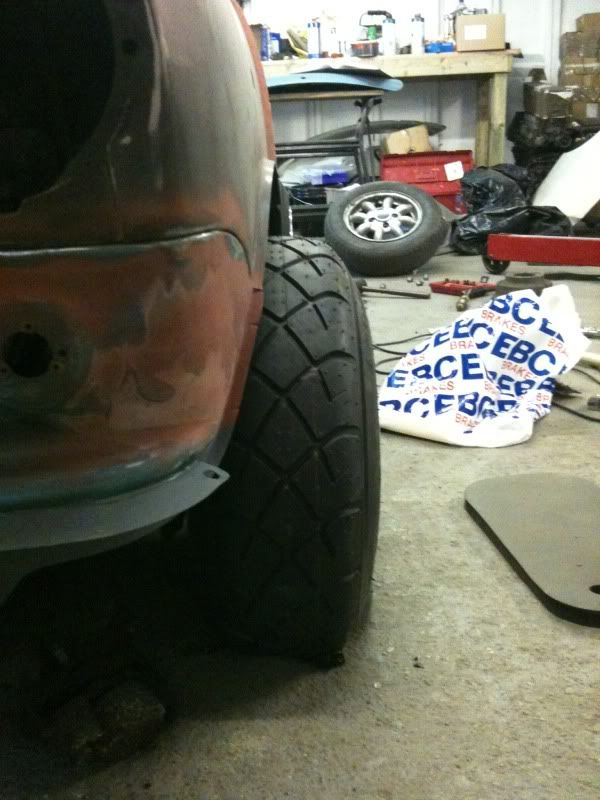

Wheels trial fitted,Carl Force 7.25" split rims,10" obviously
They are gorgeous and Carl is a good guy to deal with,i also have gold anodised Kad calipers with Pagid black grooved discs which look sexy,also Adjusta rides,neg camber arms,adj tie rods etc,the car is already Koni equipped.

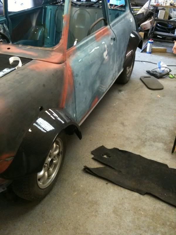

Ok a bit more progress recently,i have trimmed and played with the arches for ages to be happy with the look and fit and now finally trial fitted
Obviously they will look better with a proper set of wheels tucked underneath lol

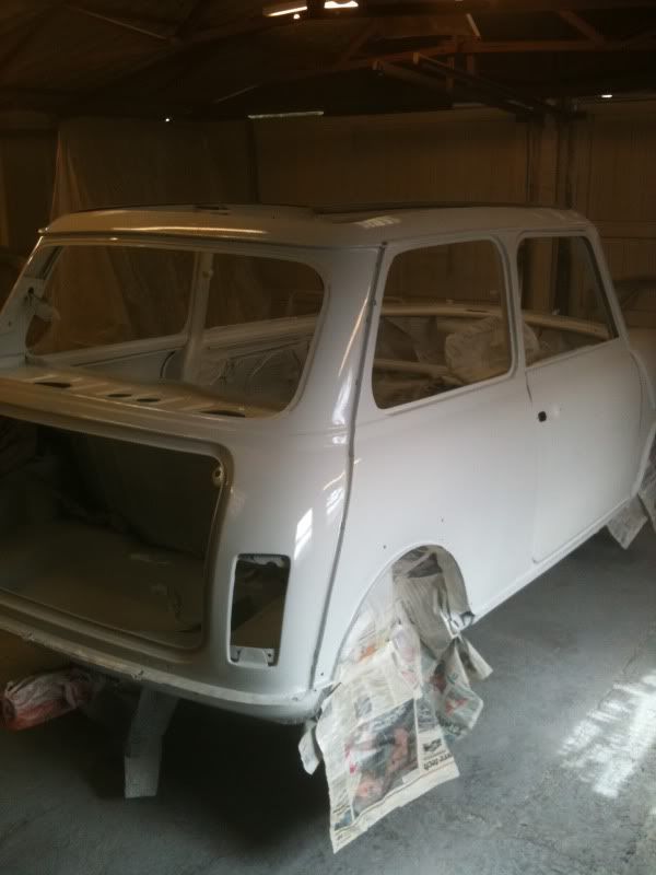

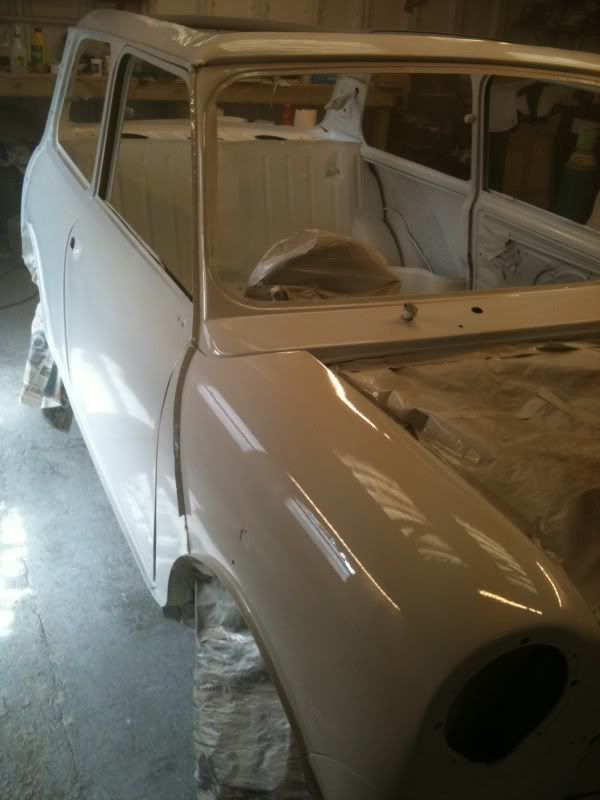

Well today was the day for the top coat,apologies once again for the poor Iphone pictures,i gave it a dust coat initially followed by 3 coats building up the colour on each one,i started the final prep last night by taping up the workshop doors and hoovering as much as possible,i then panel wiped the whole body.This morning i started early as i didn't want to be cooking in my overalls,a quick wipe with a tack cloth and i then dampened the floor to minimise any dust clouds.
Cranked up the compressor,donned my protective straw hat and cracked on,a couple of hours later the point of no return was well passed and it's finished.
I have mangaged to stop myself from going back up there this evening to check the finish,as i don't want to upset myself today if there is a problem,however tromorrow morning before work i will pop in and check it over properly.
Hopefully the next installment will be the spraying of the rest of the roll cage and seam strips,then all the assembly can then slowly start.
Yea i know another white mini :)

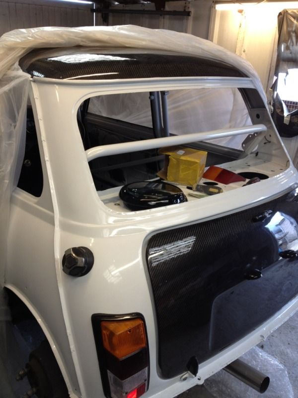

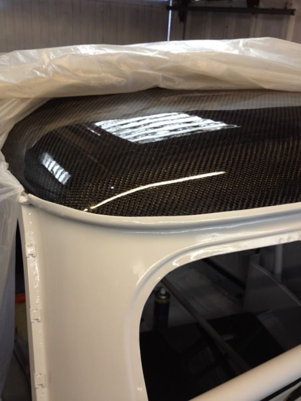

Posted 27 October 2012 - 01:39 PM

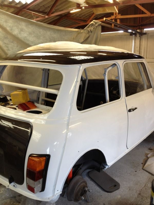

A few more updates as its been a while and just started again lol,carbon roof fitted loosely
#14 Thorpey69
Thorpey69
  • 53 posts
Posted 27 October 2012 - 01:41 PM
Carbon boot lid also fitted along with twin LED number plate lights
Carbon dash along with 3 dial clock set,i recovered the top and bottom dash rail in faux grey suede which looks quite nice..

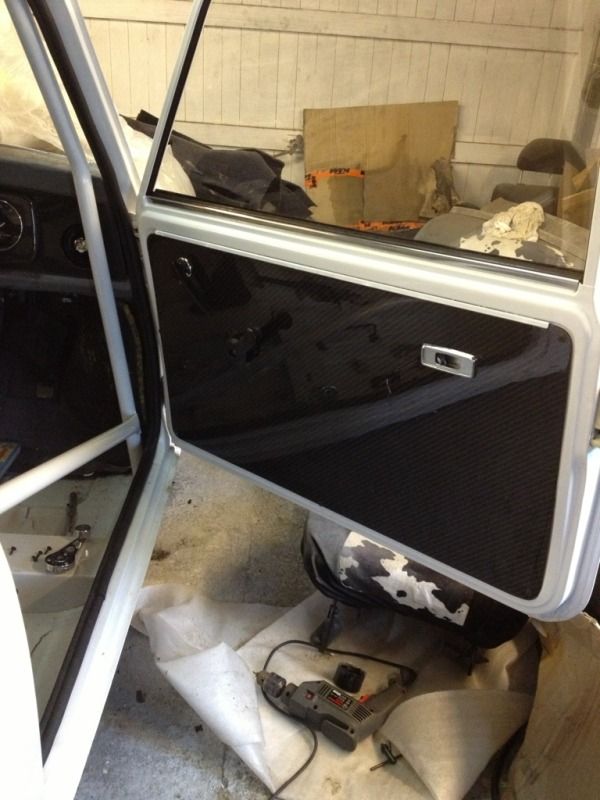

Carbon door cards fitted this week also..
