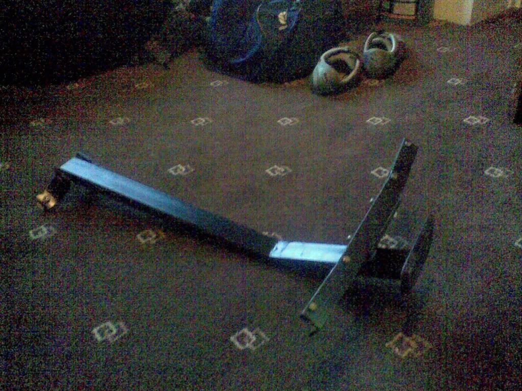

Well, im guna put my towbar on this weekend, here is a picture
Just wondering, how does it fit on?, i have offered it up, and it looks like it bolts onto the lip under the rear bumper, is this right, can it take the extra weight??

Yes - and I strongly advise using a good spreader plate in the spare wheel well - inside and outside! And obviously - the rear bumper mounting lip must be in tip top condition too. There is absolutely no point bolting it on to rust!
