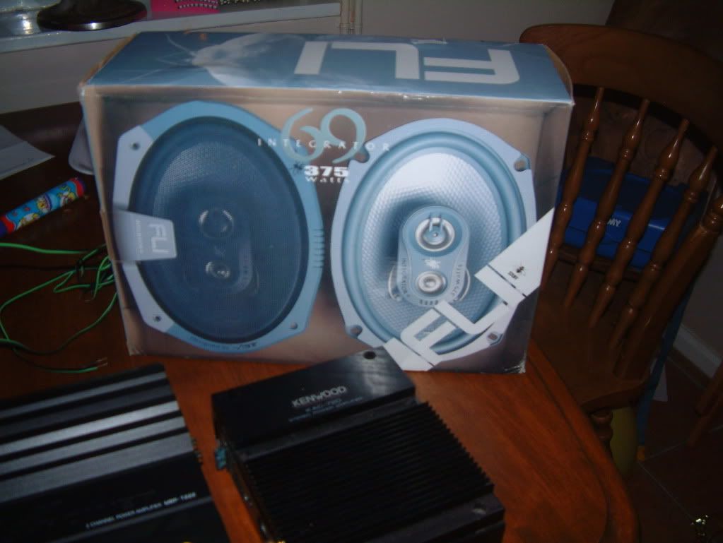

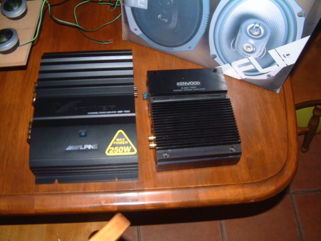

HU Sony 4x45 USB Mp3 Cd jobbie
This amp the one on the left!
Powering these 6x9s
These are under the rear seat
And the Hu is powering (directly off the speaker ports in the HU) The fusion ones on the right x2
These are in pods on the flitch panel
And a set of dual cone alpine, 4" component speakers with tweeters built in. In the dash where the vents used to be.
