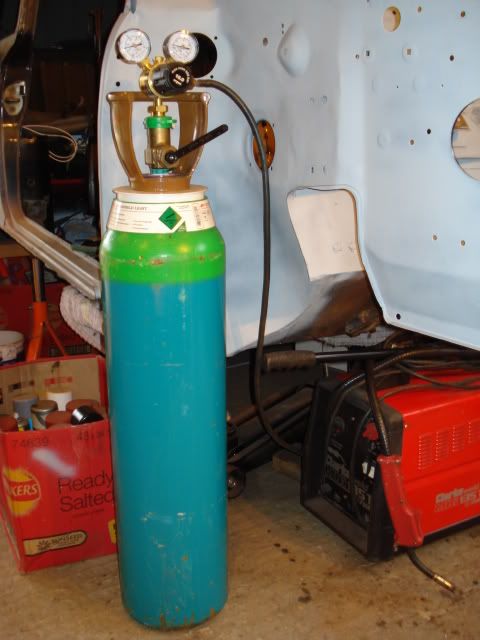

If you want to go gas then try B.O.C and go for the small Argoshield gas bottles. Its contract based and very flexible. You take out a years contract and either pay monthly or all up front. If you finish with the bottle and have complete months of the contract left then if you have paid all up front they will refund you for the complete months remaining or if you pay monthly then you can cancel the contract with no penalties.
I bought the larger bottle and a new regulator (different types for different gases) and it came to approx £180 (that also included a 5kg reel of 0.6mm mig wire.) Expensive i hear you say but i am doing a lot of welding so its fine for my requirements, as i said previously they do smaller sizes that are a lot cheaper along with the refills.
Try the website or give them a call, they were very helpful.
