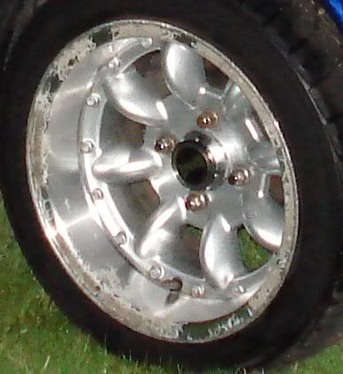

Thought I'd share my progress on here aswell. Dont have a brilliant before picture, but I do have one from last years IMM, and they looked as good as they could here because they're been scrubbed! So normally a lot worse, and since then over the winter they have gotten even worse, this was the worst wheel on the car, and one of the most badly corroded I've ever seen ;)

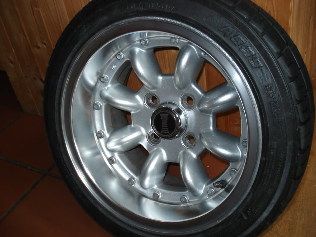

And heres the same wheel today after about an hour with the first two steps, nitro-mors and 600 grade wet and dry:
I'm surprised to be honest, never thought they'd look that good again. And thats before any polishing or waxing! I've bought that polishing kit mentioned above and some rim wax for when they're all done, I'm gonna hunt now for the fake bolts that go around the rim :blink:
