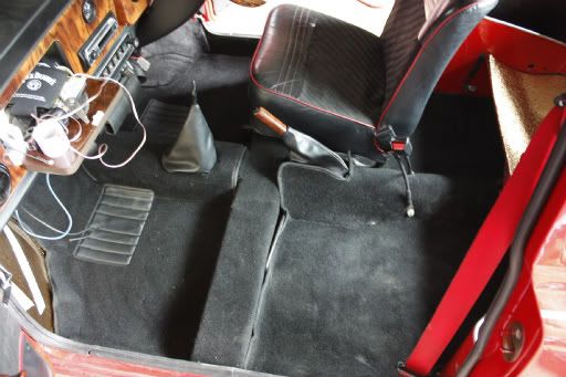

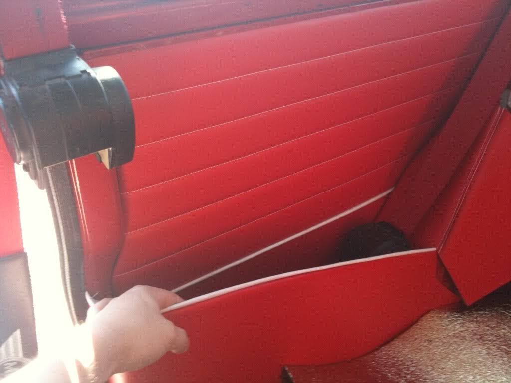

I've now got round to fitting them - but I broke my camera lens so they're off the phone I'm afraid!
So I took Lulu up to the garage....not big enough.......
And I ripped out the old seats and door cards (for sale - PM me!) and cleaned the carpets!

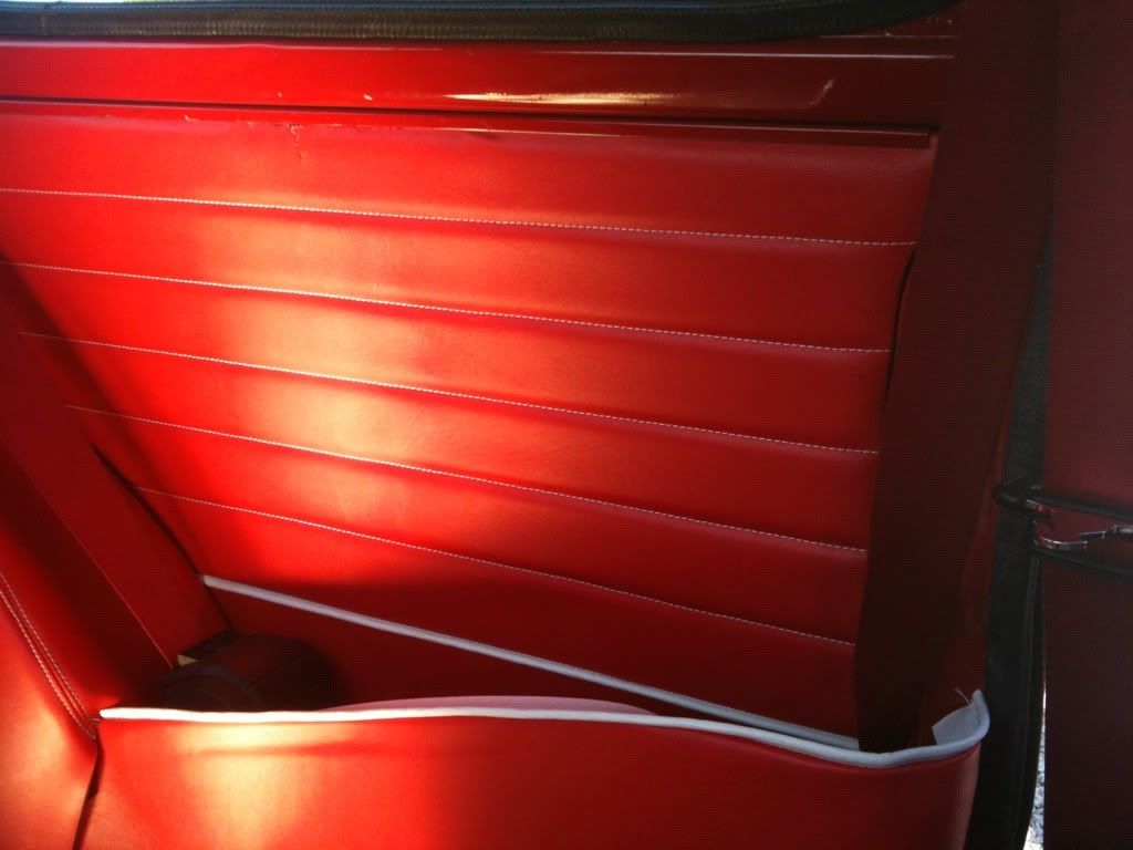

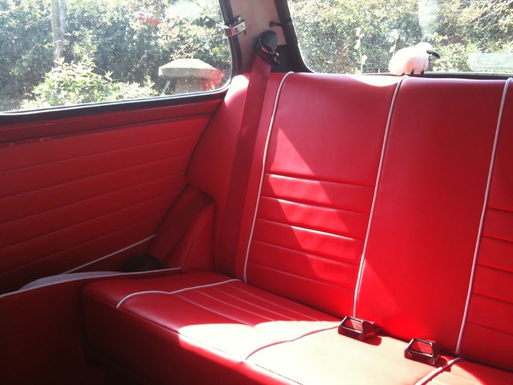

I also got bin bottoms, arch covers and bin surrounds, but because the seatbelt reels were in the way - I had to slightly modify them.....
And fitted the rears, rear door cards, bin bottoms, arch covers and bin covers.....
What do you think?????? I'll get some better pictures soon.
Hope you likey!!

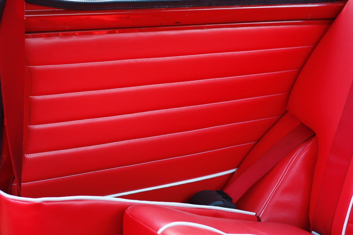

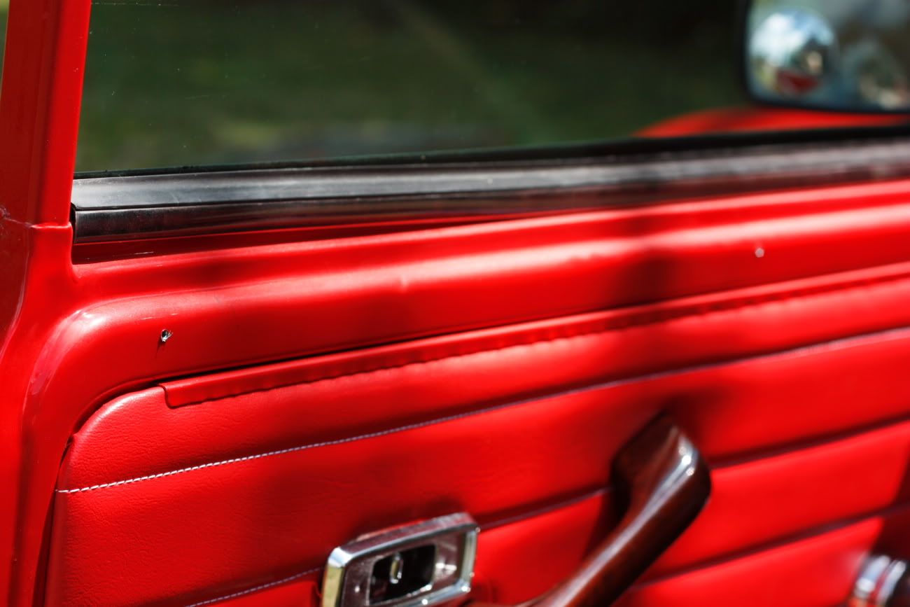

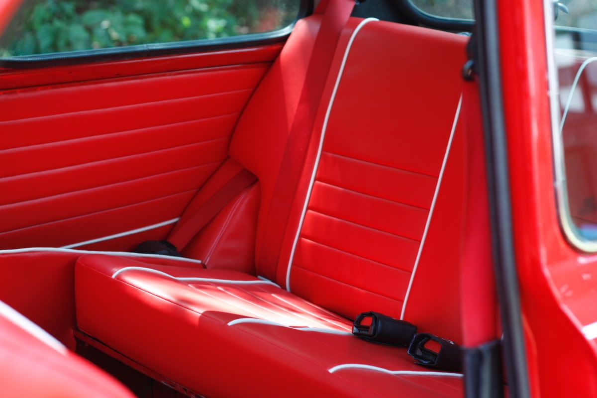

Right, got some better pictures!
Rears:
Rear bin surrounds
Door cards
:P :) :o :P

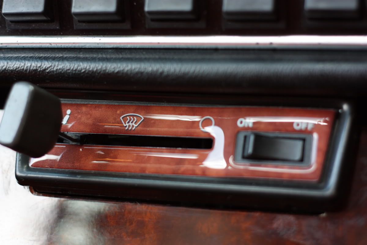

I also nipped down to the Sticky Fingers HQ to collect as couple of bits:
Old one:
New one:
I bought a set of walnut door cappings in the MiniSpares Vat free week last year. I've just pre-drilled the holes for them:

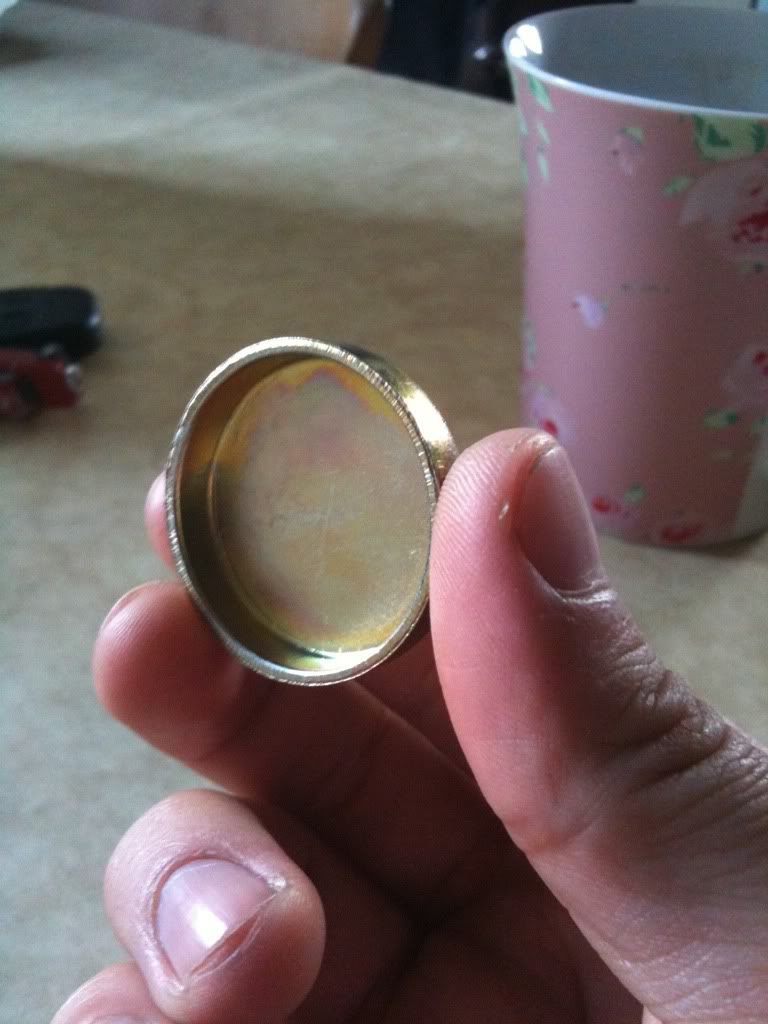

Changed the core plugs, one took a few times to seal properly. But (touch-wood), they seem to have sealed up nicely!

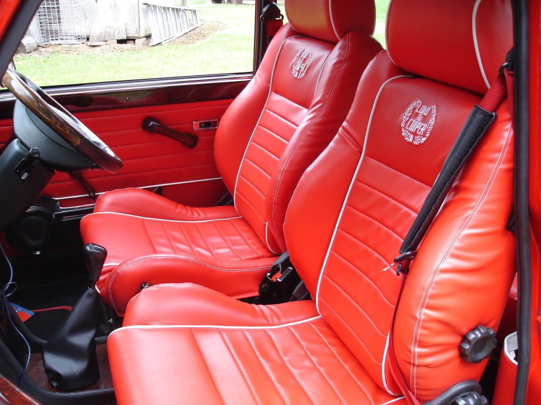

I've got my gawgeous front seats fitted too!

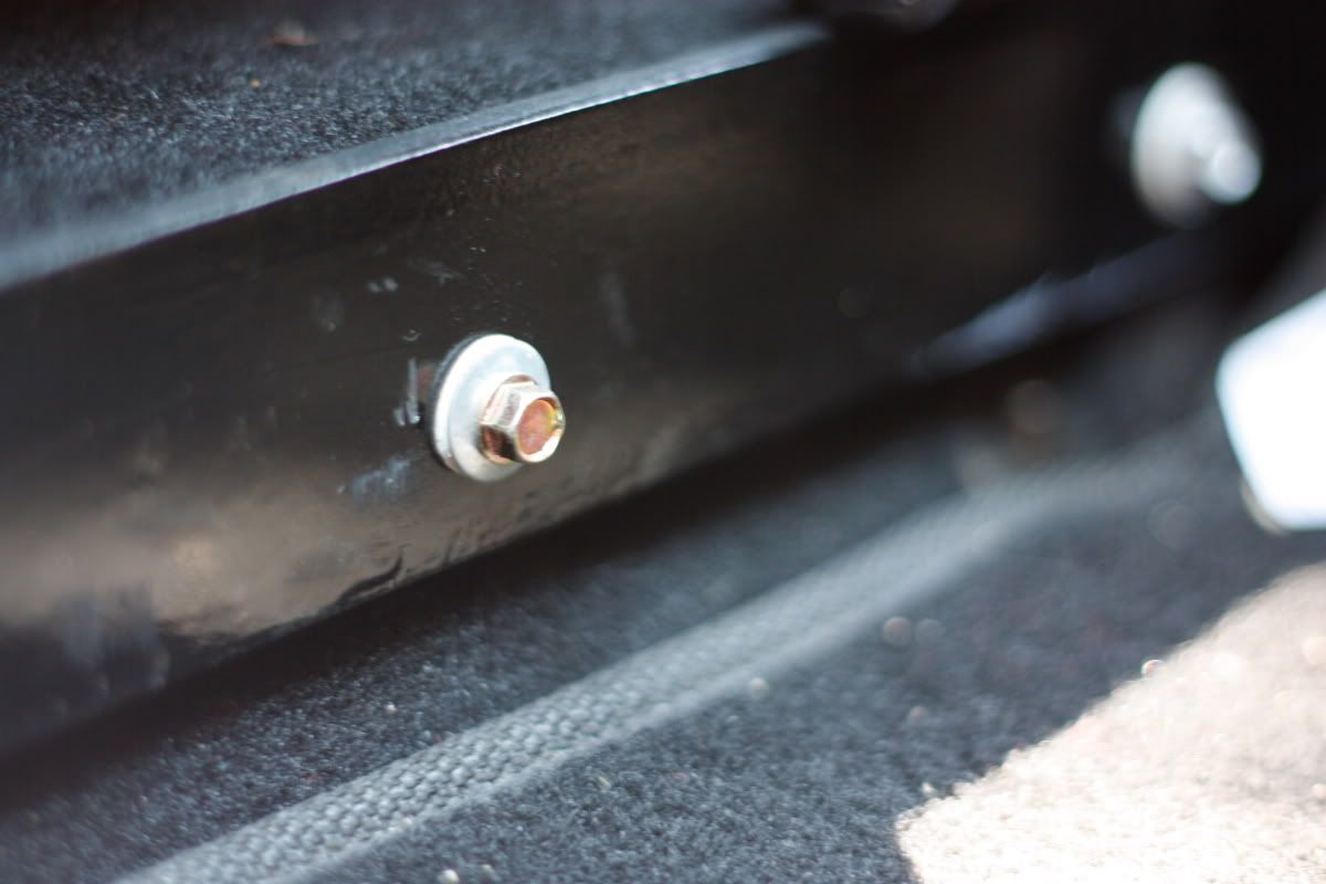

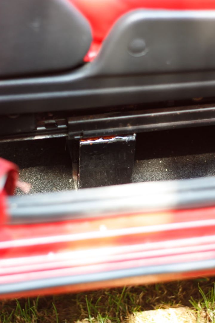

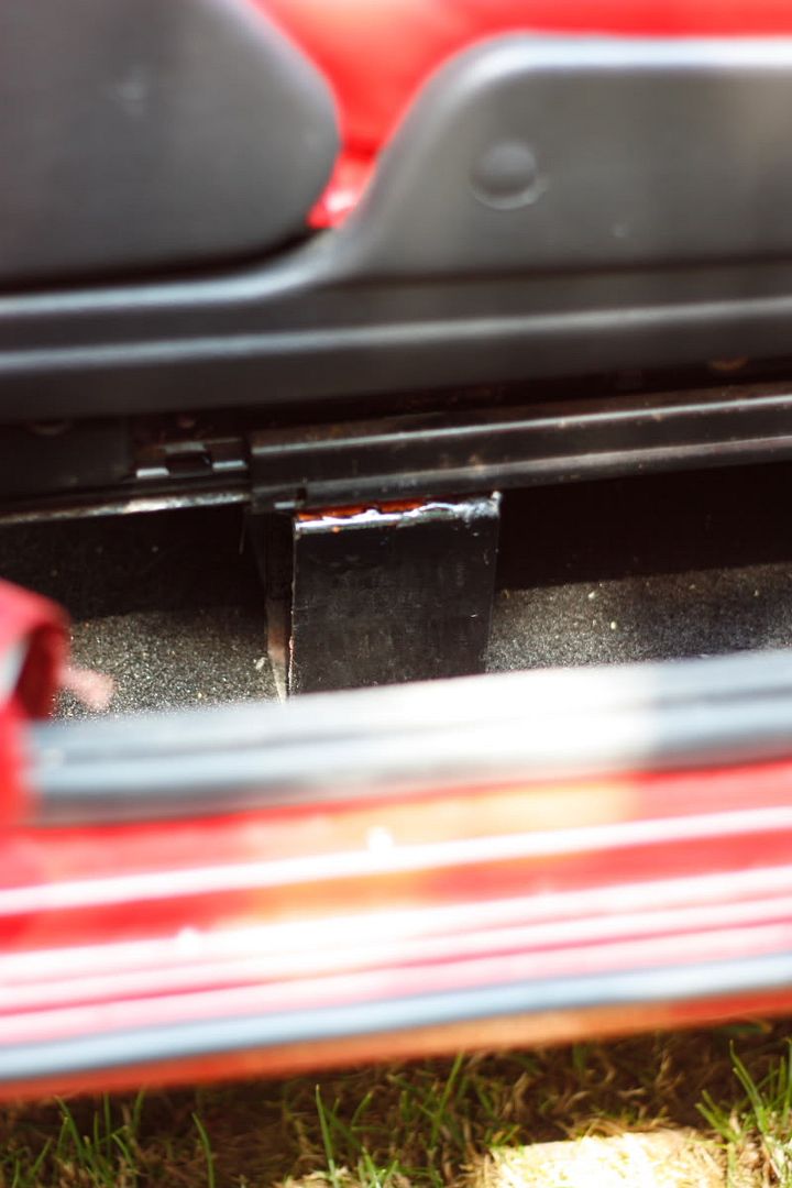

I've been Pm'd a few times about how they fit and the frames I have made, so here goes my explanation...
I welded a beam to the front of the runners at 90 degrees, this way there was a bar running the full length of the cross-member.
To support the rears I welded a small piece of box section to the outer runner and another to the inner runner. However, due to the exhaust tunnel, the inner box section was modified to create a triangular piece to fit round the tunnel. I then ran a bar between these box sections for additional support.
To secure them, I used 3 tech-screws drilled straight into the cross-member and another drilled through the floor into the beam joining the outer and inner box sections.
I'll upload the pics of the fronts later.

Posted 16 July 2011 - 10:28 AM
Dunno if anyones still interested, but I'm just uploading pictures of my completed interior.....I'll be right back....
#66 wardyxxx
wardyxxx
  • 1,327 posts
  • Local Club: Leicester Mini Club
Posted 16 July 2011 - 10:37 AM

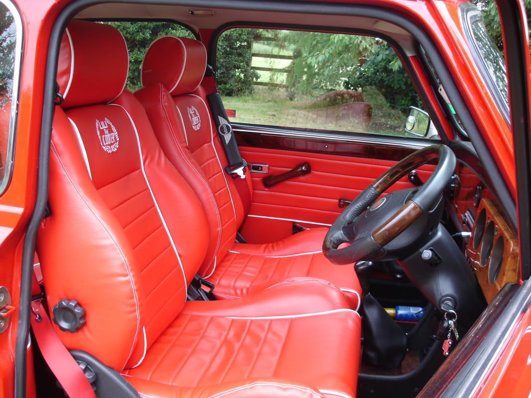

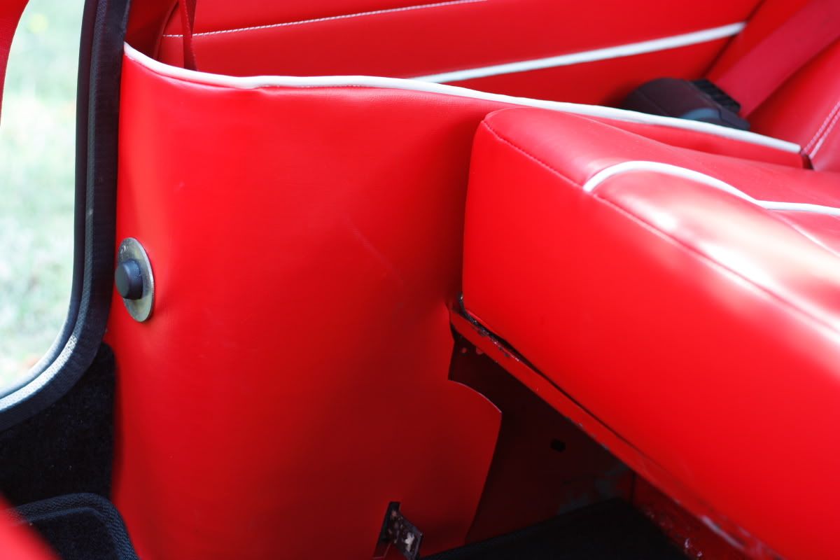

Here we go!
I love them. They are a bit of a tighter fit than my old Mini 30 seats, but there is more than enough room.
It's taken me a couple of days to adjust to the new driving position, but they have lumbar support and are a damn sight more comfy than my old seats.

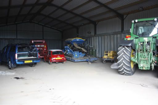

It's only the garage for a few more weeks, then it becomes a grain store! But not to worry, we've got 4 more free! :)

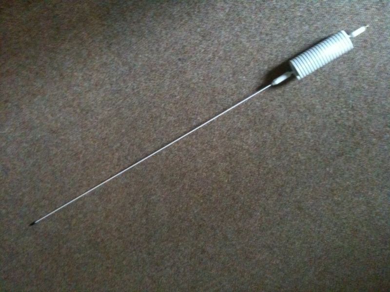

So, after a serious hiatus (i.e. work :-\ ) I'm back working on Lulu.

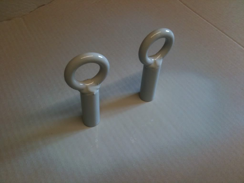

Although the bodywork is all done, and the seats, its time for a little performance upgrade....Had a little visit to MED last week, expensive, but it'll be worth it!
This weekends job is the 12v socket ready for my CB and my towing eyes.
All primed and drying:

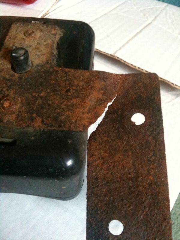

Nice christmas gifts (to myself):
No wonder my foglight never worked when it came to the MOT:
