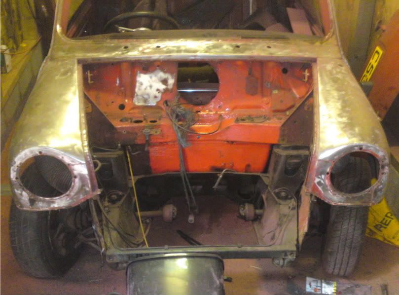

So far i have stripped one mini of all its parts and am now working on the shell which will have everything put into/onto it. I have stripped most of the upper body of paint back to bare metal. Still have the doors, boot and underneath to do. I have also now cut off the front panel.

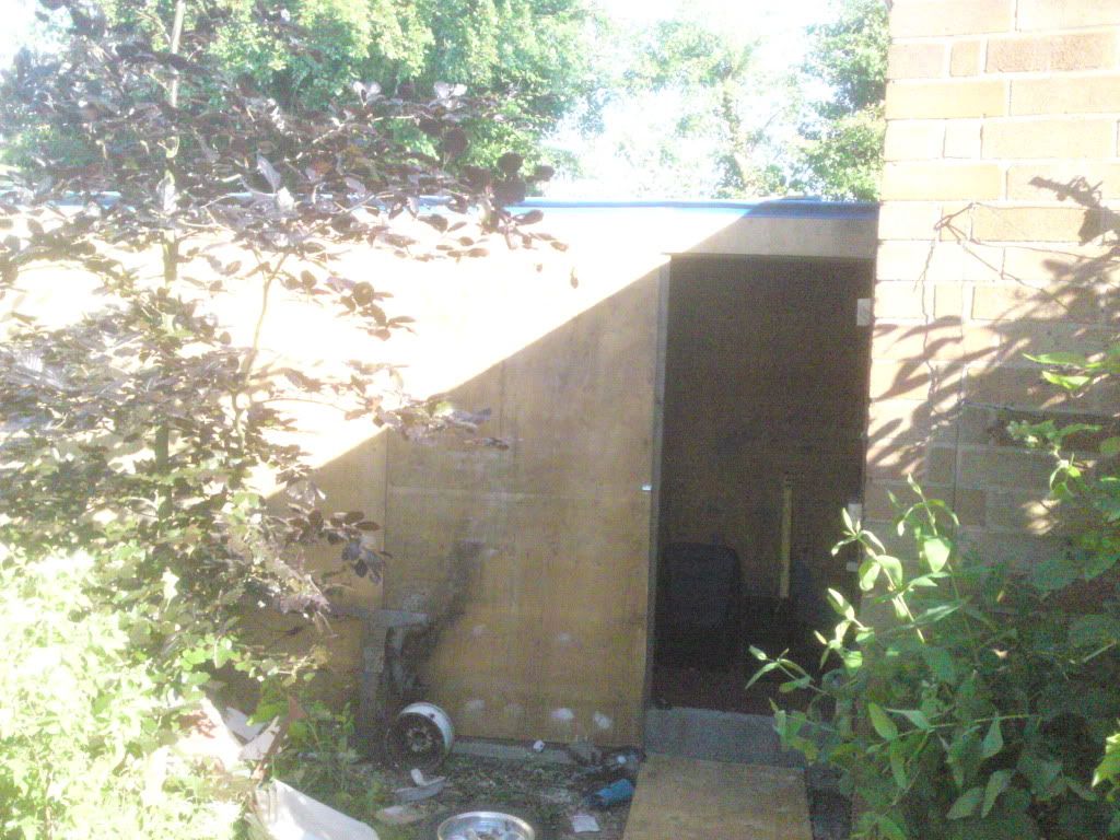

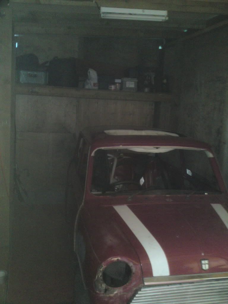

I built a garage around the car before i started work on it so i could work in the dry.

I used nitromors and a paint and rust remover attachment for the drill. This seems to work pretty well and am happy with the results so far. Has shown up more rust than i was hoping for but so far it still seems pretty solid.
There is quite a lot of rust around the front headlights but I think that I will be able to patch it up. I also had the idea to use some headlight bowls backwards for the headlight rings. Does anybody know if this will work? (hope that makes sense)

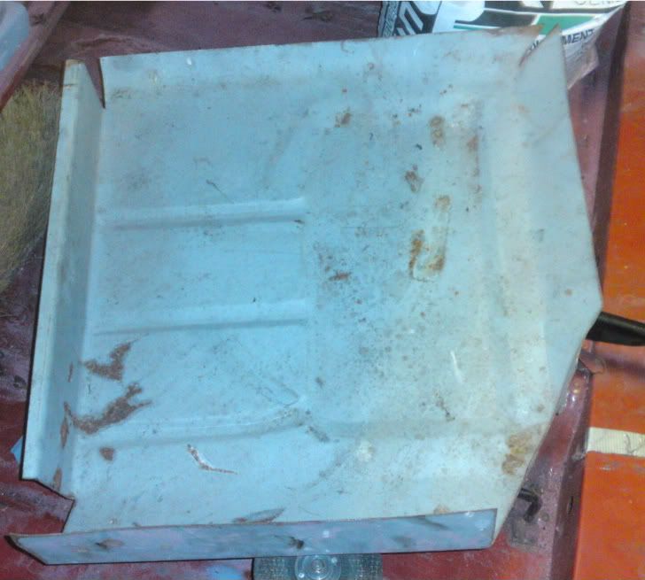

I am also replacing the floor pans as they have dents where they have been jacked wrong in the past. I have bought new panels but is it best to just replace where the damage is or to replace the whole panel?

Just a bit of an update. I have cut out my drivers side floor and have decided i will probably overlap the panel rather than butt welding. This is still open to be change however looks the best way at the minute.

Me and dad built the garage before i started and I am surprised at how good it actually is. Have a big shelf down one end with bits on and a workbench up the other end with wire racks above for more storage. When you next around that you could have a look?

Hi, Have realised i have been very vague with this project so far so thought i would add some more pictures and information on my plans.
Being a student i am trying to build this car on as much of a budget as possible. Therefore i will be doing the work myself with the help of friends aswell. I am going to work around the top part of the car sorting out any welding that needs doing and then prep ready for painting.I bought myself a compressor so i can spray it myself however for the last coat i think i will head to my friends workshop where he has a large compressor. I also have a mig welder already which i have been practicing with but need some more practice before i get onto the car.
I had an accident in a previous mini and after finding alot of rust decided to sell on the shell and salvage any bits to use towards this project.

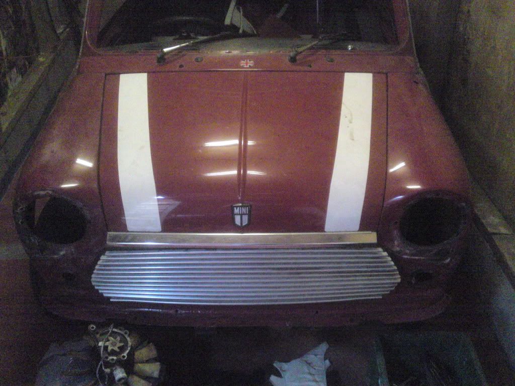

This is how the shell started out. It looks pretty solid so far. There is some major rust around the headlights. Some minor bits around the front and rear windows, in the boot. There is also some rust at the front of the O/S sill however have not got the paint off to see the damage yet. also on the inside of the engine bay there are some rust patches which i will weld some patches into.
I have bought Koni adjustable shocks for all round the car.

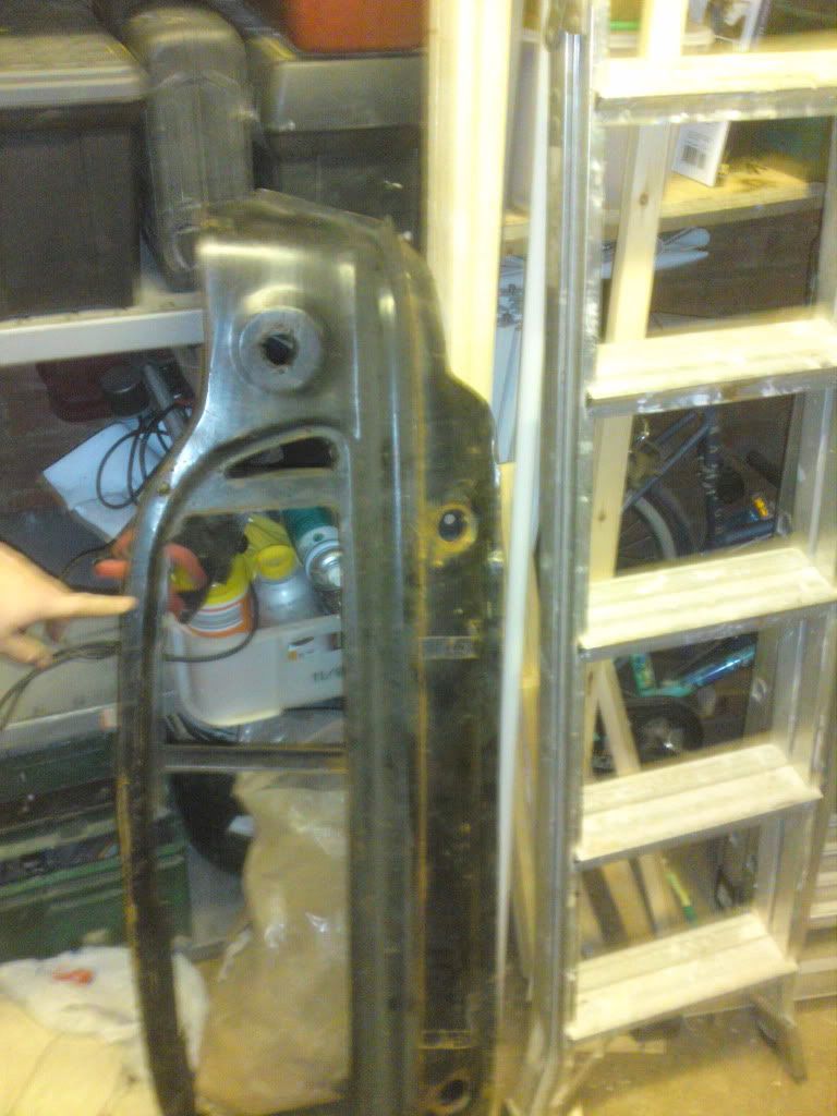

I have a new front panel already bought too. It had some light surface rust when i bought it but i have now tidied this up.

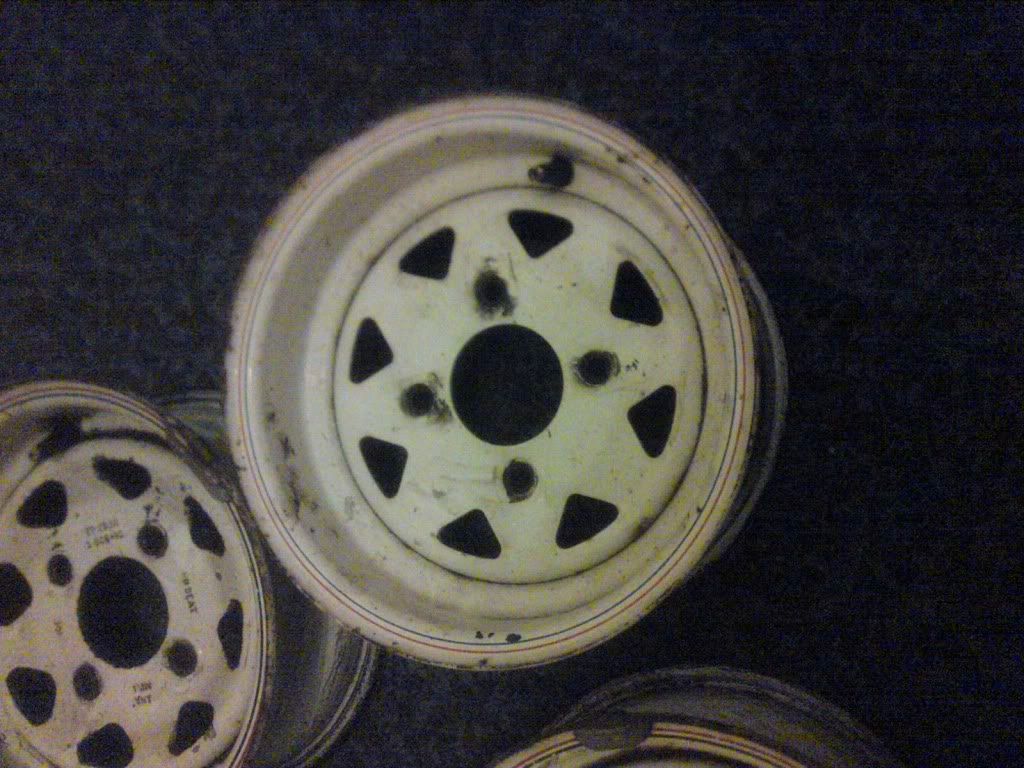

I bought some weller 10inch wheels however didnt think about my 8.4 brake setup so I may use some superlite 12x5 wheels i already have instead (2 need replacing)
W&P arches to go on.
So far i have stripped one mini completely and with my new mini shell i have cut off the front panel and cut out one floor pan. I have also stripped the toop half of the car of paint. All it needs is some wet and dry and then will be ready for paint minus the bits which need welding.
As a colour scheme i am thinking of yellow with a black roof, black stripes and black wheels possibly with a pinstripe. I would also like to debumper the car and possibly smooth off the bootlid.

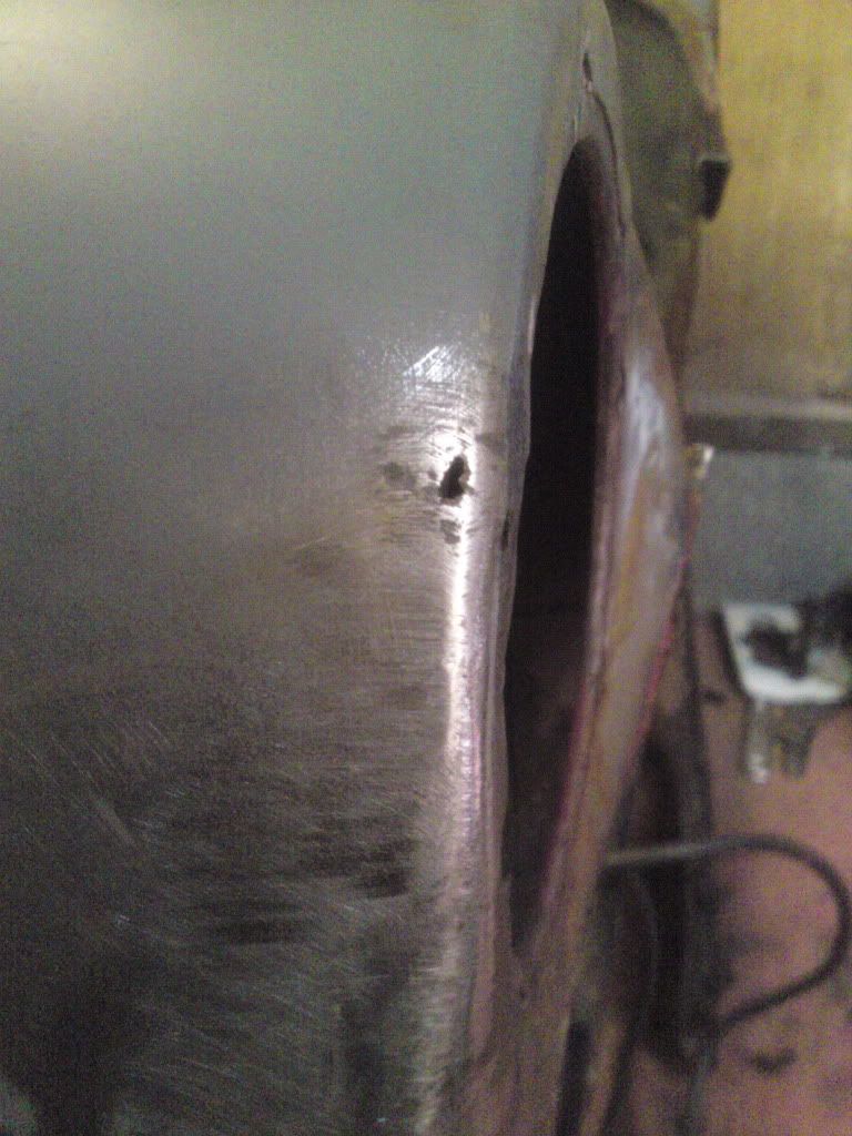

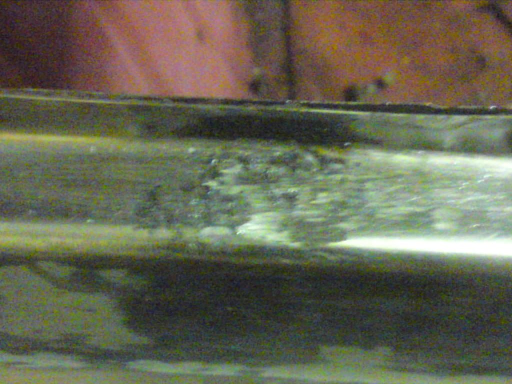

Hey. Did some more work on the mini today.

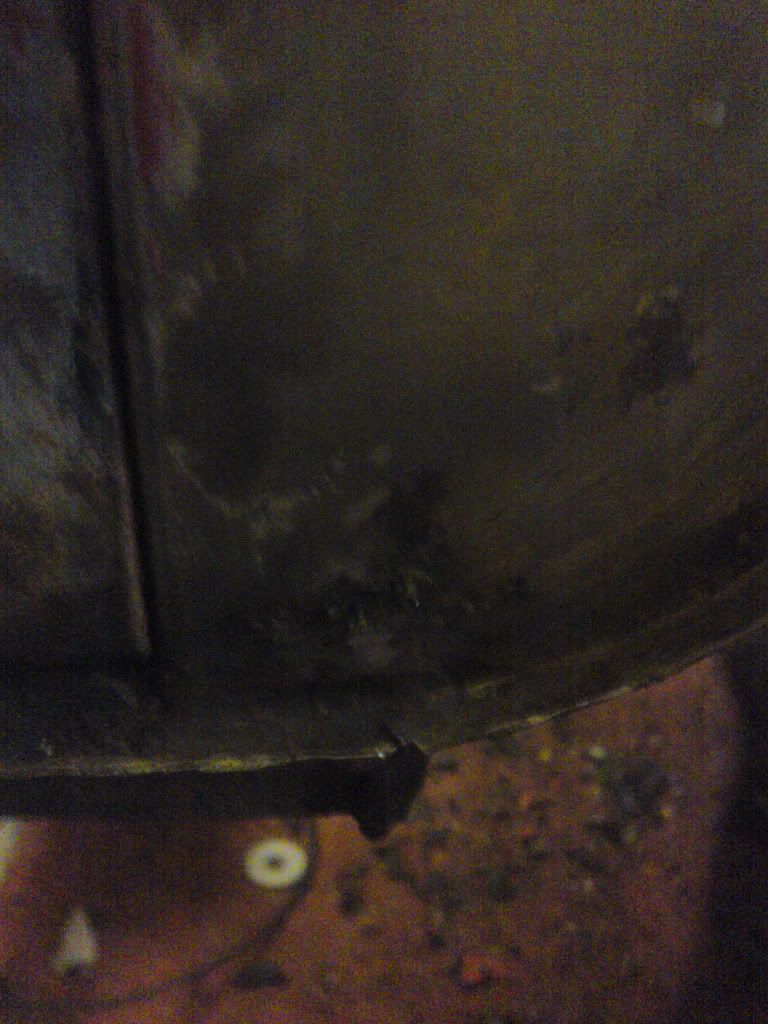

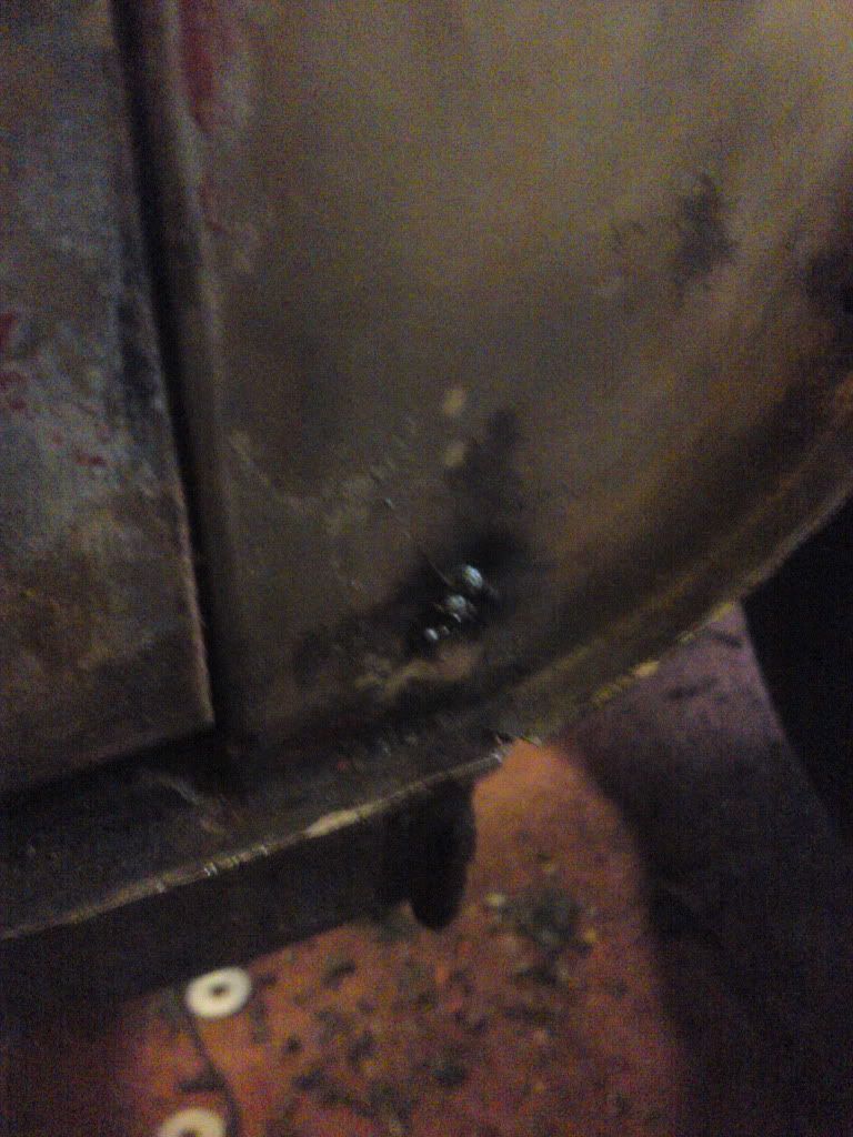

Had a few holes in my A panel which i have welded up.

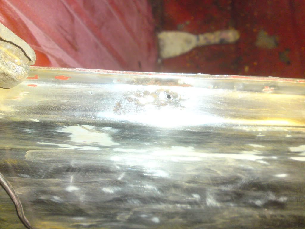

There was a bit of rust on the back window which i have rubbed back to metal and added some weld on top then ground back.
I have also welded up a few holes in the front wing.
All the welds still need some tidying up but not bad for the first bit of welding on the car considering i have never done it before. Only had a little bit of practice on a few scrap bits of steel.
