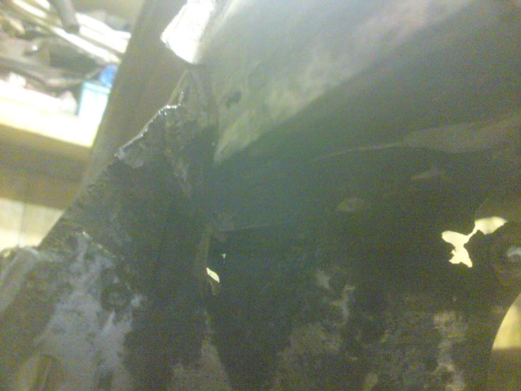

Where the a panel joins the hinge panel it has rusted through so i have bought a new panel to replace it.
I also stripped more paint to find more rust
There is also a few holes in the scuttle, rear seat and o/s sill

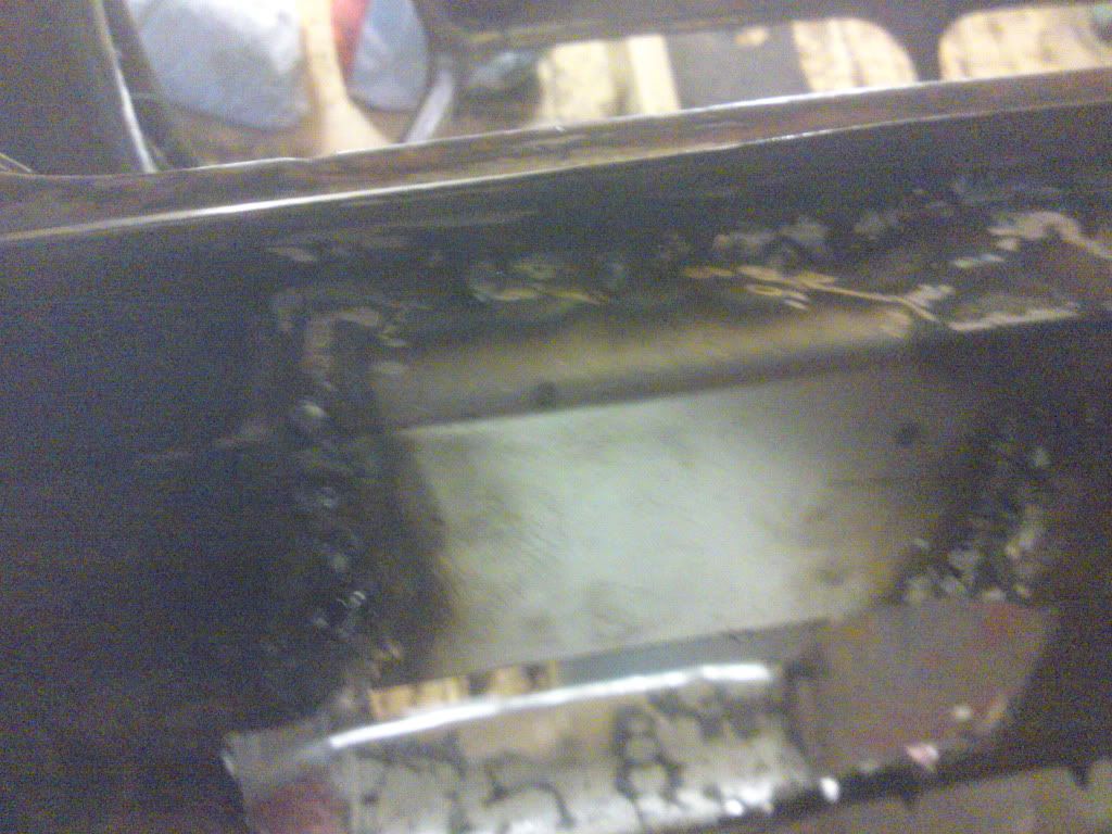

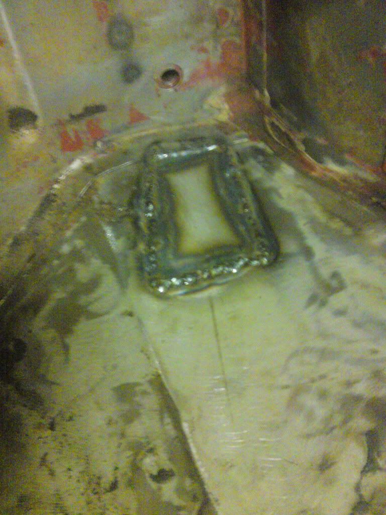

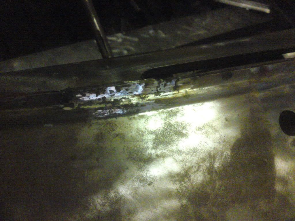

I have started welding on the mini today.

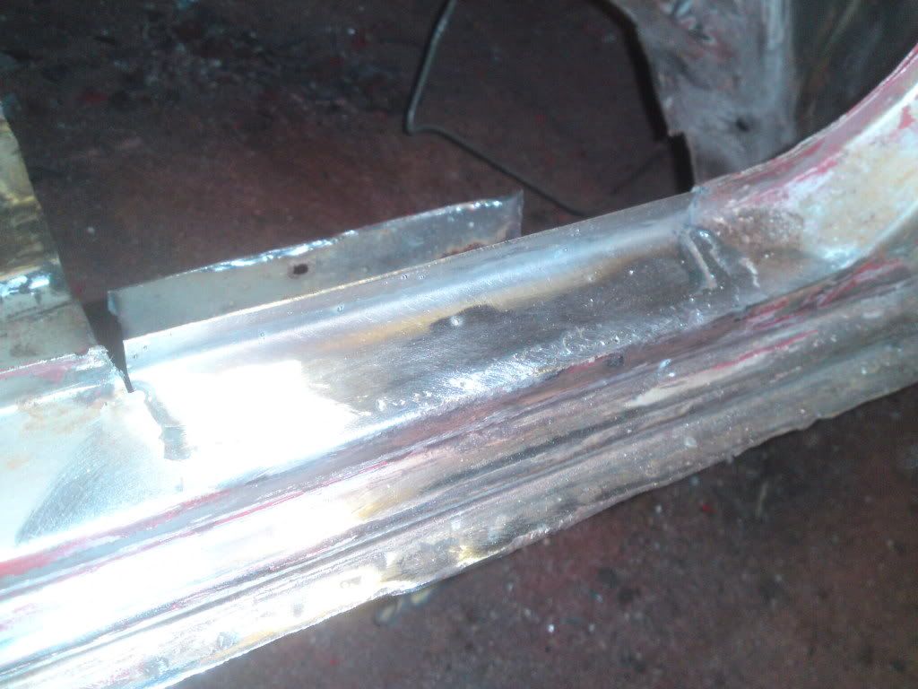

I welded a patch after cutting out the doorstep. Whoever had it before filled the hole in with filler on both doorsteps!

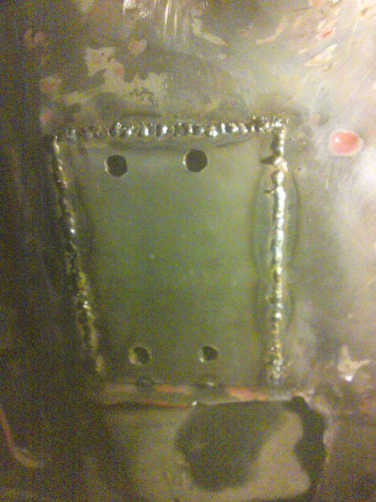

I also welded a patch over my suspension mount.
I welded a patch over a hole in the rear seat.
There was a hole in my scuttle so i have welded this up for the new wings to go on.

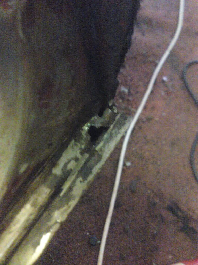

While searching around the car i also found holes above the air vent underneath the O/S scuttle :P
Also found more rust on the sills. I hope after i do more digging that no more comes up
So far it seems to be going well :trooper: hope it all carries on as smoothly

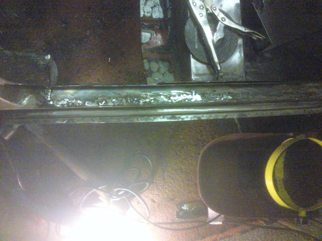

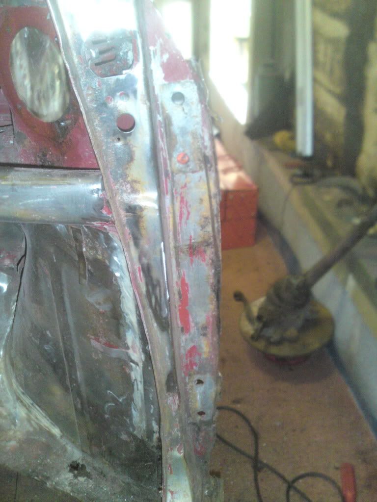

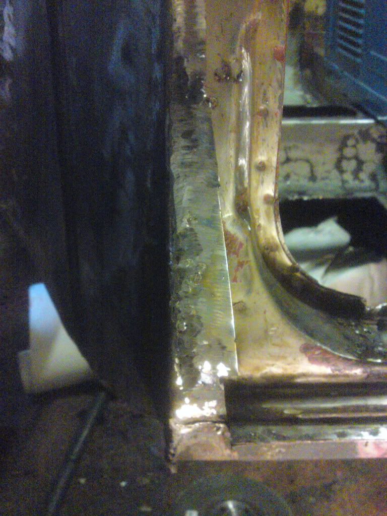

Since the last update i have made and welded in some repair sections for the offside sill. i have also partly welded in a new drivers side floor pan and made up a patch for the other door step.

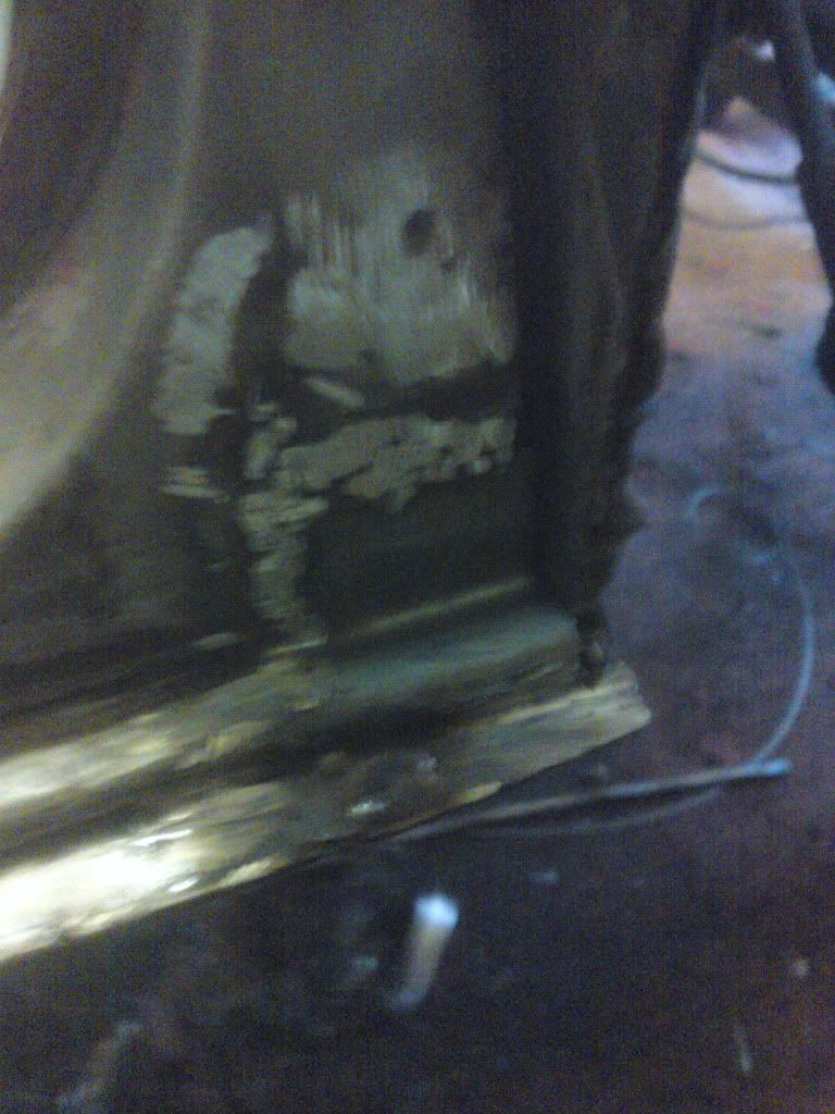

Made some more slow progress with the welding i have got to do.

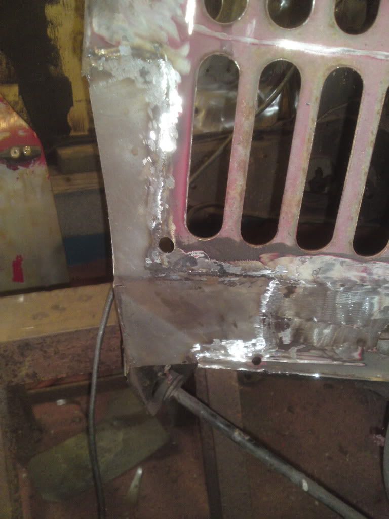

I had a few patches on the passenger side door step which needed attention so decided to make a patch for nearly the whole length. This also meant i could add some anti rust stuff on the inside at the back.
I have also repaired the front bottom of both filtch panels as they were looking worse for wear.
There was a hole where the a panel meets the doorstep so i also made a patch for here.
I have also done alot of patching on the sills but not got many photos.
There were big rust issues around the window so this was sorted with more patching!
The hinge panel on the passenger side needed a patch as a hole had formed! still needs to be trimmed down!
The air vent also has a patch now :P but forgot to take pictures
Most of the welds still need work on them such as grinding but it all seems to be coming together slowly. and is good to be able to see what i have achieved so far.

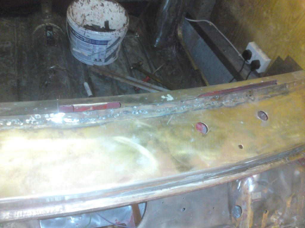

I have cut out the badly cut speaker holes and welding in a new plate
I have also done some more patching in the boot
