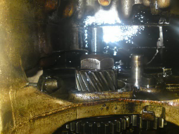

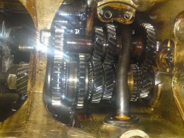

Hi all!
Well today ive managed to split the gearbox and block which came off easier than expected. Looking at the gearbox;a bunch of syncros and large teeth things, i wouldnt know where to start and id be lying if i knew what it was. Is there anything that stands out in particular and what should i be looking out for in general for signs of abuse and badly worn parts/
Also -

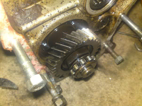

How do i remove the roller caged bearing which sits on the mainshaft on the flywheel side, the one before undoing the large black nut?
And the other; Which is the best way to lock the mainshaft i dont particularly want to wedge a spanner between the layshaft and mainshaft. This is so i can undo the large nut that also sits on the mainshaft but at the opposite side next to the diff housing wheel. Haynes say to select a gear, i do but the two shafts still spin when i try to undo the large nut!
thanks

Right sounds like you need some Baulk rings! or maybe have a worn 1st/2nd Syncro hub

Does sound like it needs a rebuild. Yes the nose bearing, remove the rollers one at a time, CAREFULLY, as the cage is easy to split, and then remove the cage. this will leave you with the inner race still on the shaft, but your socket for undoing the nut will fit over it. The big nut in the gearbox is "F" tight
150 nmtrs. And the way to get it undone it to select first and fourth gears which locks the box up. then use your deep ball joint socket and a long bar. big heave and job done. the whole box is going to want to turn over as you are doing this so get it jammed under something solid.

You need to take off the Circlip on the end first to remove the nose bearing.

Secret knowledge!! Idont know what you mean......... Now has anyone seen the goat!!! LOL. By the way you can use a bearing puller to get that inner race off once the rollers are off. And to lock the box in first and fourth you need to dissengage the selector rod from the selector forks (you can see it through the side as you allready have the diff off) then push the syncro hub towards the main roller bearing to select 1st, and then push the other synchro hub towards the opposite end of the box to select 4th, Carefull you dont push to far just enough to engage the gears. if you push to far you will release the balls and springs (PING)!!!! They will fly out at warp 7, never to be seen again.

The clip is off and snapped in the prossess so a new one is in order.
