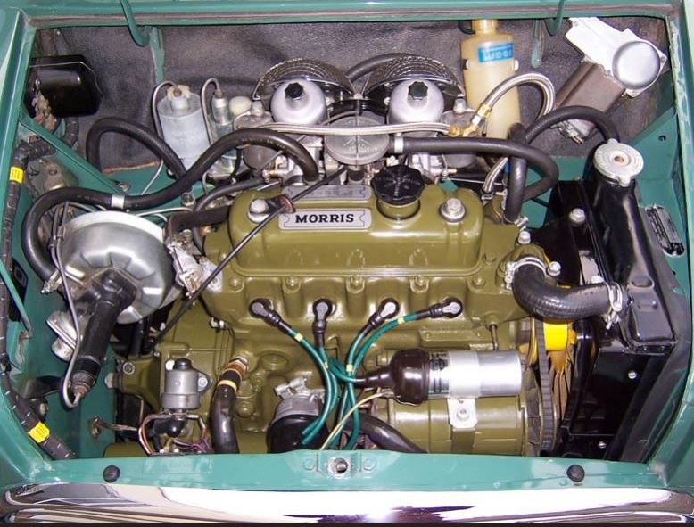

lovely car but you may want to have a look at the positioning of the servo. i borrowed the pic from another posting -
#417 hazpalmer14
hazpalmer14
  • 685 posts
  • Local Club: cumbria mini cruisers
Posted 05 May 2019 - 03:02 PM
Clubman inner wings are different, probably why it looks different
#418 The Principal
The Principal
  • 763 posts
  • Location: Sussex
Posted 05 May 2019 - 04:04 PM
its round the wrong way and the air valve is upside down nothing to do with inner wings
