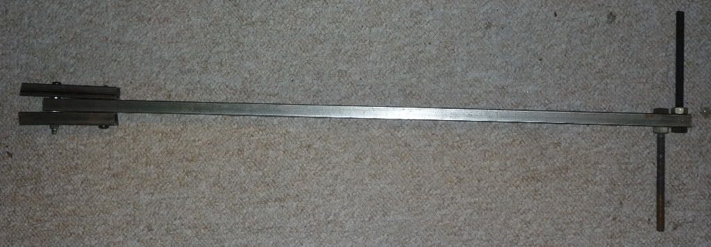

#11 electricjim
electricjim
  • 237 posts
  • Location: uk
  • Local Club: WSMOC
Posted 07 November 2010 - 03:04 PM
i made this to gain access to the arm to work it, still had to remove the air vent and washer bottle first though
