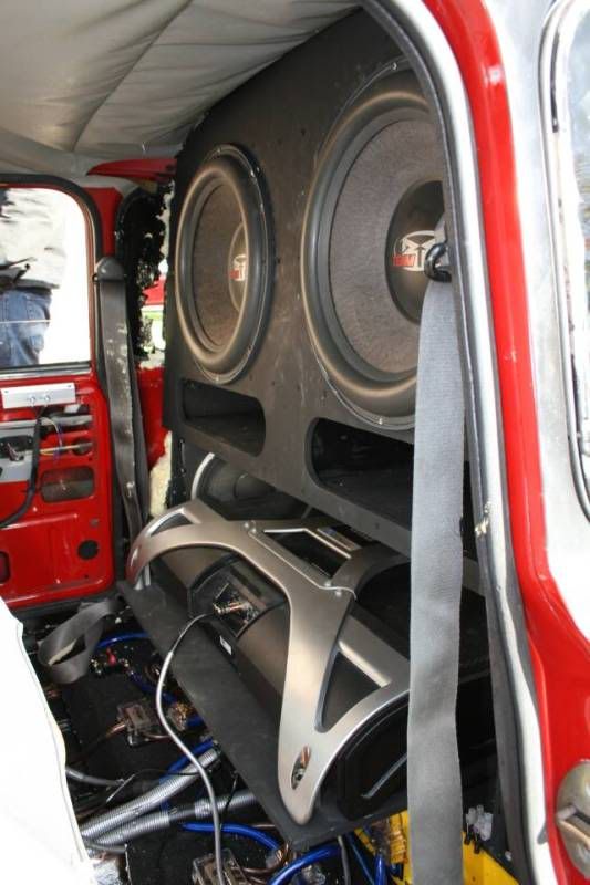

I saved a picture of Pbrains system a little while ago, hope he doesnt mind.
That is mental, I think the OP may have a bit of work to do in order to get the loudest mini. But if your serious about it and have a large budget for it.
Go for it!!!!
i'm glad you've got this, i've got it stored on my server somewhere.
As you can see, this was taken during the initial install, those Fosgates weigh an absolute ton, trying to hold in place and install the fixing bolts was hard work, i reckon they're around 30-40Kgs each.
The A6000Gti was on a sliding platform to allow access to the rear connections.
The 4 Yellow-tops was fed by a 250A relay, this was only active when ignition was on & HU was on, this allowed the system to be run without engine running and not worry about a flat starter battery. 4x 250A resetable fuses linked to the input of the A6000Gti
The little connector block (in the bottom right hand corner) was to allow quick change of the filter capacitors for the tweeters high-pass frequency.
On the driver's door is a remote control volume panel for bass amp & mid/high amp, this allowed me to turn the volume up without sitting inside!
Despite making large branches fall from trees, the porting didn't work. i couldn't find any data on the Team Fosgates, so i based the ports on the slot designs for the Fosgate Power HX2's and increased the sizes to allow for the increased air-flow...no good!
I've pulled the speakers, amps & batteries out...the car has been sitting in a garage for over a year now abandoned, it's a real shame, but i haven't the time or place to work on it.
i'm in two minds to leave it for a possible re-install in the future or sell the extreme stuff and put the Mini back to an 'every-day' car :cry:
Edited by pbrain, 16 January 2011 - 10:26 PM.
Go for it!!!!
those team fosgate subs love huge ported boxes, a good rule of porting is for every cu ft^3 of air, 10sq in of port for "sq installs" and 15sq inch of port for "spl" type installs
im guessing you had the box set up in a 2chamber style, so how many cu ft per side after port and sub was the sub seeing?
also it looks like the box is made only from one layer of wood, im guessing 3/4in thick, so the box had to flex like crazy with that kind of power and those subs
[/quote]
I did draw the box layout and sizes somewhere, it's probably lying around the garage floor! Yes, they are 2 separate boxes, the top & bottom panels are 25mm MDF, while the sides are 2 panels (Ply & MDF) totalling around 45mm. The gap between the boxes & car panels was filled with expanding foam, which done a fantastic job of stiffening.
The front panel was 15mm ply, this was plenty due to the fact of the small distances between panelling & the massive subwoofer frame.
