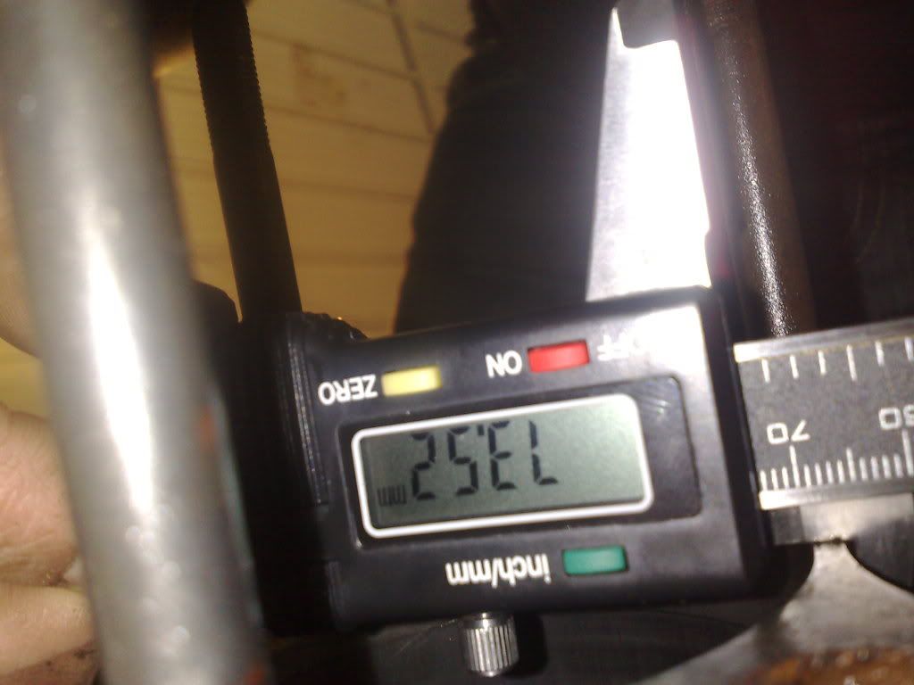

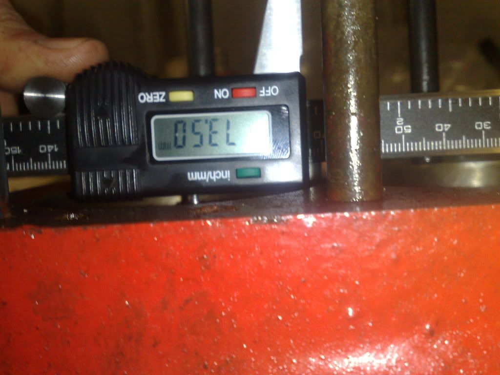

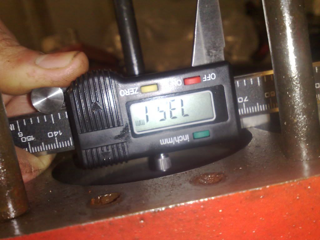

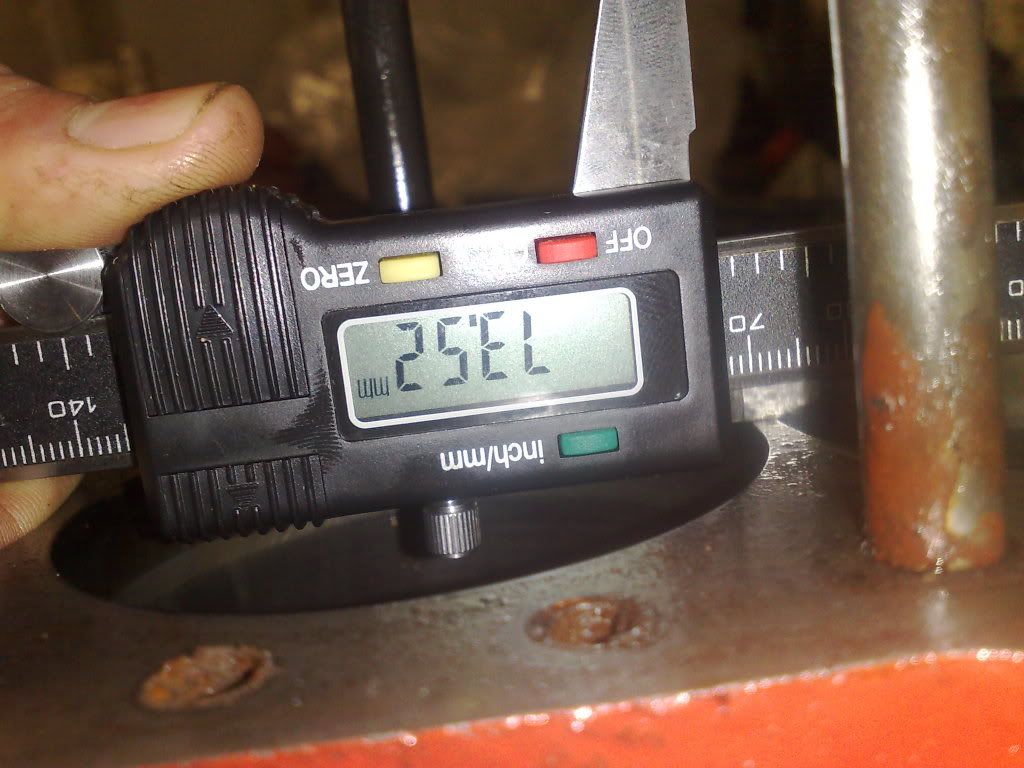

Bit of an update, i've managed to get hold of a vernier guage from college actually :huh: So today i've been measuring the bores. It kept coming up with mixed readings but got the guage centred in the bore and got some readings eventually, they are as follows:
No.1: 73.52mm
No.2: 73.51mm
No.3: 73.50mm
No.4: 73.52mm
It seems as if the pistons would be just about a perfect fit and that going by the ring gap measured in the bore it would seem the rings are too small but i'm not sure?

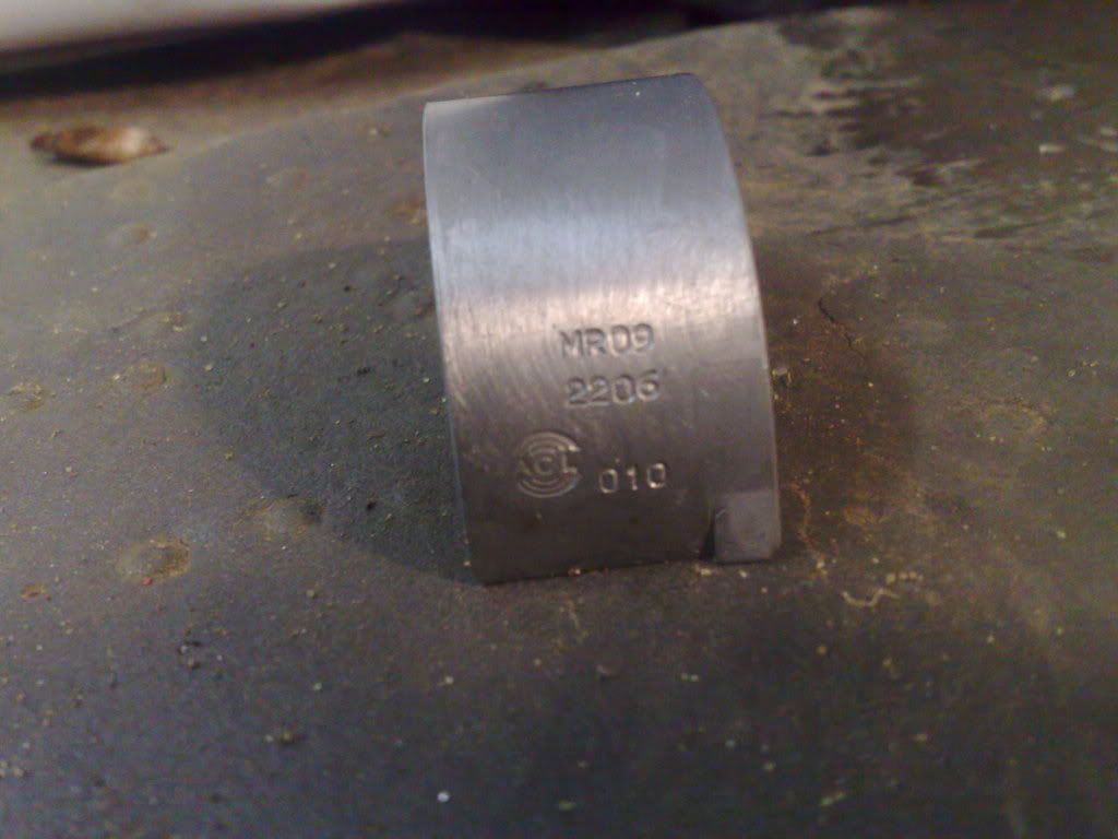

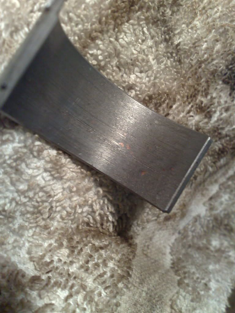

Anyway i've added a pic of the big end bearing shell to show the condition and type they are. Oh and a quick one of what it looks like at the moment with the 998.
