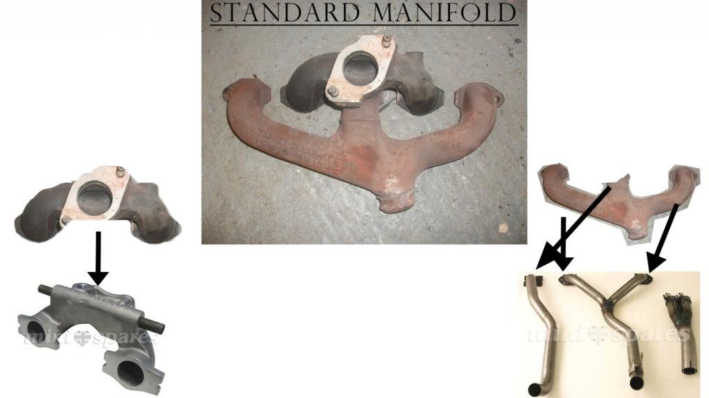

I just done a quick little break down of the standard manifold assembly (which is what you probably have) And the new Manifold (LCB) you are going to be installing. This diagram shows why it is essential to have a new inlet manifold when installing the LCB. This pretty much just puts what everyone is saying into picture form :D
The main advantage of the new LCB and inlet manifold system is to gain more power out of your engine! The A series engine's most restricted part is the Carboration and Gas flow. As you can see the standard manifold is trying to push all the gases from the three ports at the back of the engine out through one pipe.
Where as the LCB allows the gases to flow more freely and quicker through the 2-1 and the single pipe.
But yes what you are essentially doing is adding a 'stage 1' kit to your mini by adding this 'gear'. So to get the rest done, it would be highly recommended to buy yourself a new performance air filter e.g. K&N. Also it would be a good idea to get a different carb needle.
