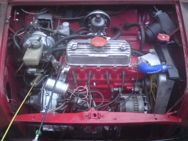

Posted 23 March 2011 - 02:14 PM
Picture of mine.... All spongy stuff removed because it is horrible and heavy and I dont like it!!! Er.. sorry was i ranting..
Was looking for a pic lol thats what it should look like !!!

Posted 23 March 2011 - 02:23 PM
Well ace thanks Andy! Thanks to Lola as well! The way the pancake goes it has the little bit where the cone filter should fit on ( where the back of the filter bolts onto ) looks like I will need to remove this too, thanks guys for your help much appreciated!
