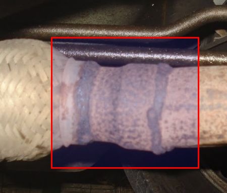

I wouldnt be surprised if all these low hanging exhausts are genuine factory items, since the youngest of these are 11 years old and the oldest are 20 years old. When was the last time you saw a car that is that old thats done a few miles, with the factory exhaust?
I am sure that the factory down pipes flexi joint was also never that 'fat' and a little longer, making me suspect that its not a genuine part.

Now that you mention it, look at the weld joint I had ignored until you said that:
That looks well dodgy! Looks like a thinner piece has been welded to the end of the downpipe to make it fit the flexi-joint... I'm inclined to agree with you. That said, I'm surprised an 11 year old car needed a new downpipe - more rearward bits of the exhaust, I'd grant you, but something that close to the engine I'd normally expect to last a lot longer. But then I don't really know Minis yet. =)
