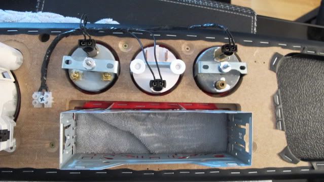

here is what I did, wired up together and fed directly into the side light circuit. Been fine with no issues .
Im now thinking of changing to LED lights to get them a bit brighter......
As for power for the clock, I took a feed directly off the fuse box under the bonnet.
