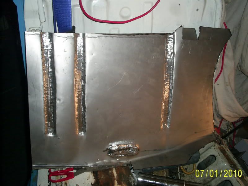

I too have made my own panels. Get some sheet steel 1mm thick and start cutting. My sheet 2m x 1m cost about £40, and I have done inner sills, boot floor and lots of smaller pieces. The bending of the steel is the problem you will have in long lengths unless you have a bender. I haven't but there are plenty of engineering works out there who are only too happy to help you out, especially if you tip them !!!
I am a panel fabricator due to finding that the pattern panels just don't fit well enough and if I make them myself I know they will fit. However be aware that this could have a knock on effect if you then try to fit heritage panels to your own !!! my valance closers, bought, won't sit properly onto the boot floor so will need fettling !!

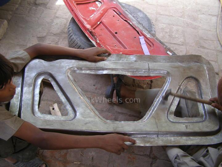

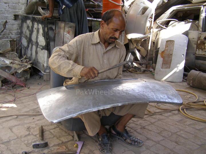

There was a topic about a project over in india (i think!) about a guy who was making his own exterior body panels. Very cool
Ill just see if i can find it...
Edit - Here
