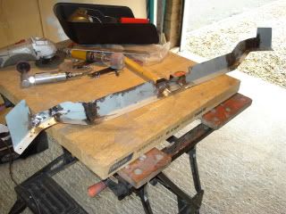

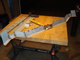

I made my own door step as the pattern part ones are really naff
This was formed by welding together three folded sections carefully to minimize distortion
welded in place waiting for the ends to be ground flush.
