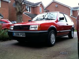

Thought i recognised them, they were strapped to my G40, they're standard fitment on the G40 as mentioned previously
