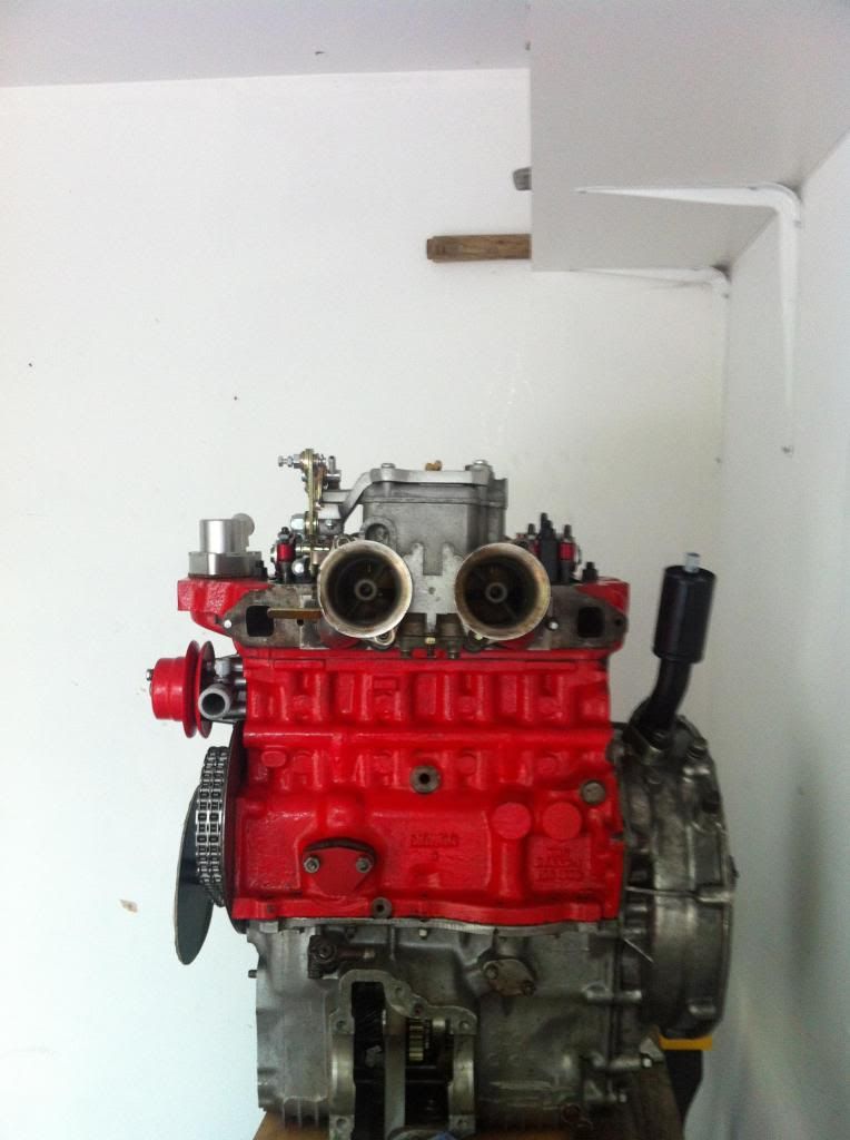

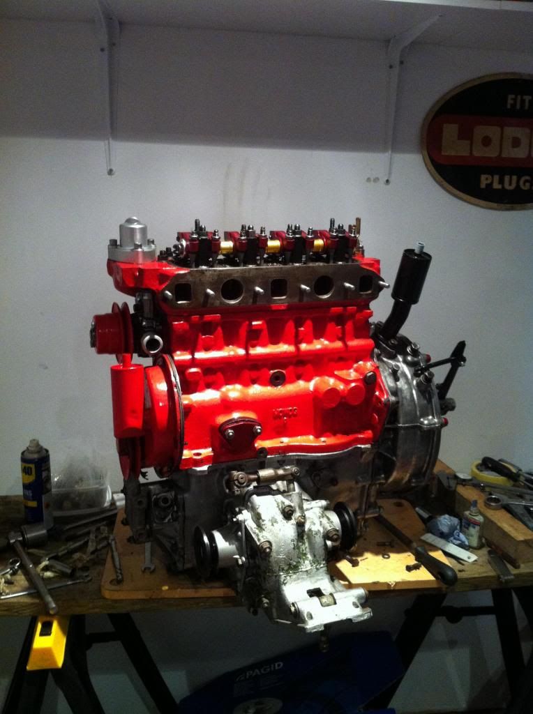

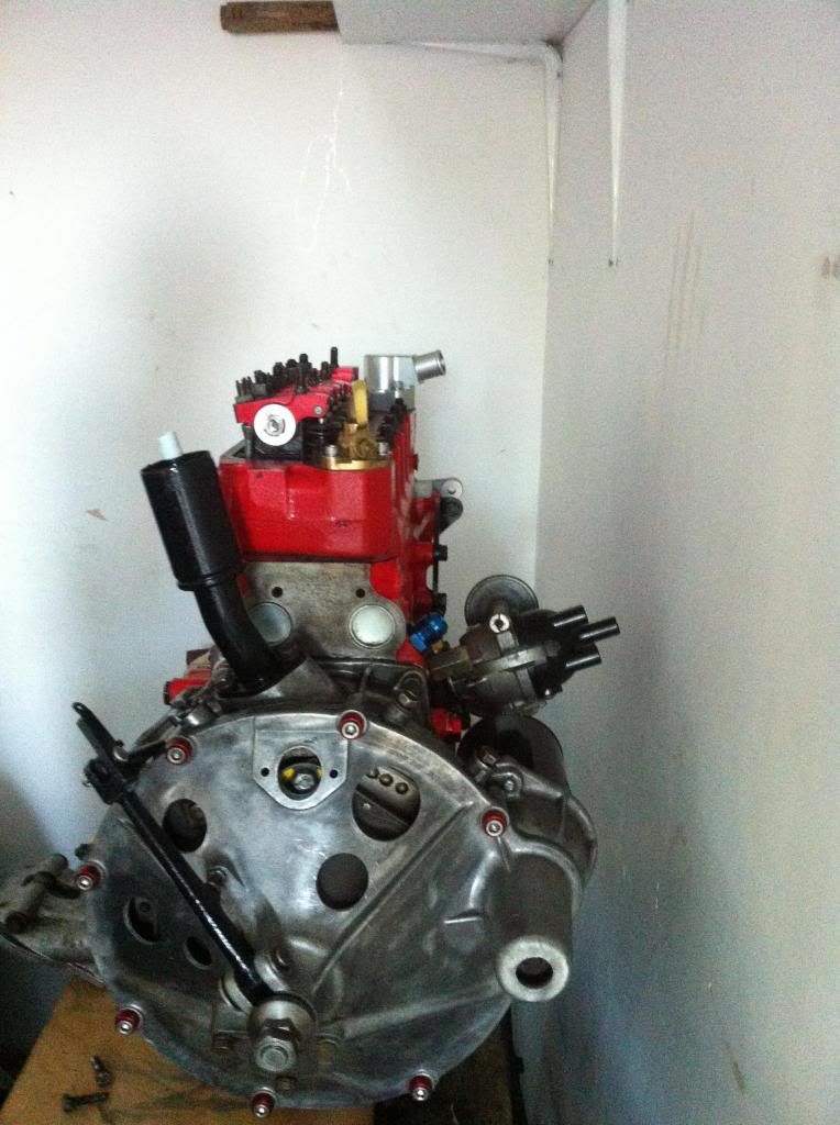

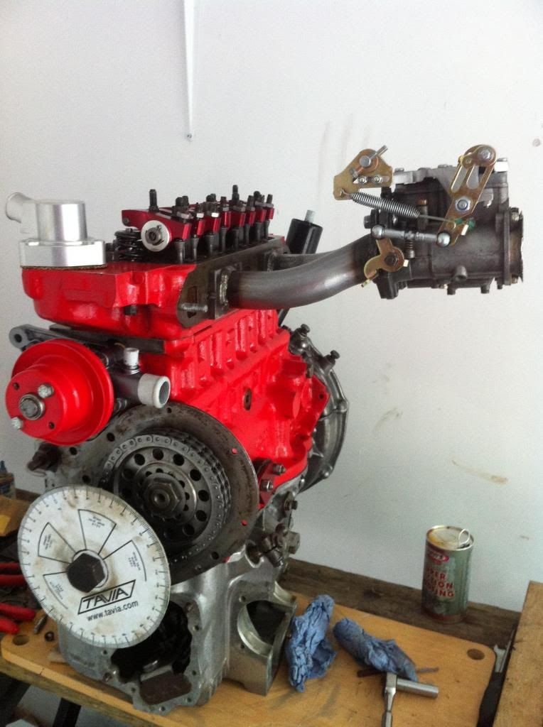

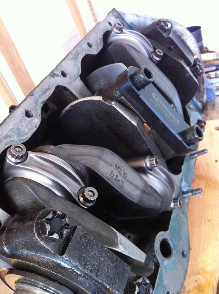

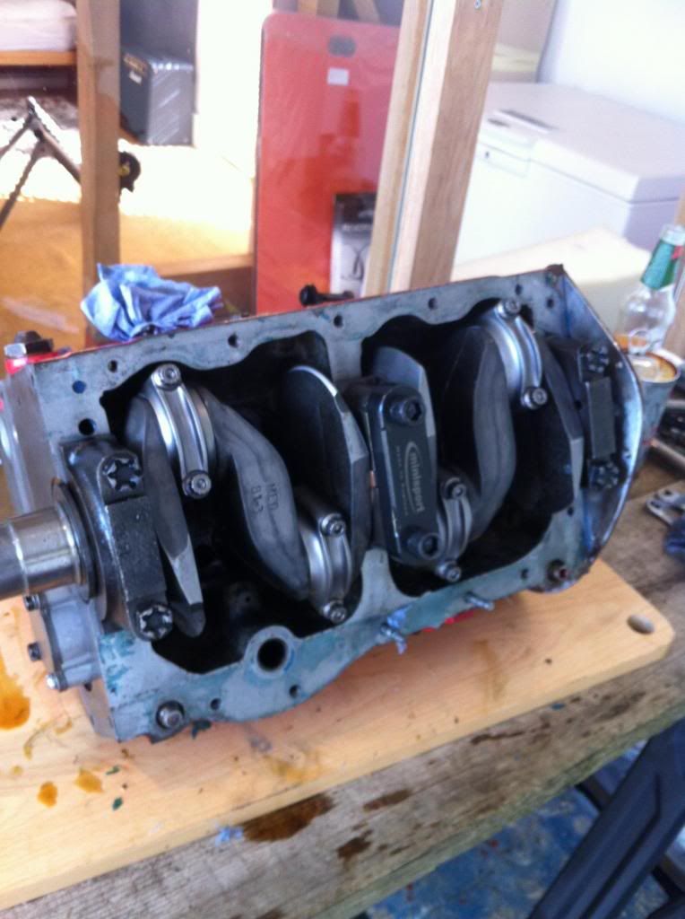

starting the build now, got the rods etc on, cam in (piper 649+) and just waiting on getting a timing disk to finish that part.
now for something a bit DIFFerent :D
aaaw yeah set that up tomorrow, stiff dont have a timing disc to time the engine back up!!

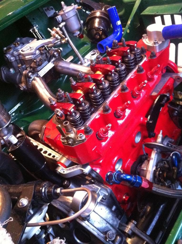

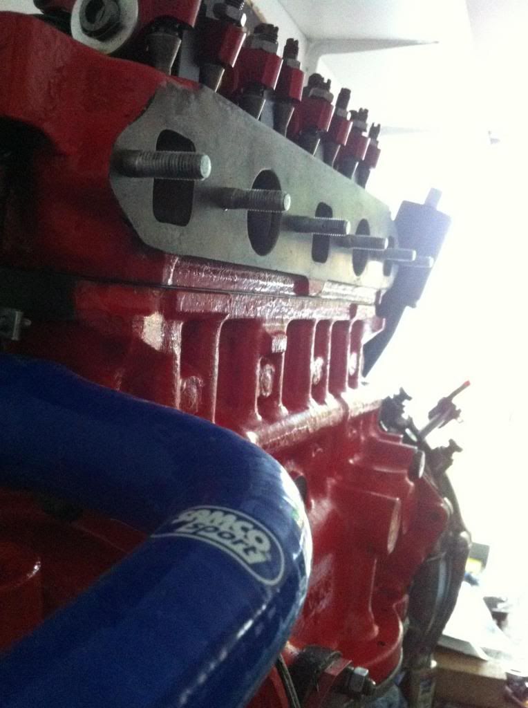

now.. engine!

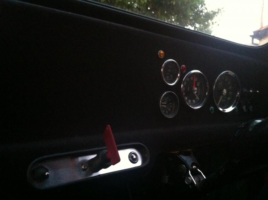

dash lookin pritty
finally framed one of my dads posters!

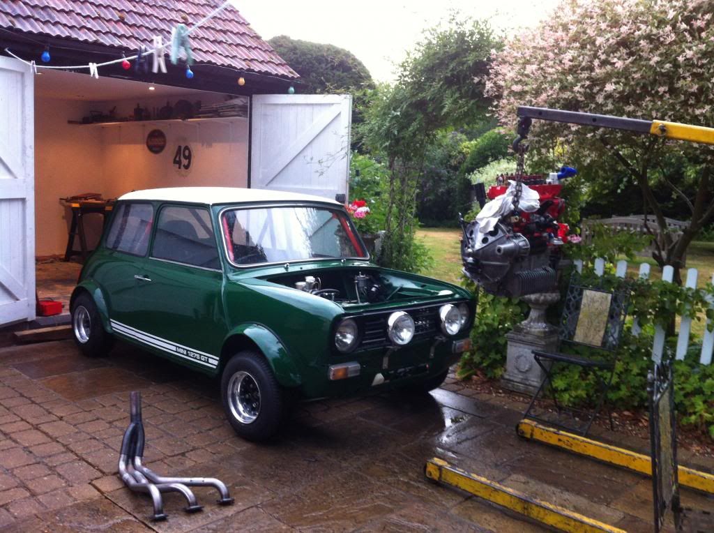

install post rain D:
maniflow, you are just so good. worth every penny went straight in!

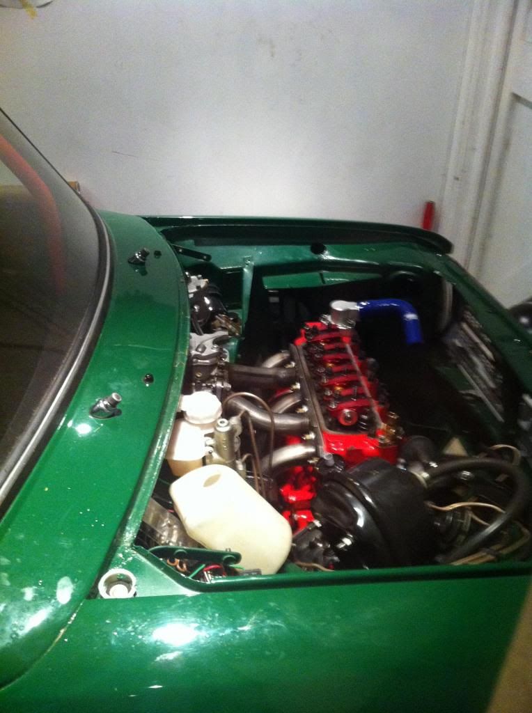

just finishing the cooling system install, making brackets and fittings and stuff.. taking time doing it right making it look good:D  changing all bolts for button head allen bolts!
going well   cheeeers

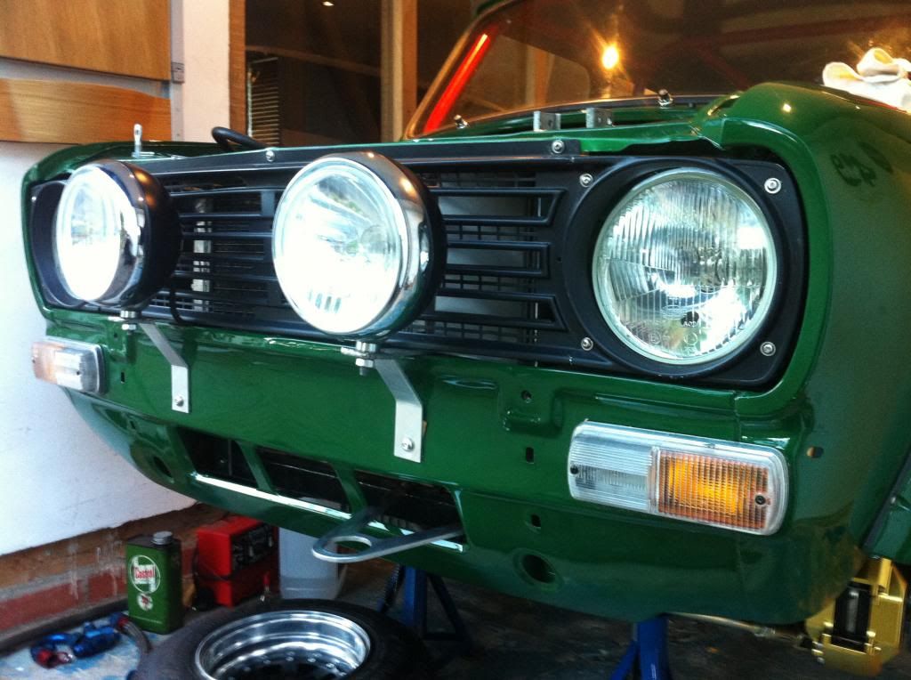

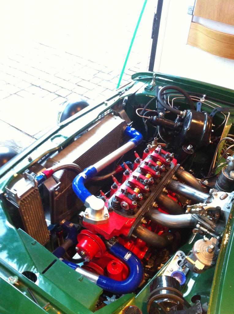

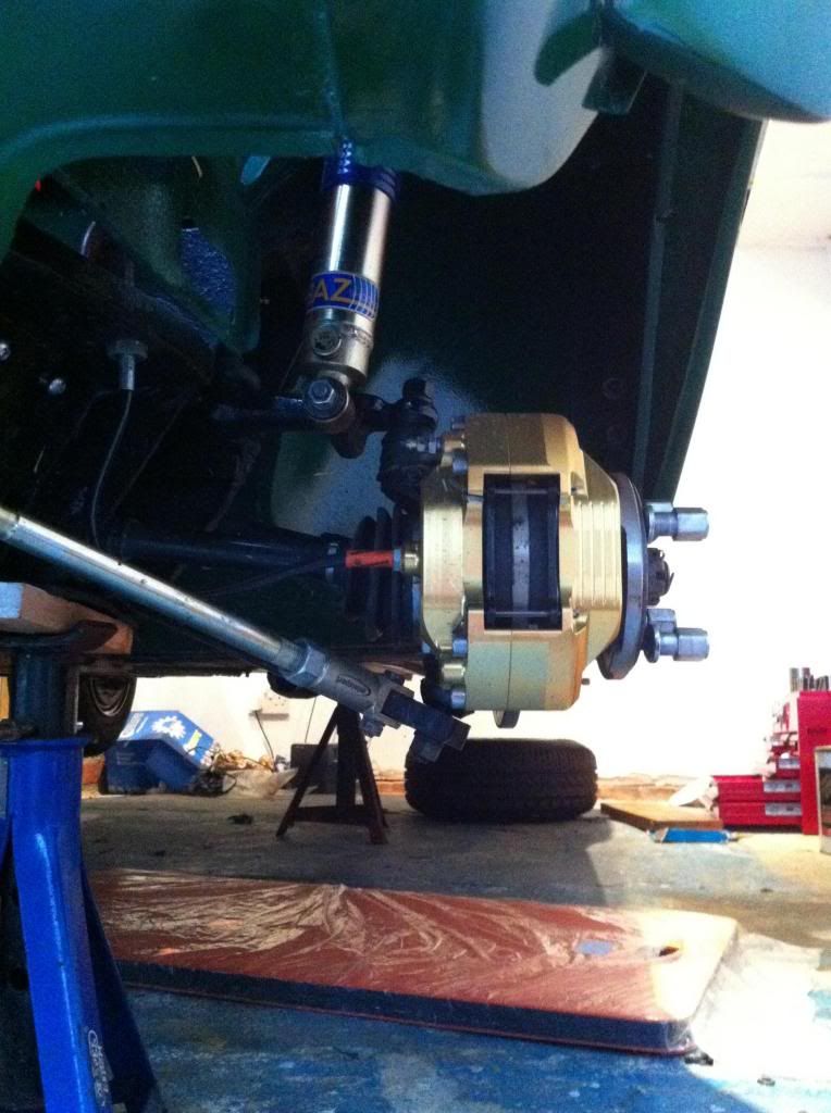

the rads mounted, used 6m ally to make some brackets, top are rubber mounted using rubber cotton reels, and they are bolted to the subframe. the rad is bolted to these and sadwich 8mm of rubber washers i made (stamped out some rubber matt with 3/8 stamp and a 5/16 stamp in the middle)    the rad floats really well in the frame and there is loads of frontal air space for cooling. im putting a slimline rear mounted ran on it for traffic, but its so huge i dont think il have an issue. i have got a 'Stat!!
i made an oil cooler duct, goes right up to the grill and fans out and is just lovely if i do say so myself! thats yet to be mounted though!  all hoses are routed, i need to make some mounts on the lathe/mill for the alternator and then get the right offset V belt pulley for it, and then wiring!

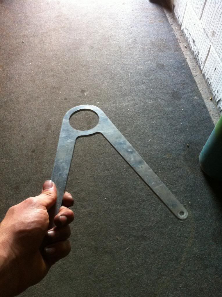

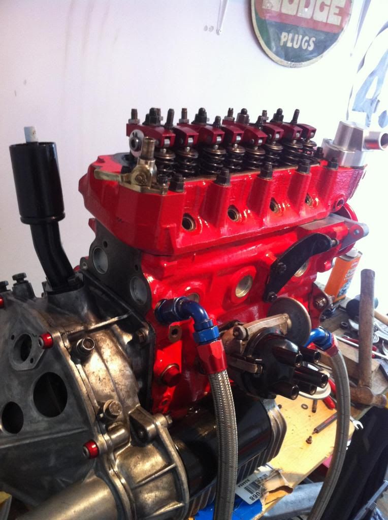

Do you mind telling me where you got that top engine steady on the clutch side from?
#208 Artful Dodger
Artful Dodger
    " I AM THE SPECIAL ONE"
  • 4,435 posts
Posted 07 December 2013 - 08:37 PM
its from DSN classics mate, they do loads of really good products for cheap money so be prepared to spend a good few pennys!!;)
