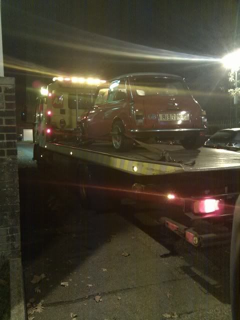

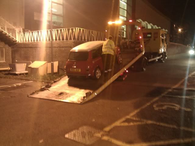

And two pictures, for fun :D
Thanks for reading.
