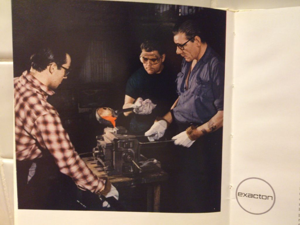

Nice info Steve, I bought this book a while ago.
Its not the most riveting read but there are some pictures of staff which might interest you!

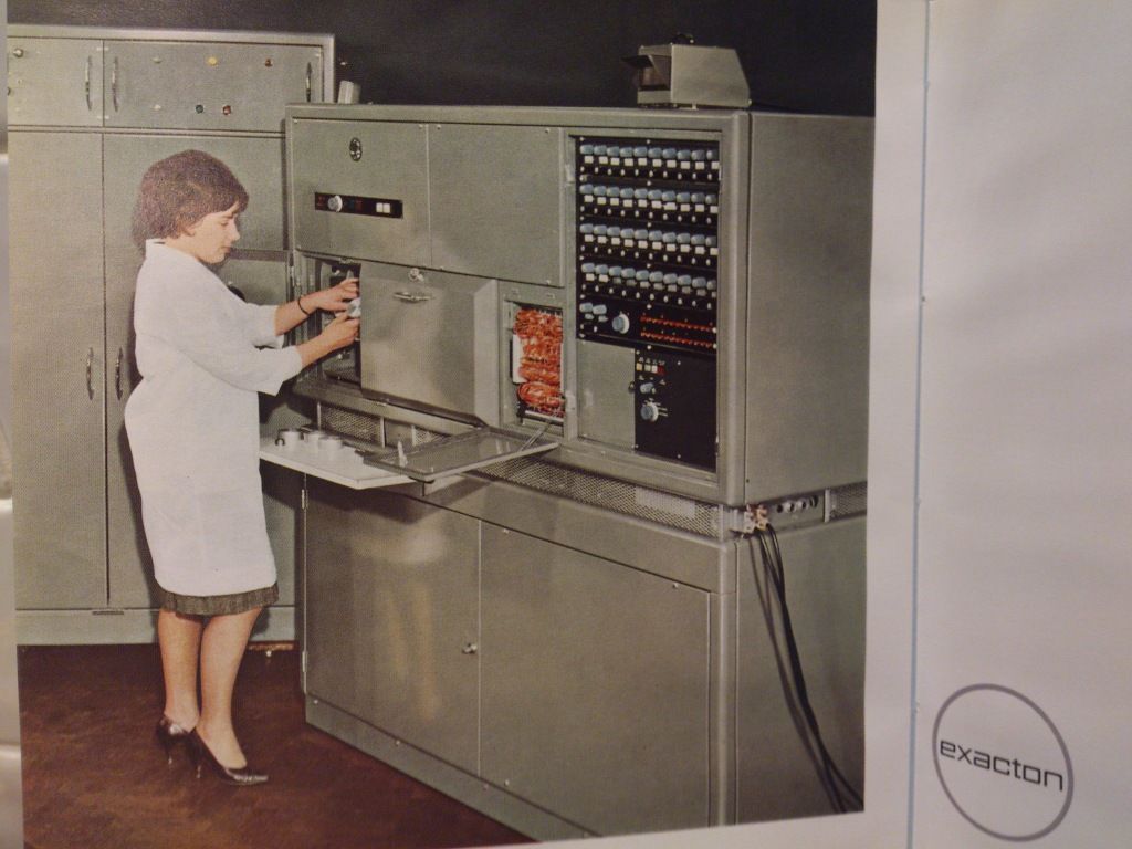

I think this must have been the brew machine :lol:

The metal being cast by the guys isn't aluminium but aluminium bronze, the guy holding the two handles will have tilted the die to allow the metal to flow into the die better. My memory isn't good enough to recall names, but I do recognise them from spending time in the foundry as part of my apprenticeship.
The big coffee maker was a device to measure the exact composition of an alloy for quality purposes by 'arcing' a spark on it and measuring the light emitted (I think).

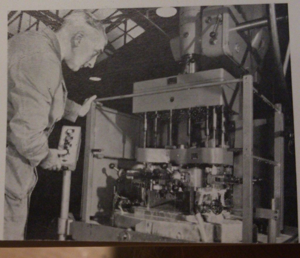

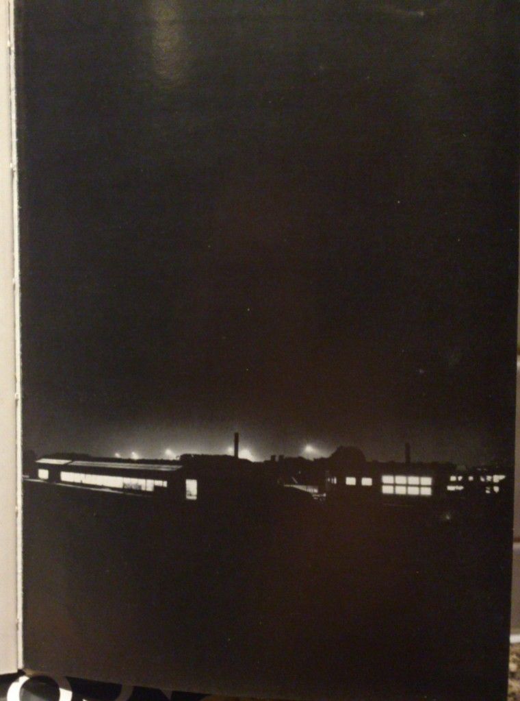

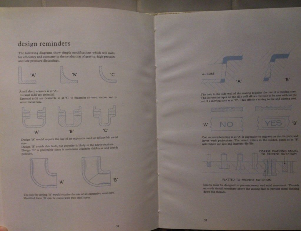

No photos of a drawing office just things like this:
