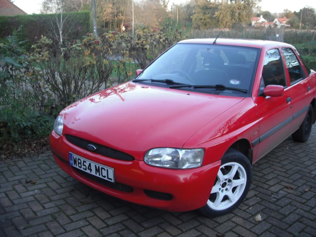

So then guys, thought i would make another project as im doing some work on this at the moment
Shes a 2000 reg Ford escort mk7 which a got for a steal at only £500 with full service history and one family from new :)
ive had her for a few months now but spend nothing on her accept petrol, 2 wiper blades and a wing mirrow :) so cheap running!
deicided she needed sprucing up tho now so got her a set of alloysfor only £35, win

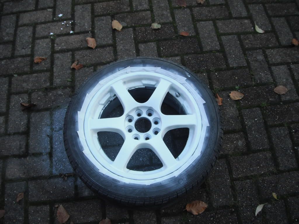

rubbed one down and masked it.
then painted in rustoloum white (left overs from mini) :)

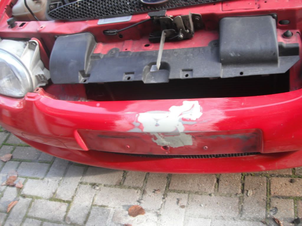

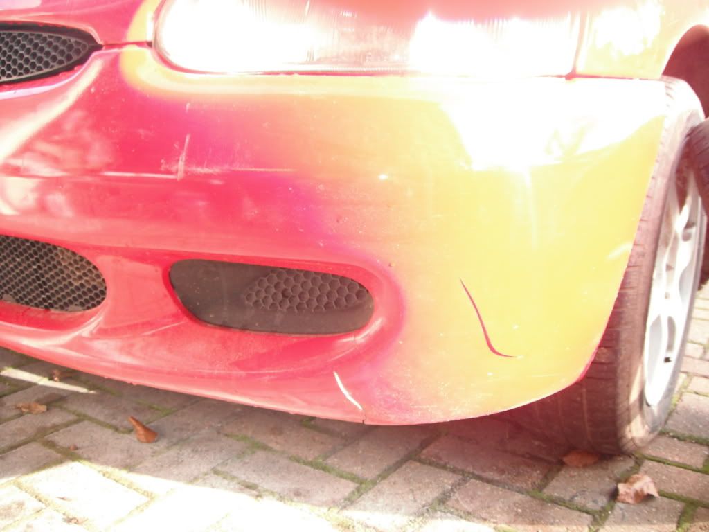

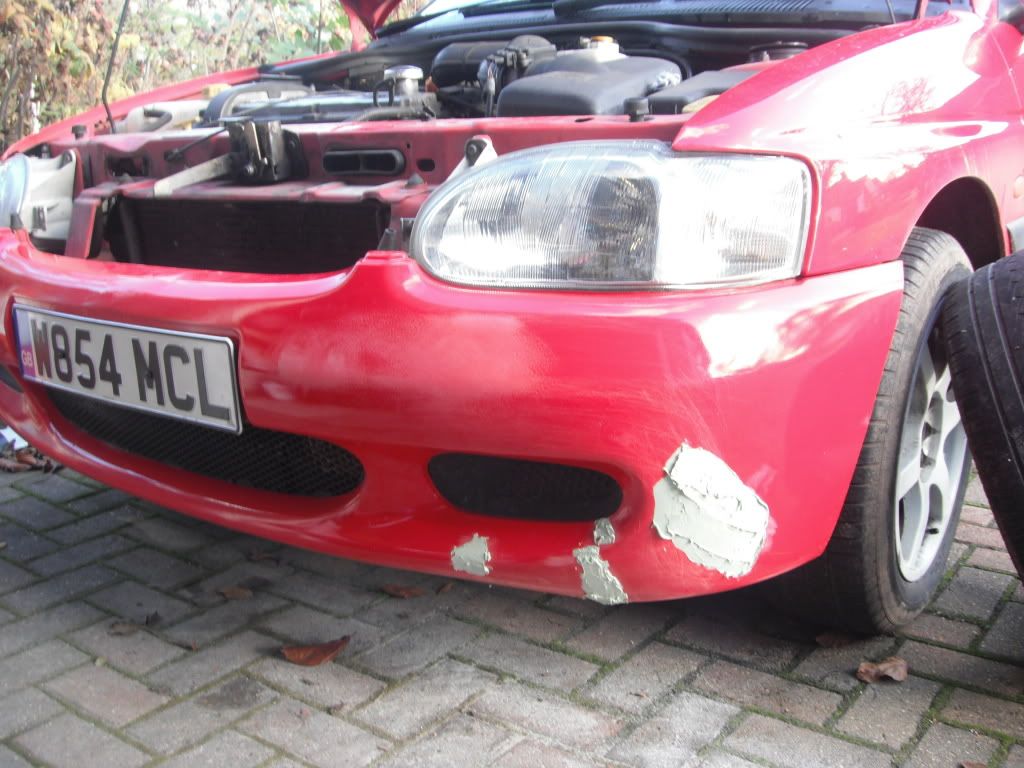

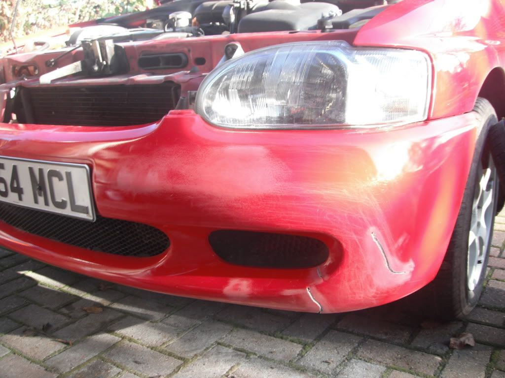

shes had a hole on the front bumper since i had her, something to do with a cricket ball and the previous owner :) well it didnt lok good and let her down :(
so filled and sanded
primed
painted
reassembled with her new pressed plates, looking rather nice now
now todays work
scuffed and cracking in 3 places
cracks veed out
filled
thats all today so far.
hope you guys like my other car :)

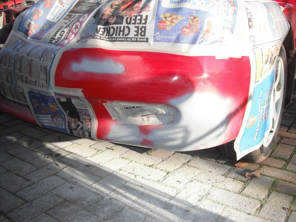

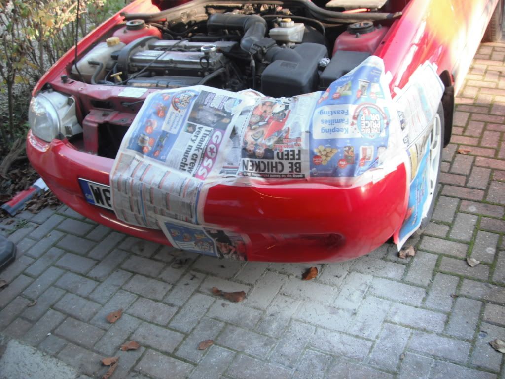

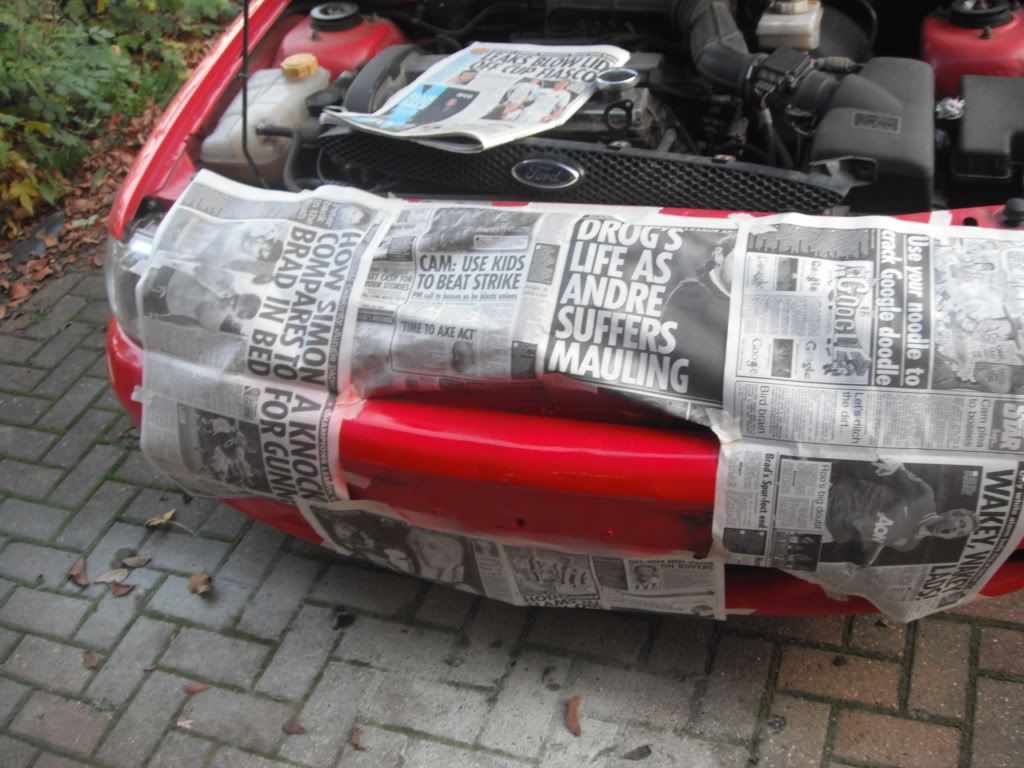

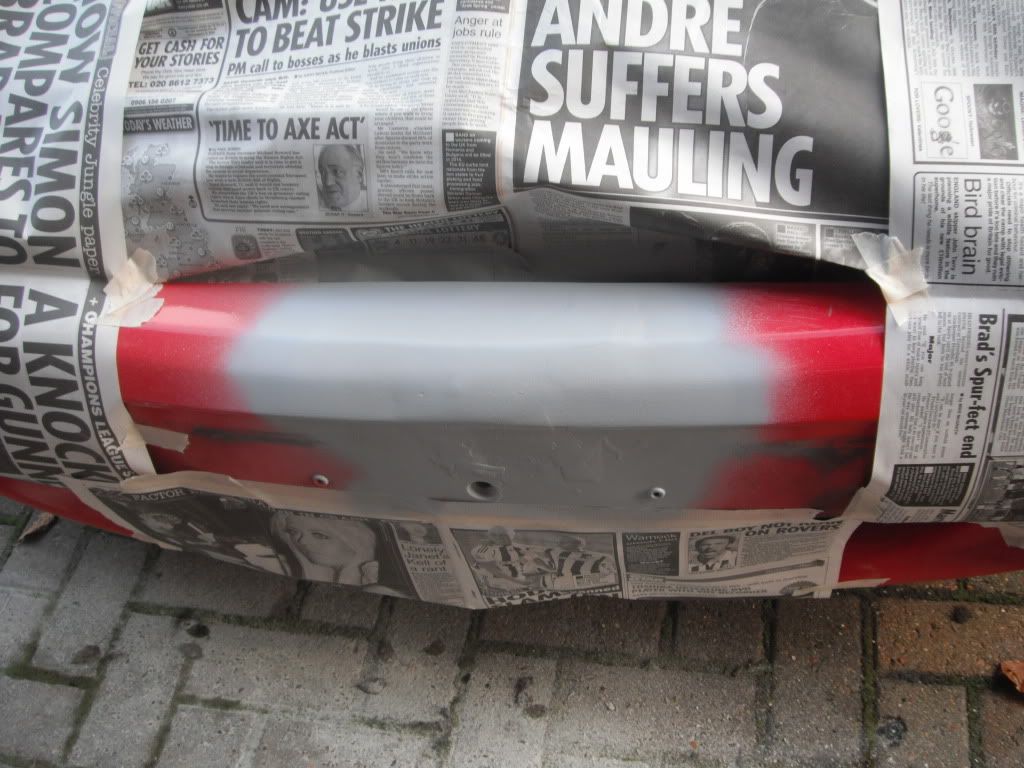

sanded down and primed and masked the front bumper
a few coats off lovely red later

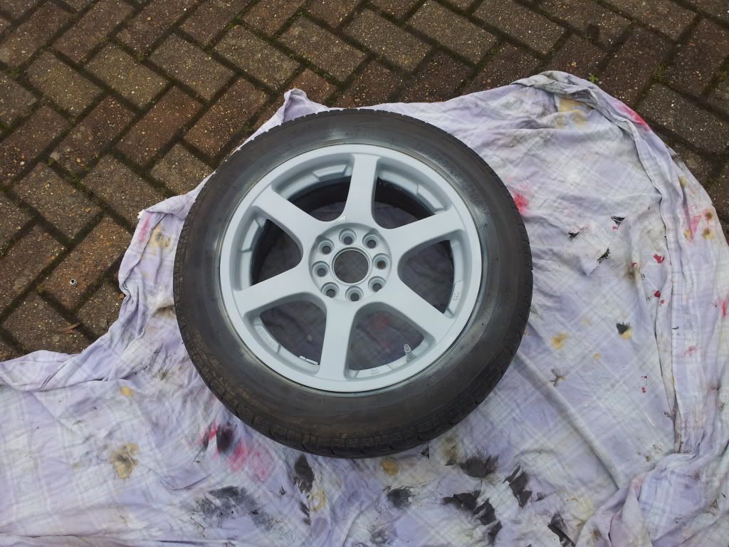

painted another alloy
and the two front aloys are now on and the bumper given a quick polish
looks rather nice now i think :) she still needs a good clean tho! and a bit of lowering and maybe a bonnet bra haha

Posted 25 November 2011 - 04:25 PM
Hi mate, how did you get the cracks out the bumper?
You mentioned 'veed' - but what is it? And what tools do you need?
Got a front bumper I gotta do and just wondering :)
PM me if you want pal, might be easier :D

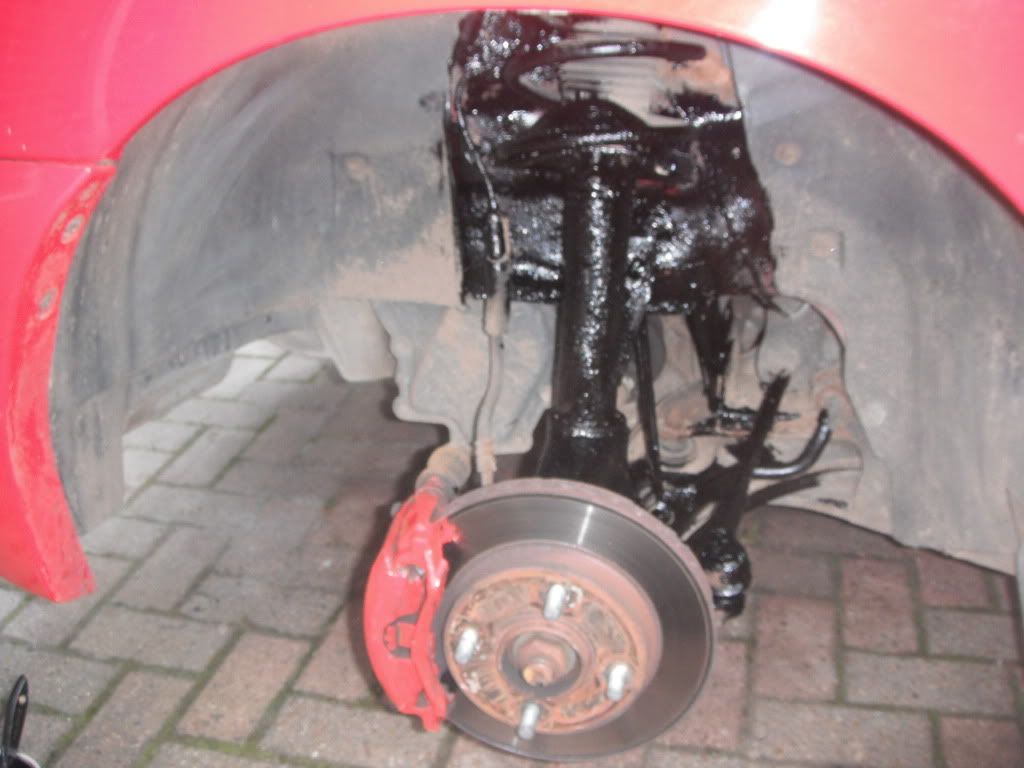

started by wire brushing the front passengers side suspension and painting the calliper red :)

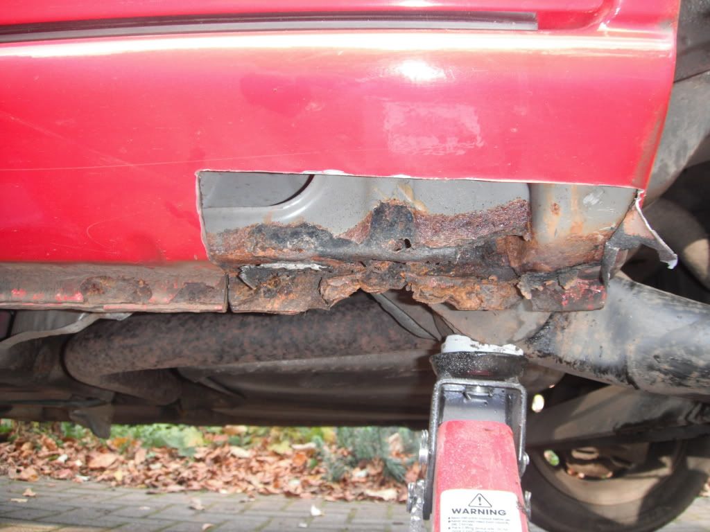

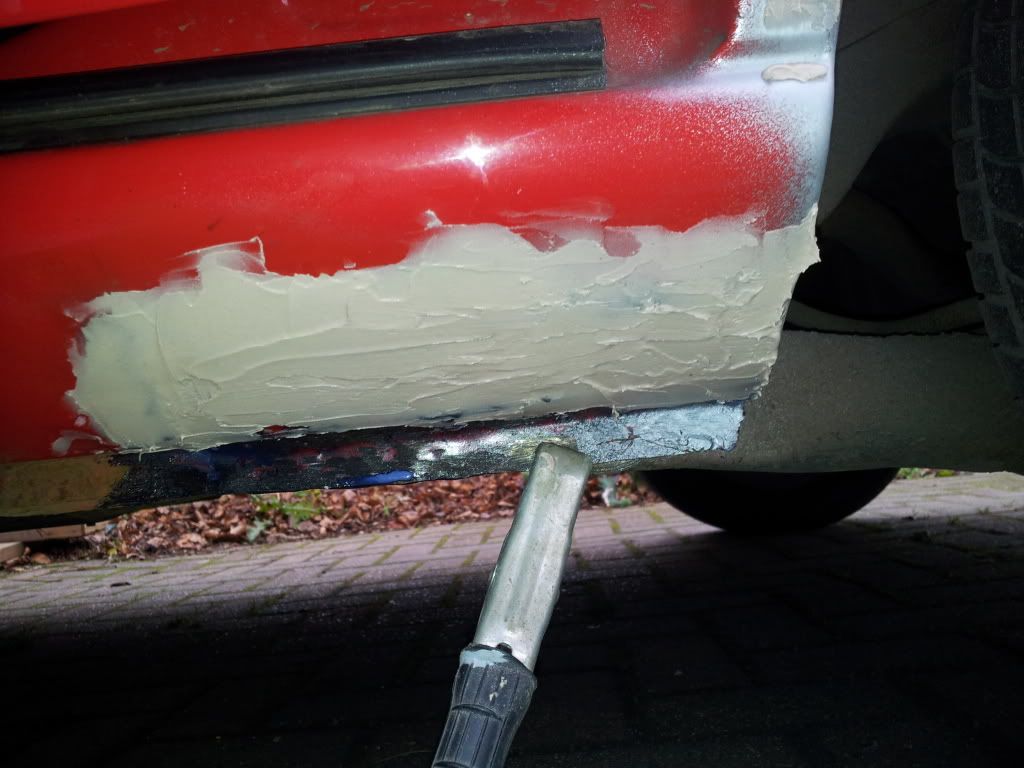

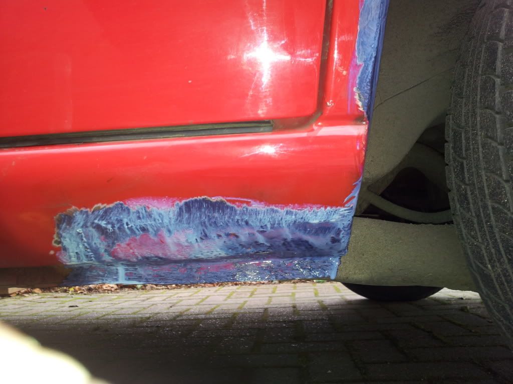

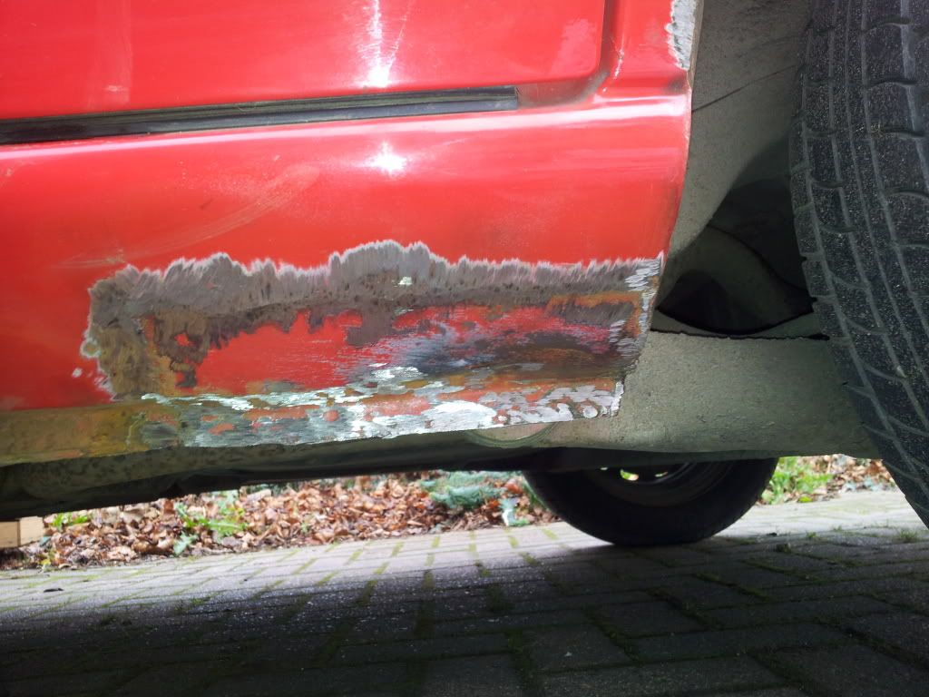

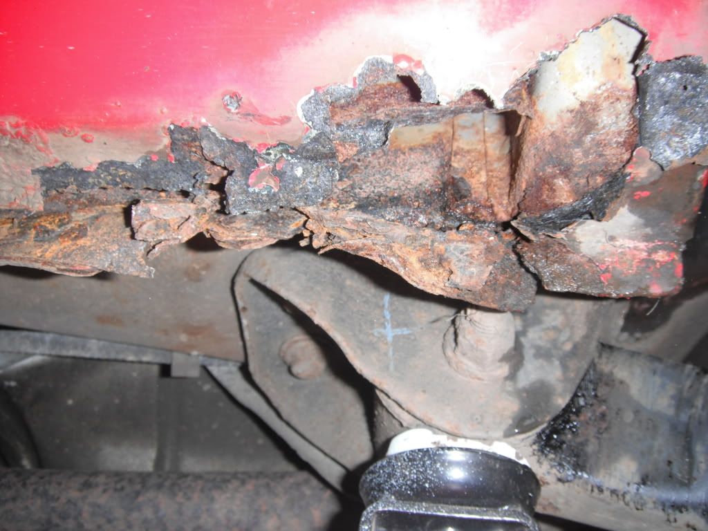

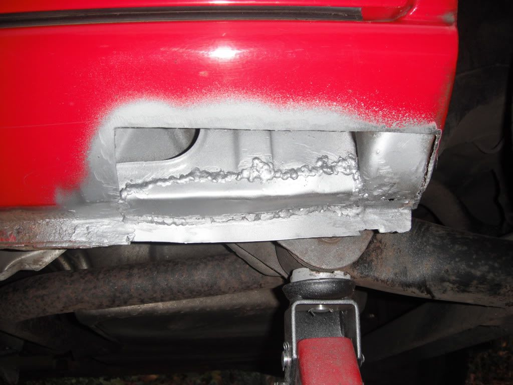

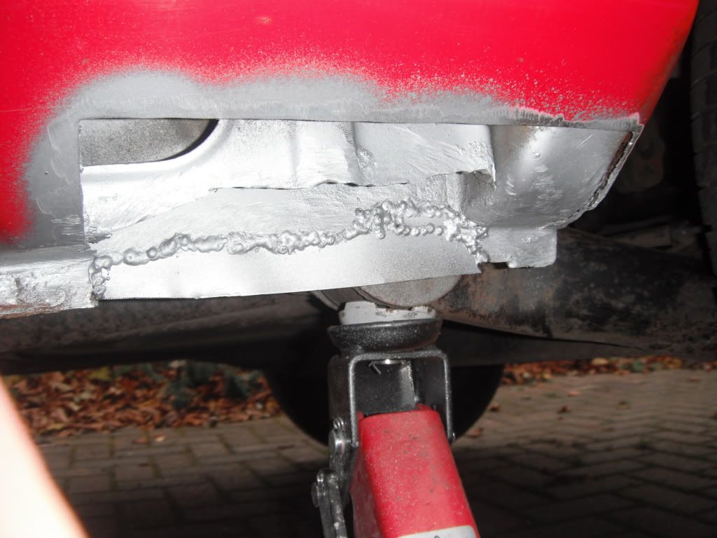

in jacking up to replace the wheel with an alloy there was a lovely crunching sound and the top of the trolley jack dissapeared into the back of the sill :(
it looked only as bad as the front with a few bubbles so i was rather shocked. im not sure if this a mot fail but i wanted it fixed anyways!
so i cut away some of the outer sill to assess the damage fully, and well it was rather crusty :( and looked like alot of work.
i then discovered a was out of gas so slapped some gaffa tape over it to get to town and back :)
then the work began.

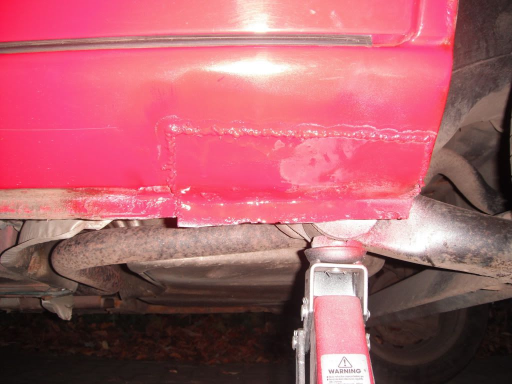

rust cut out and first panel in and welded
second panel made and welded, i have no idea how it was originally as it was all holey haha so i welded it a strong as i can
third panel made, with some added plugs to try and strenthen the area
and welded in and painted.
Its not perfect i know but this is my run aroundand its protected for now. It needs work round the arch lip anyways so i will finish of the work sometime next week. hope you like this update. shame i couldnt do any work on mini today tho :(

#8 Artful Dodger
Artful Dodger
    " I AM THE SPECIAL ONE"
  • 4,435 posts
Posted 29 November 2011 - 09:31 PM
thats going to be a big fat MOT failure..... :(
rust hole within 30 cm spherically of a suspension part.
#9 lawrence
lawrence
  • 1,340 posts
Posted 29 November 2011 - 11:19 PM
yh thats what i though too! :( its all fixed now so its fine :) just needs a little grinding down and a light skim of filler and noone will tell its been done. jobs a good un.
#10 Artful Dodger
Artful Dodger
  • 4,435 posts
Posted 30 November 2011 - 07:45 PM
good man :) looks like a good job well done, shouldnt have any issues with that repair come MOT time!
#11 M J W J
M J W J
  • 976 posts
  • Location: Midlands
  • Local Club: not yet
Posted 04 December 2011 - 08:12 PM
They are notorious for rusting around the rear suspension mounts (bit you've repaired) and chassis rails. Mine failed the mot on these.

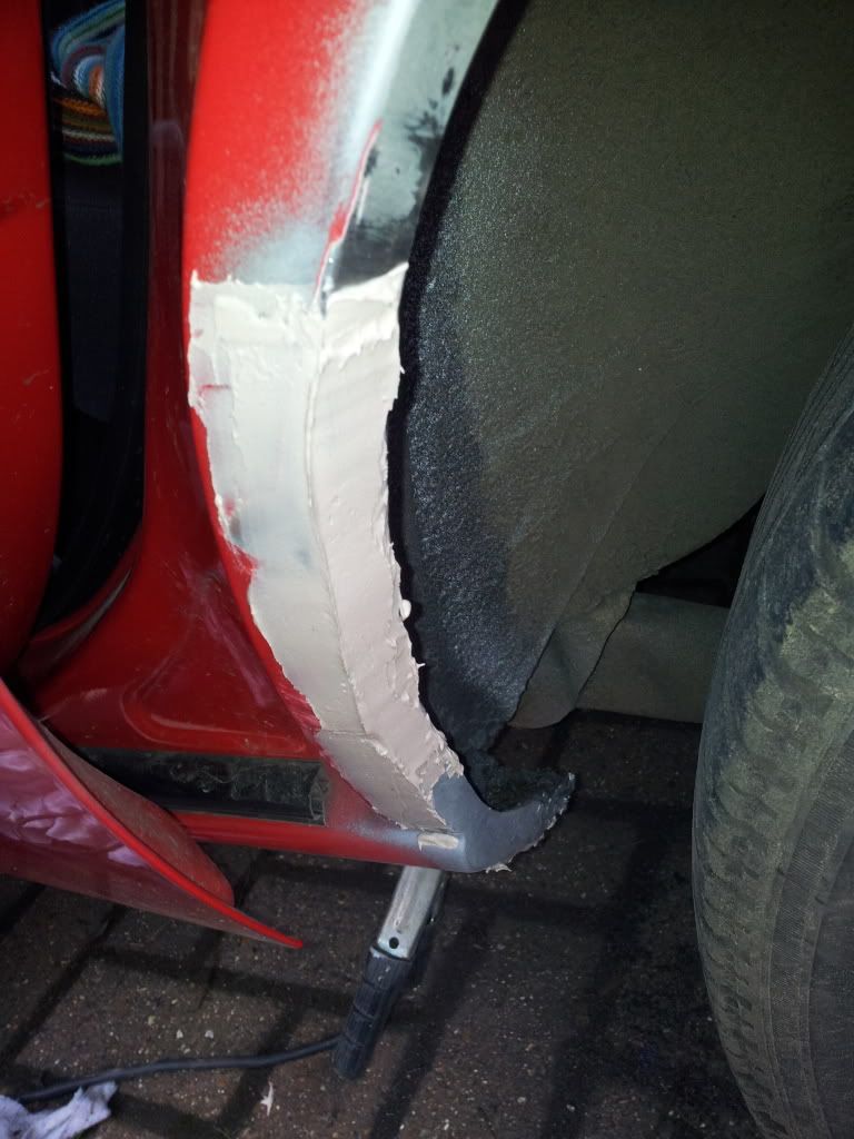

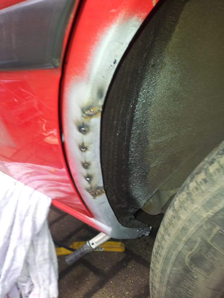

first on todays agenda:

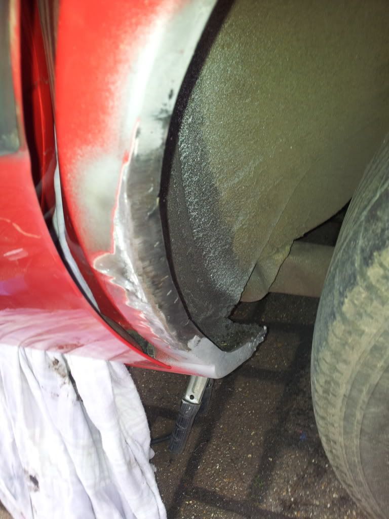

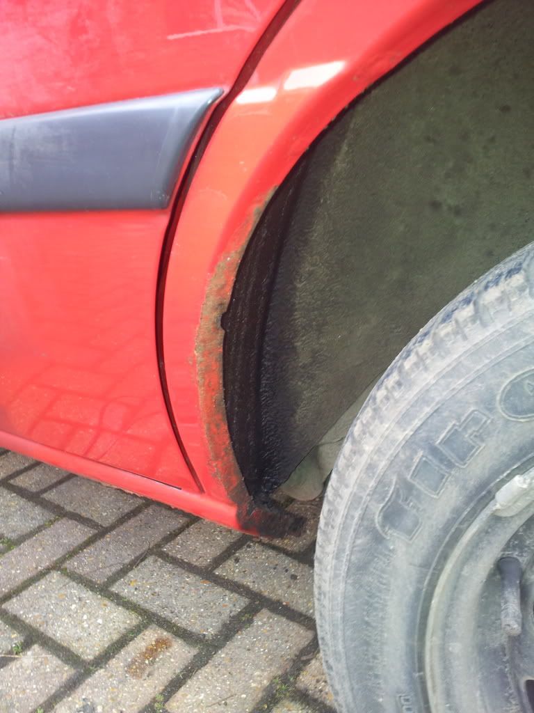

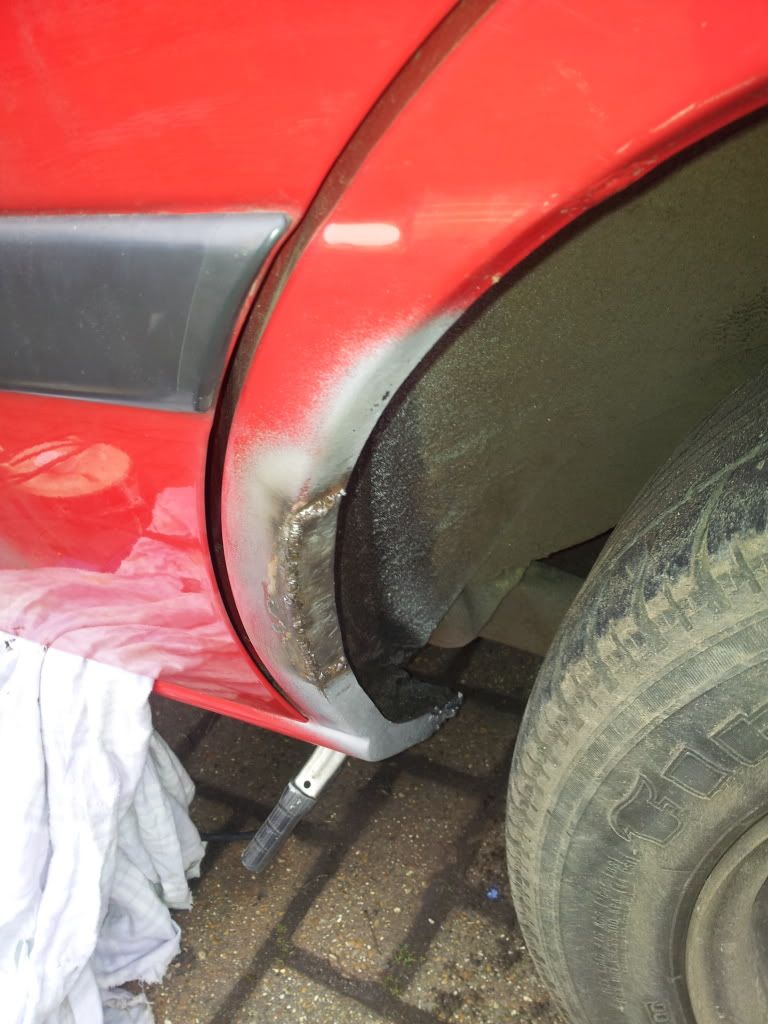

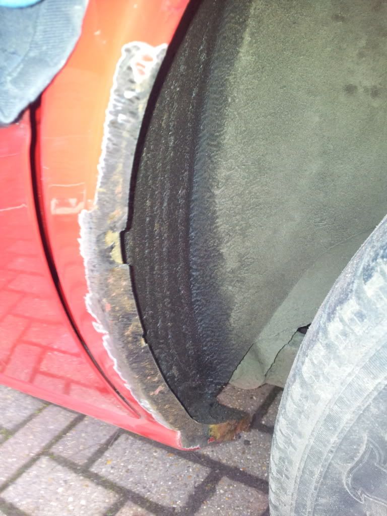

the rusty front of the passengers side rear arch---- i hamerited it a while ago but i was bugging me because its rusty
as it was

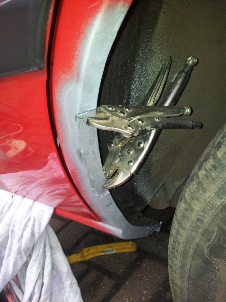

rust ground back, it wasnt too bad, needed some new metal tho
krusted the lip and then zinc primed it, made a new panel to replace the rusty old one
tacked it in
welded it up
ground it all back
skim of filler as this area is in view

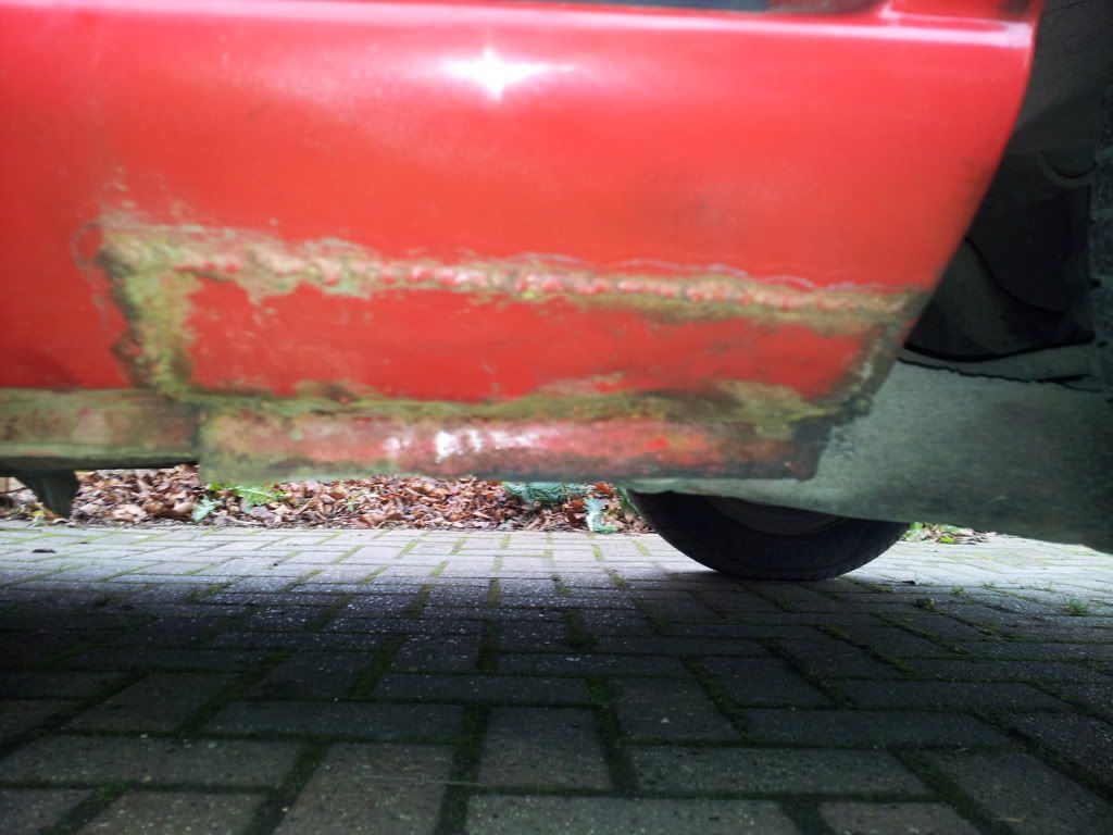

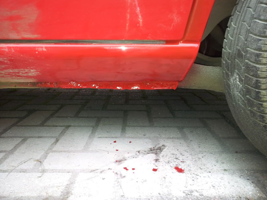

whilst the filler was drying i had a look at the sill repair i did in november, i didnt leave it in the best of ways and just sprayed red over the metal so its a bit rusty again :(
ground back all the welds and rustyness
krusted the patch
filled
primed and painted

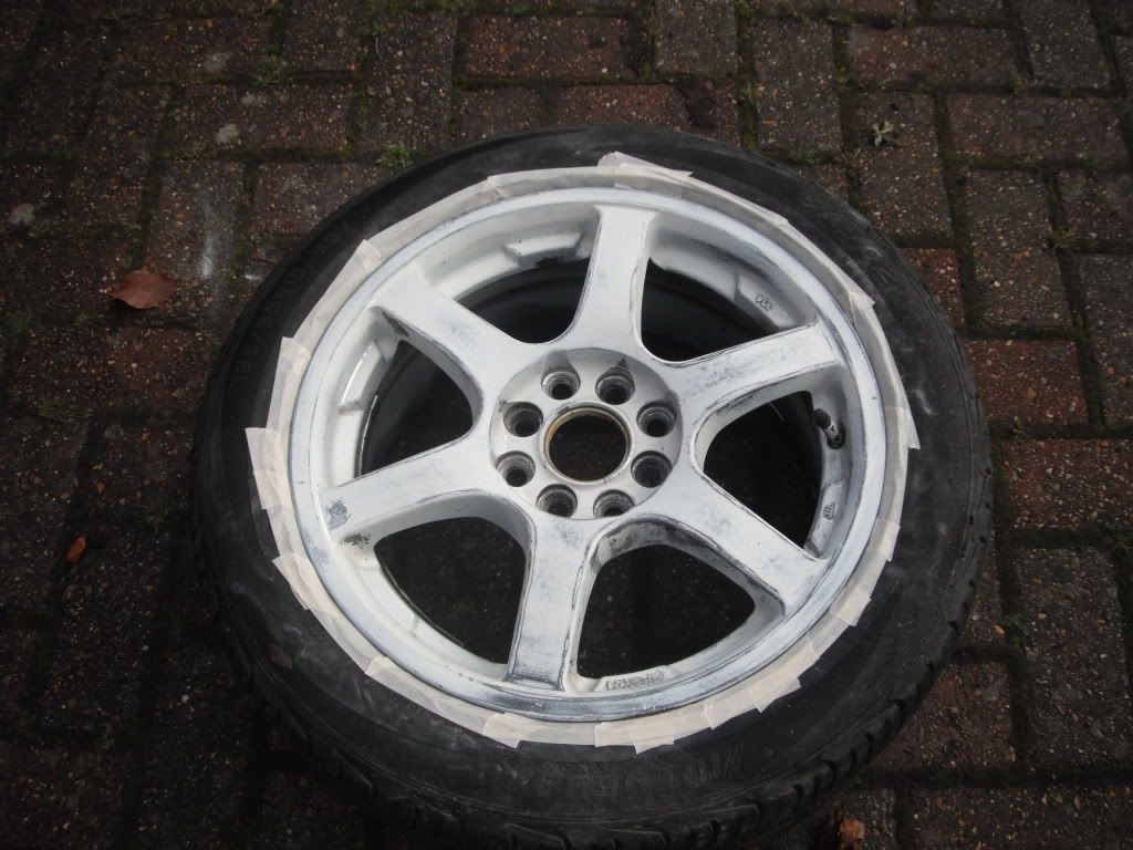

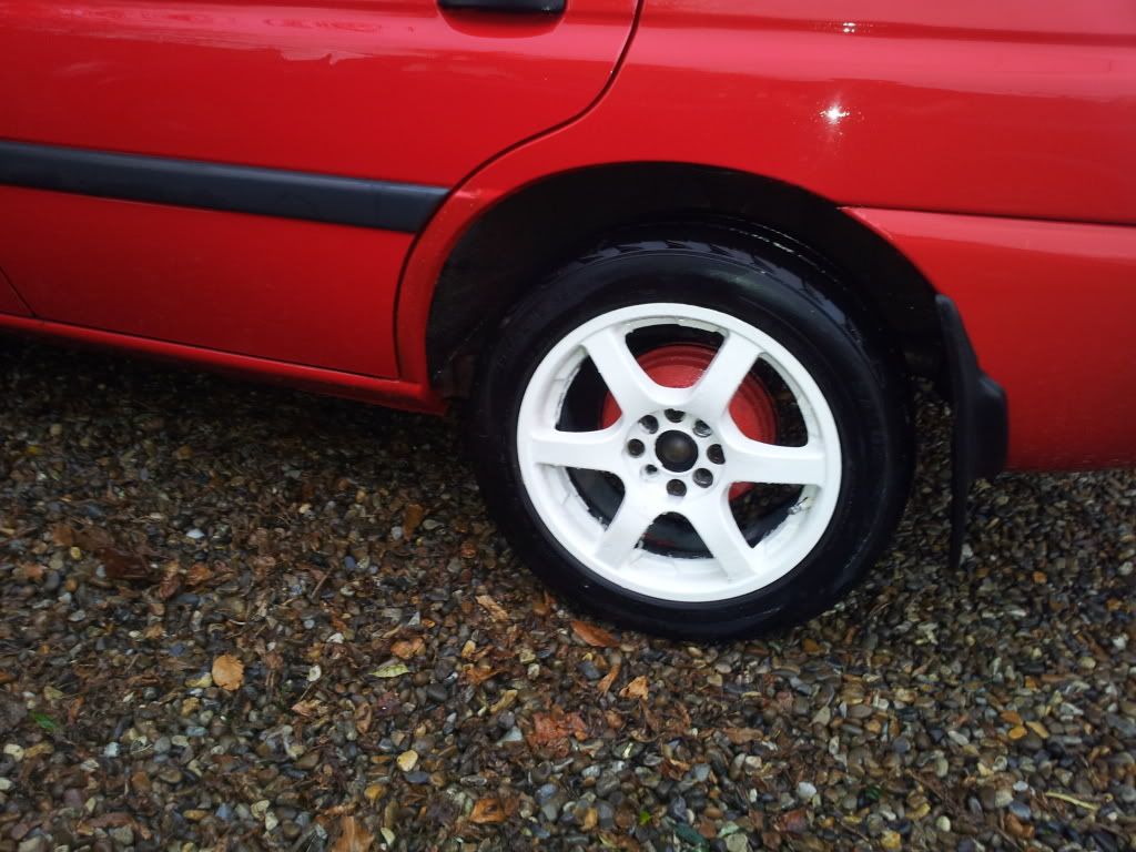

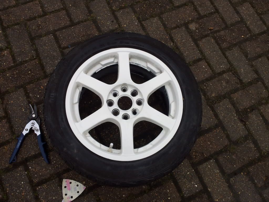

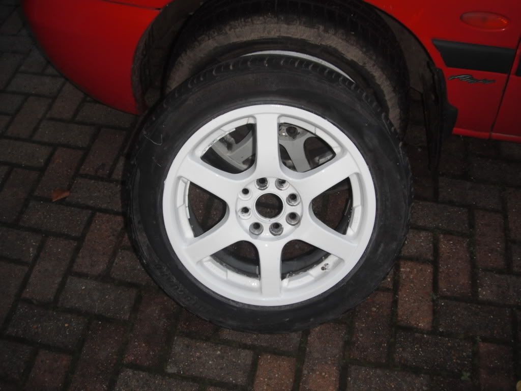

then made a start on the last alloy to paint
primed
painted,
it was then fitted once dry, the brake drum was hemerited red of it would let the car down! :0

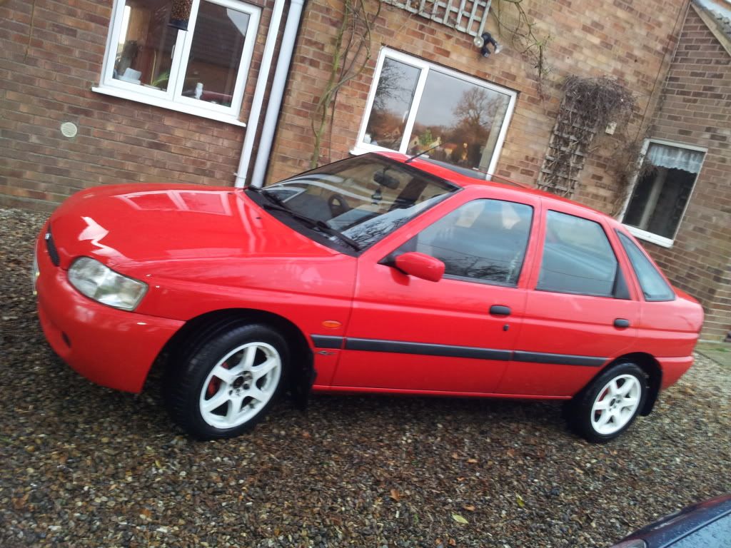

and an overall picture of todays work, doesnt look like much but its made me a bit happier knowing this side is finished and all looking nice n tidy
and an overall shot of the car in all her glory, just need to sort the stone chips on the front bumper and bonnet now
