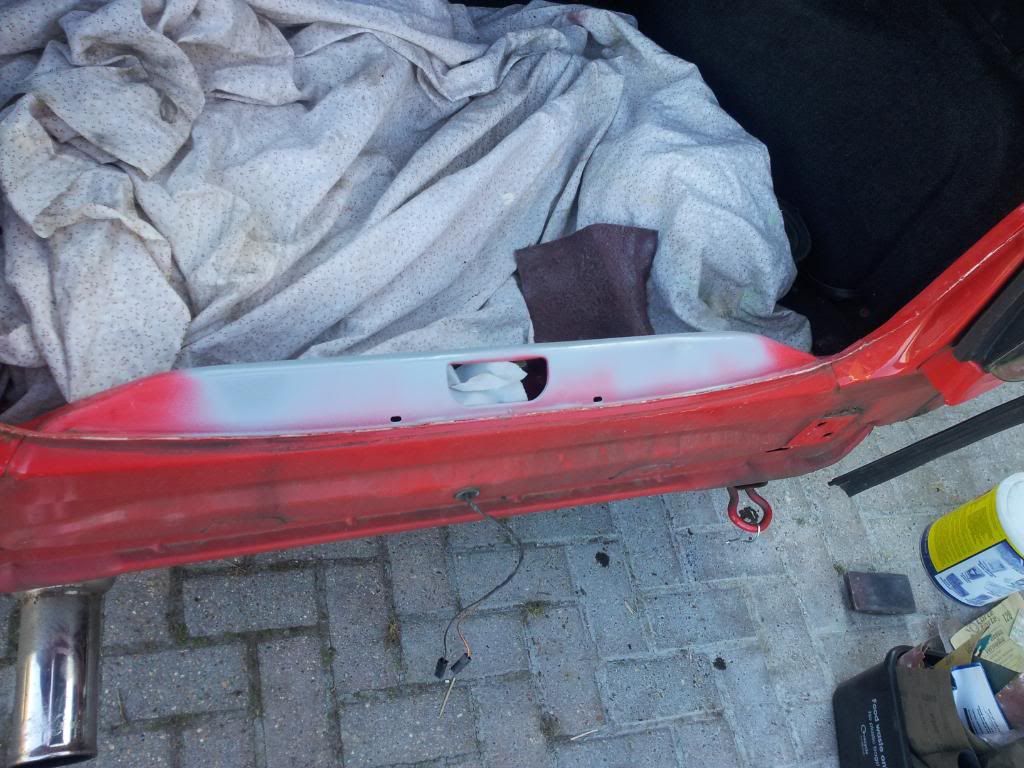

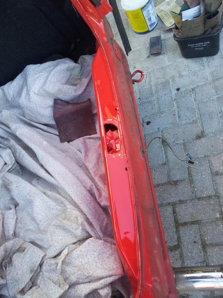

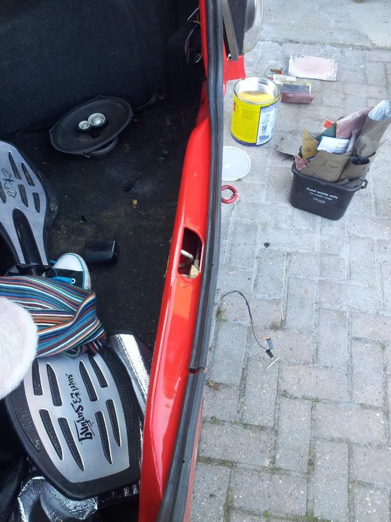

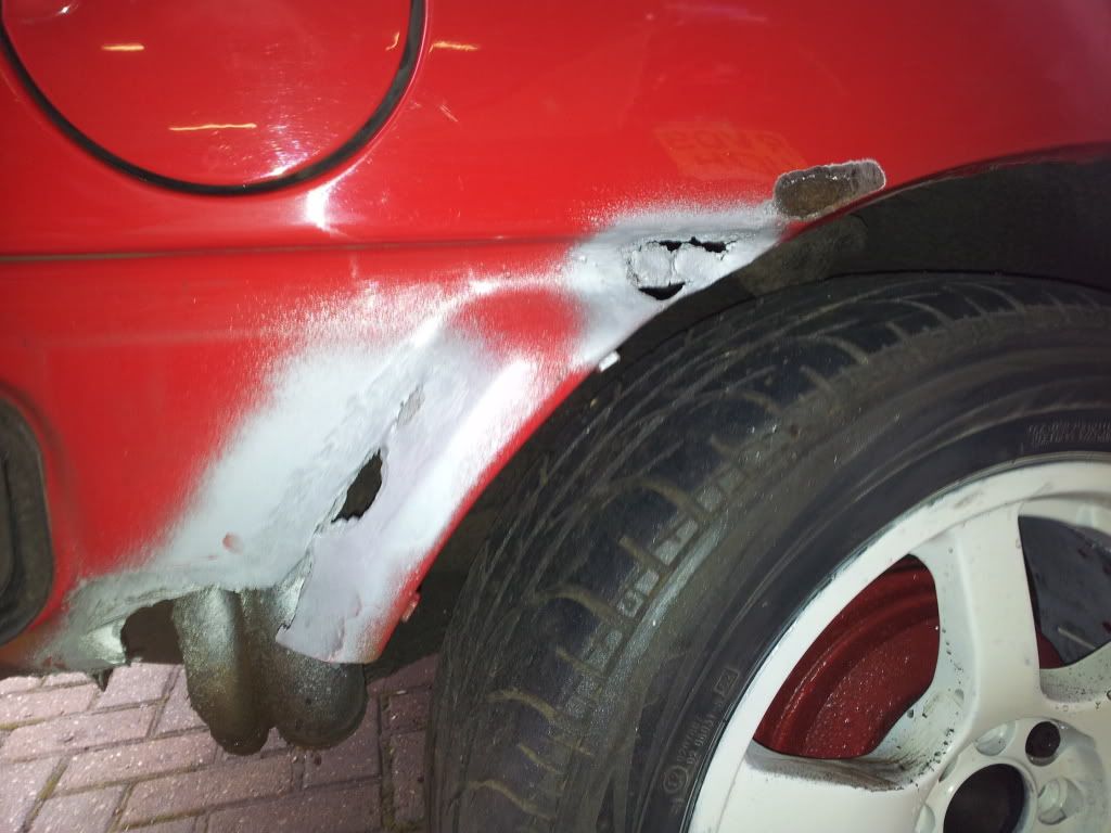

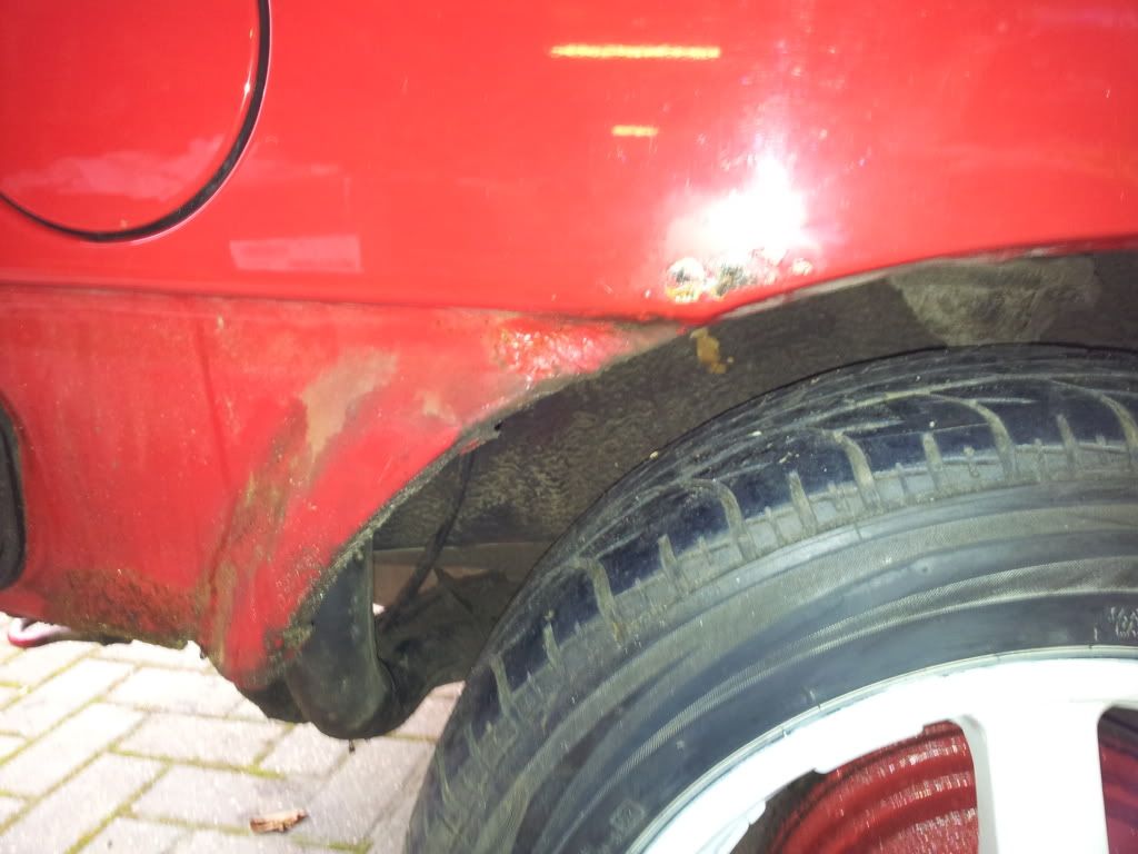

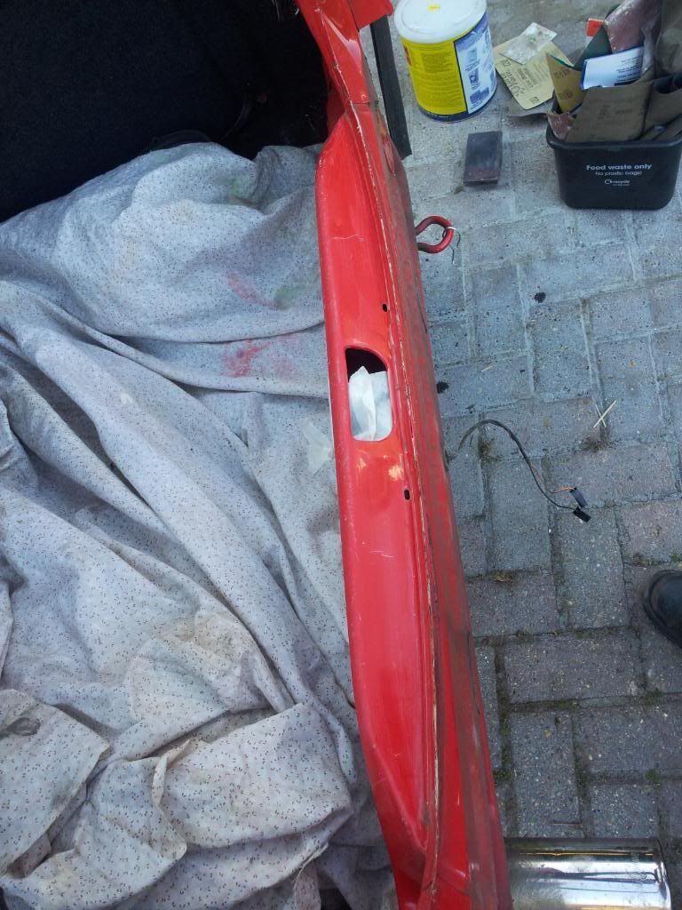

So there was a little more work for me to do today, as i was looking around the car looking for spots that needed fixing i came across a few horrible rust bubbles on the rear of the drivers side arch, so i removed the rear bumper to get a better look at the rusty spots
ground back all the surface rust and its made a few lovely holes that now need patching
holes ground back and zinc primered

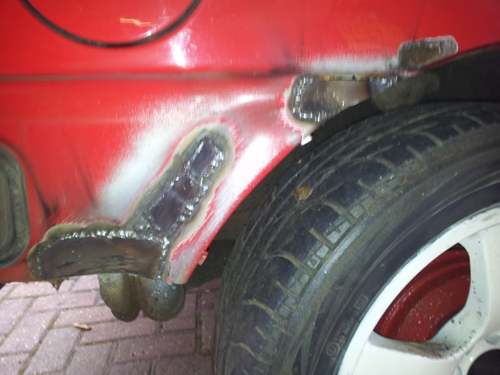

patches welded on to strengthen the bumper mounting area and the rusty area i spotted earlier krusted
primered the patches and filled the hole
filler rubbed back
and a few coats of primer put on
ive had to put the bumper back on as this is my daily car and it got too dark to work on her. ill make another update when i next have time to finish it

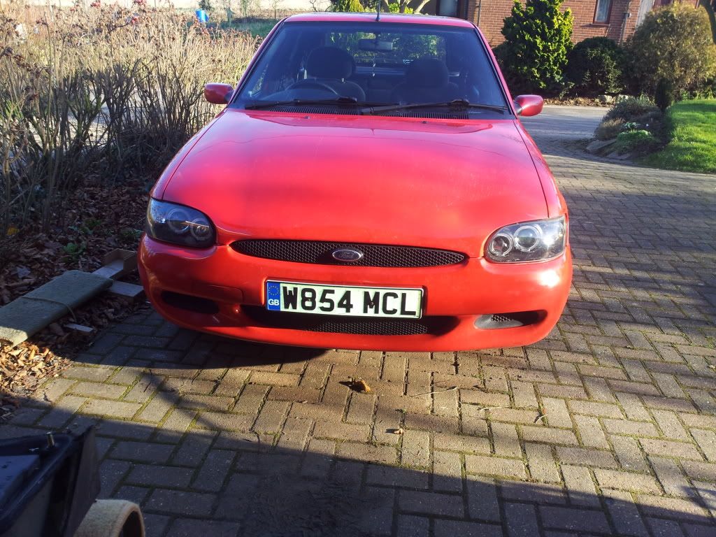

today i got some new front and rear light for her, £40 so a complete bargain! :)
fronts, black projecter style with angel eyes
rears, lexus style, not so nice but match the front ok
and the angel eyes at night
not sure whats next for this, still needs some painting on the rear quater and then ill have a think. hope you like

and i know what you mean olds_kool_lews, it wasnt my best welding, had to do a bit of a lap weld for one of the inner skins which i dont like doing really, turned out not so bad in the end, need to do the other side soon tho as the rusty arch lets it down big time!

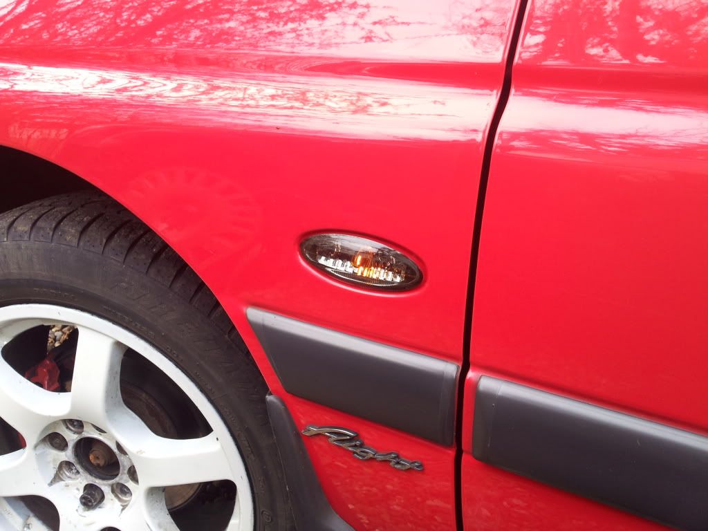

tiny update from yesterday tho
from this
to this
think it finished off the look for now

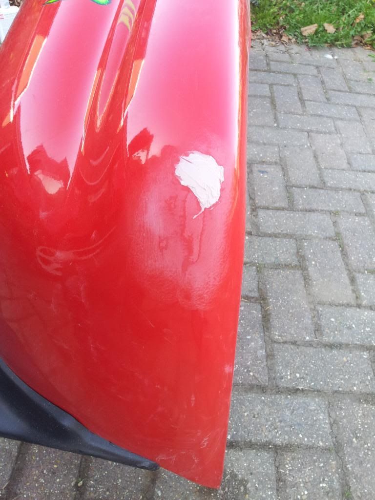

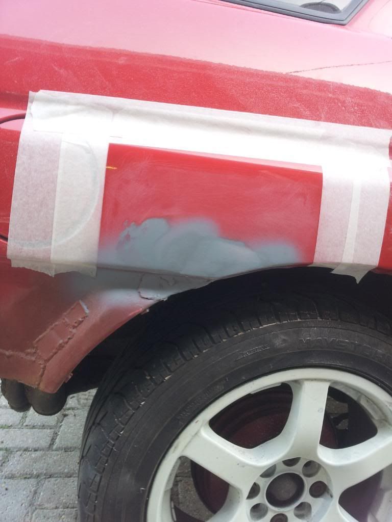

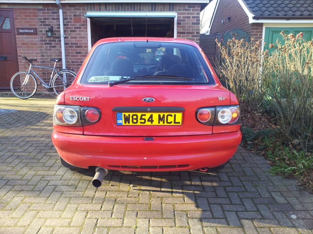

so then, i havent done any work on this since the last update until i got hit slightly at my work car park on the back bumper, slighly annoying!

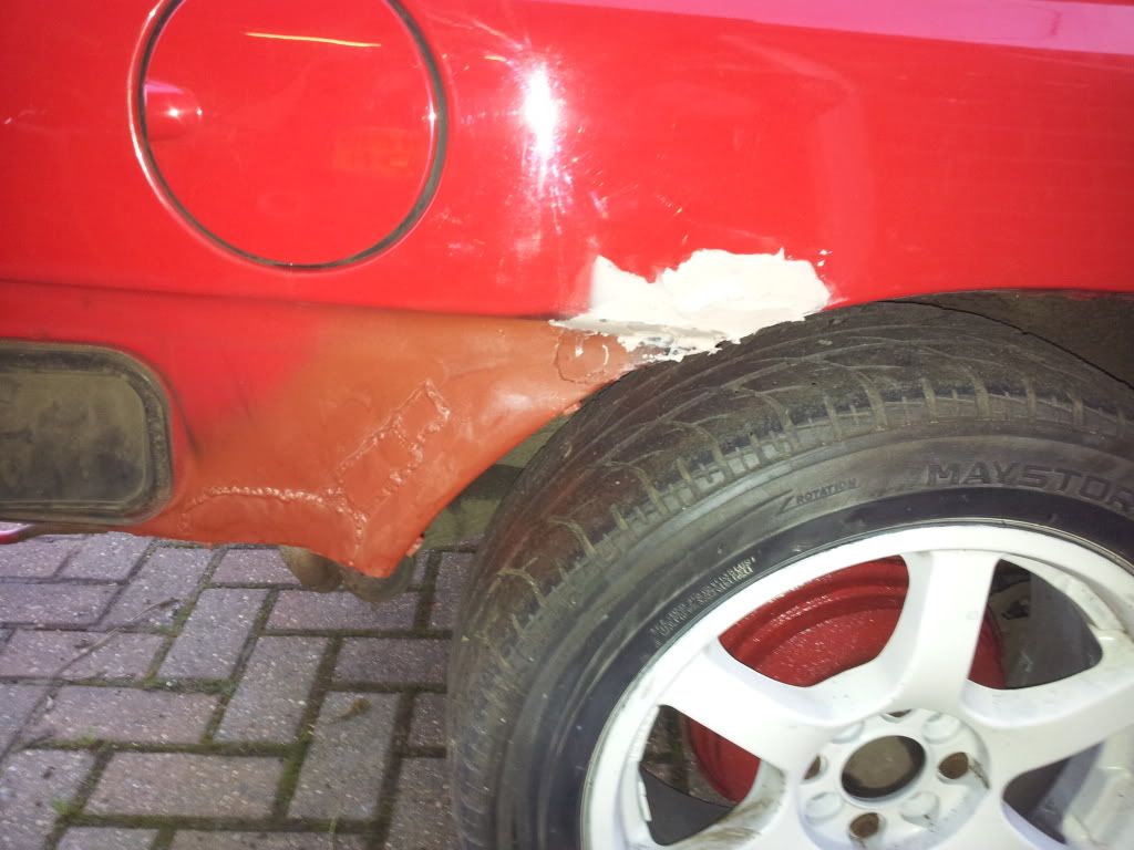

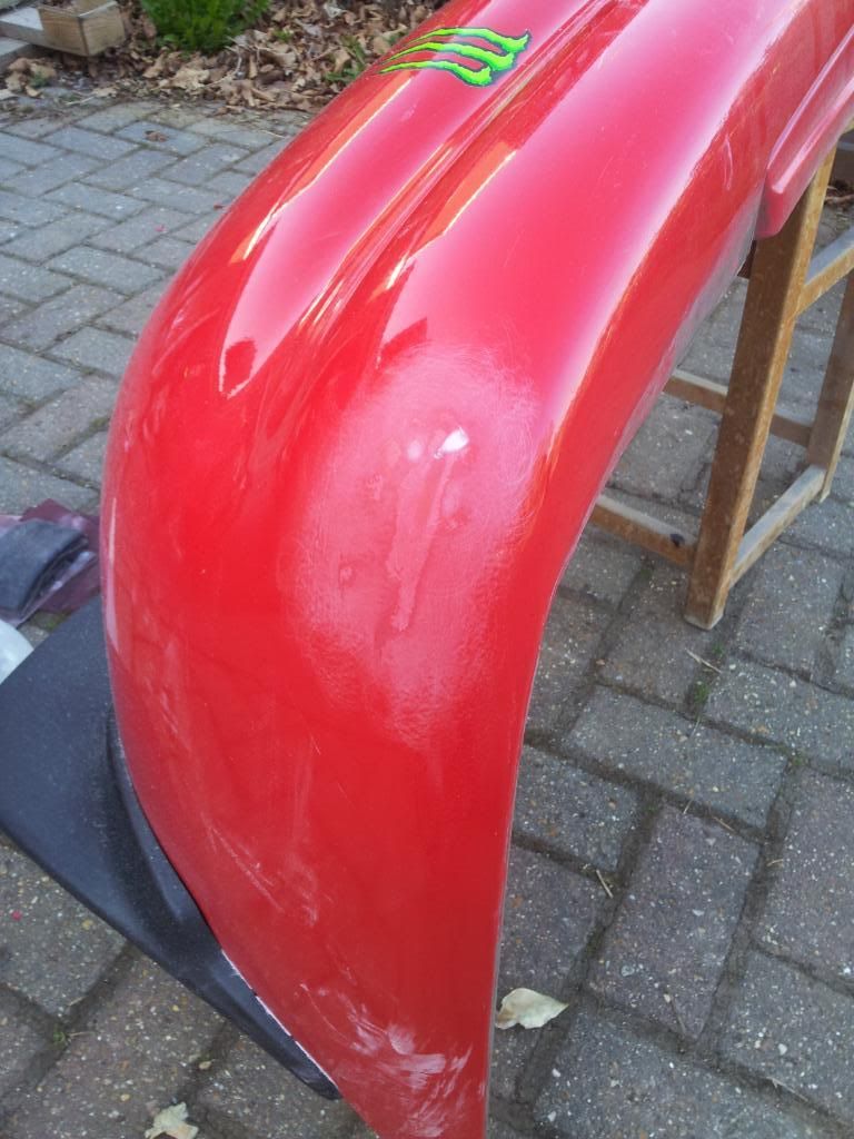

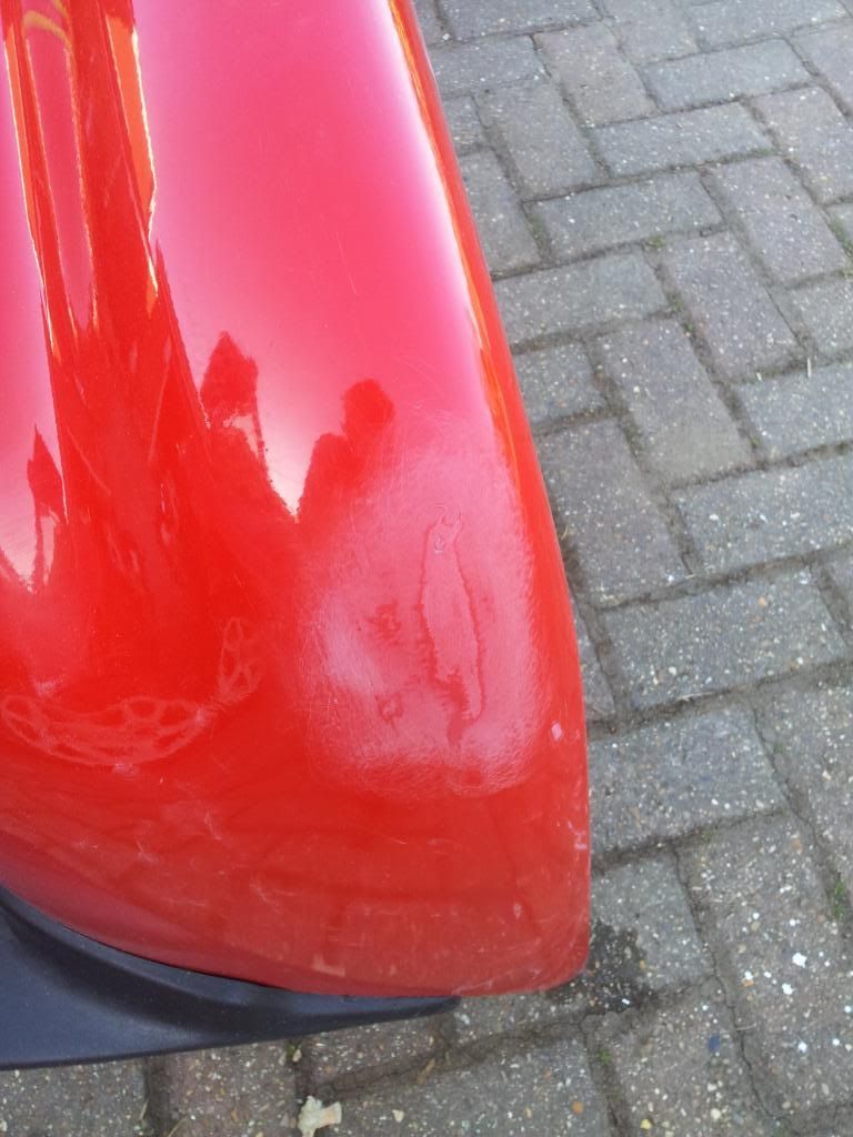

dent and scrape sanded down so make it smooth
dent filled in and light scratches too
all re flatted back again

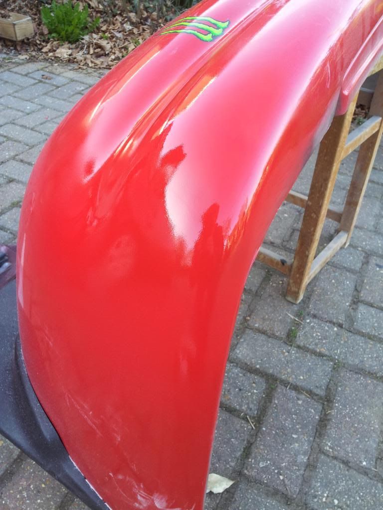

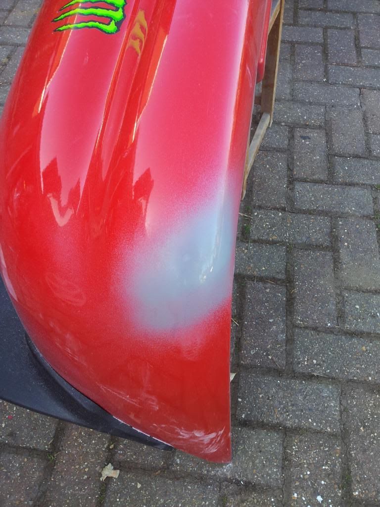

little schooch of primer
and a few coats of paint, done a pretty good job i think :)
i then had a walk around my car looking for bits i didnt like
i noticed loads of scratches on the boot hinge panel with some going rusty, my surfing probabley doesnt help haha
so i rubbed it down, primered and then flatted it back
added a few layers of paint
and put stuff back on the car, looking nice and shiny now again :)

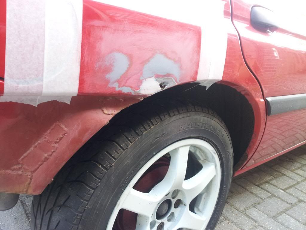

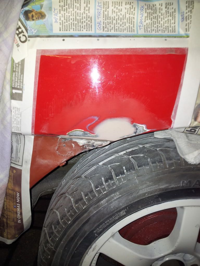

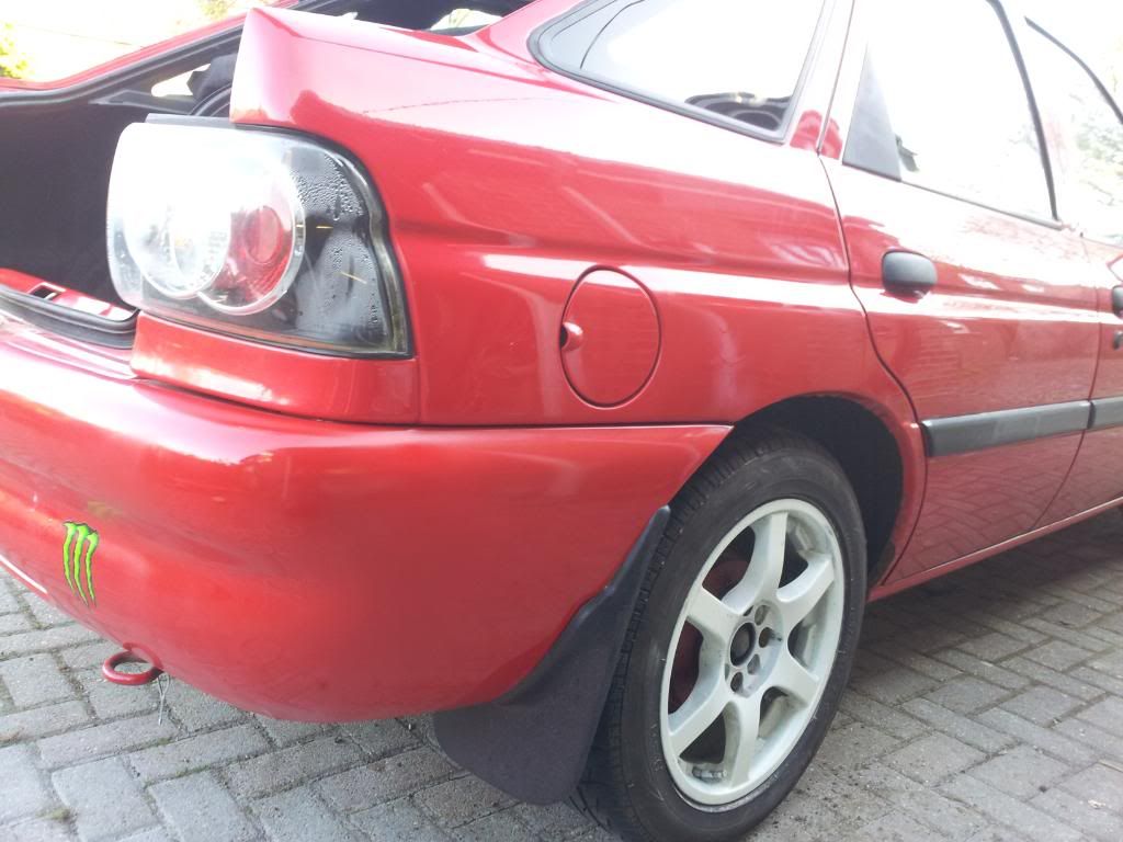

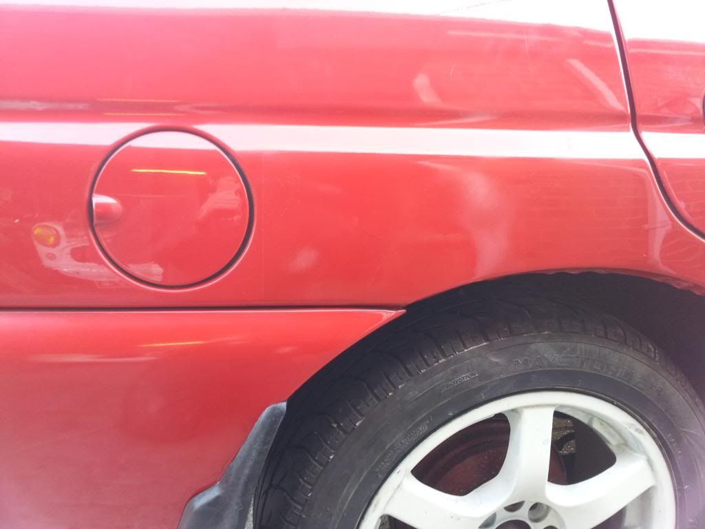

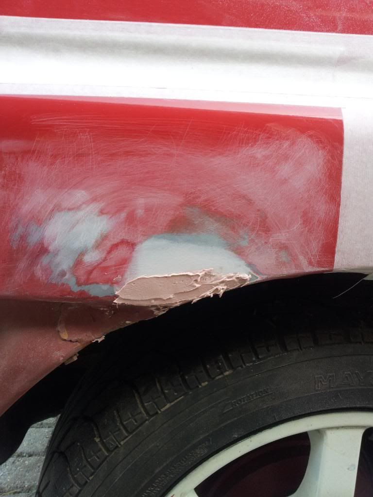

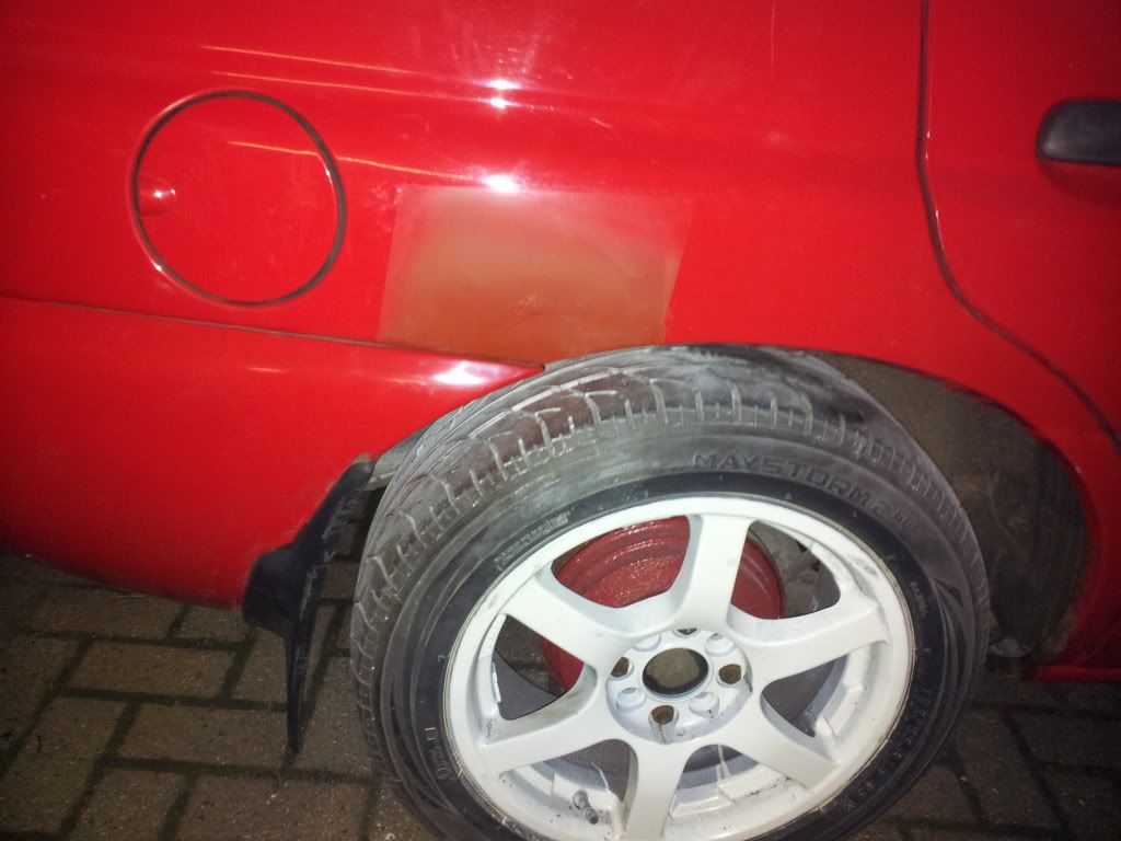

i also noticed the repair that i did on the rear wheel arch had gone bad, probably due to respraying it in the cold!
so i flatted back the paint and as you can see there is a slight hole haha
refilled the hole
flatted back and primered up
and resprayed
nice and shiny
all my repairs looking nice and invisible making the car look more loved!
hope you like these little running repairs :) 10pts if you can spot my mini in any pictures!
Lawrence
