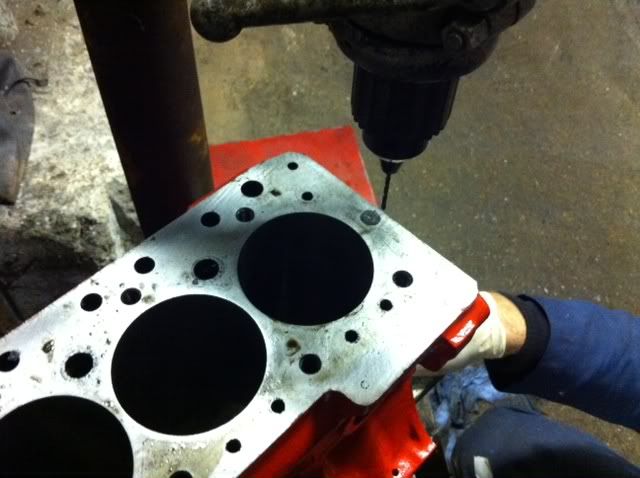

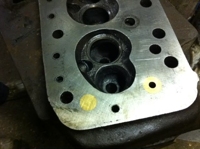

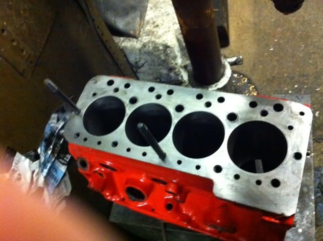

well, looks like im sorted! thanks for all the help!
sounds like il just be drilling 2 more holes for normal studs then, no issues there!
#18 Artful Dodger
Artful Dodger
    " I AM THE SPECIAL ONE"
  • 4,435 posts
Posted 15 December 2011 - 09:32 PM
did it 8) i must say, it went very well. drilled head with a 1/8 pilot, 7, then a 10mm, block with an 1/8 pilot then an 8mm. tapped 3/8 UNC and it fits amazingly well. didnt go through the water jacket :D im one very happy person!
cheers guys!

The reason BMC used a smaller diameter bolt at the waterpump end is the reduced thickness of the casting there, and the proximity to the edge. Don't be surprised if the block cracks there if you put full torque on your completely unecessary stud there!
#23 samsfern
samsfern
  • 5,243 posts
  • Location: Ringwold, kent
Posted 15 December 2011 - 11:31 PM
I always do them to 55ft/lbs and never had a problem. Also most performance engine builders use the normal size studs for the extra two.
#24 Pigeonto
Pigeonto
  • 973 posts
  • Location: Nr Colchester Essex
  • Local Club: ISMOC
Posted 16 December 2011 - 09:01 AM
Any one get the impession that Mr bmc doesnt have these 2 on his engines!!? I keep to 45 ft lbs on all but I did a mate's Turbo one the other day and left him to fit it saying to do them 45 "that's 45 more than you would have had without them" and guess what, yup he did 55. Well he was peed off at blowing the gasket when at the rolling road session and was doing all he could.I grimmaced at the thought but well we'll see.Roy may have the last word, that w/pump one is the worry,and its beside the w/pump bolt hole drilling at right angles to it as well. Interestingly Keith calver says to do the 2 extras to 25.
