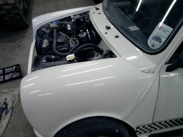

If you keep the inner wings you dont have to worry about any of these IVA/SVA tests! Ive done pretty much the same as racingbob and permanently fixed my fibreglass front, its rivited in place and dosnt flip. Ill put up a few pics to show how its done:
You can see the inner wings here:
How it looks from the outside:
Does chip easily though >_<
