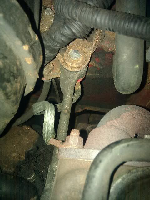

Ruckus:
1. Yeah, I do have resistor spark plugs.
2. I could only find one engine earthing strap, but it looks alright to me:
3. I've got a picture here of the connections to the alt, and I'm pretty sure the singular one is the earth strap, if I'm correct? Also, do I need to disconnect both of these and then run the car briefly? Just wanted to check and be safe :)
Thanks,
Simon.

Yes you can disconnect both cables, but you only really need to remove the big one.
The big one carrys the power to the Solonid > battery.
The little one is the switch on trigger switch for the alt.
Disconnect the + on the battery before the cable on the Alt.
Once the alt cable is un-bolted be sure to wrap it in something to insulate it as it will be live when you re connect the battery to start the car.

Right, just tried it without the alternator plugged in, and I still got the popping noise.
You might be right TAD2DMAC. I'll need to check the radio ground. I thought that it was already wired into the plug, but since it did the same thing with the previous headunit, I might have thought wrongly?
