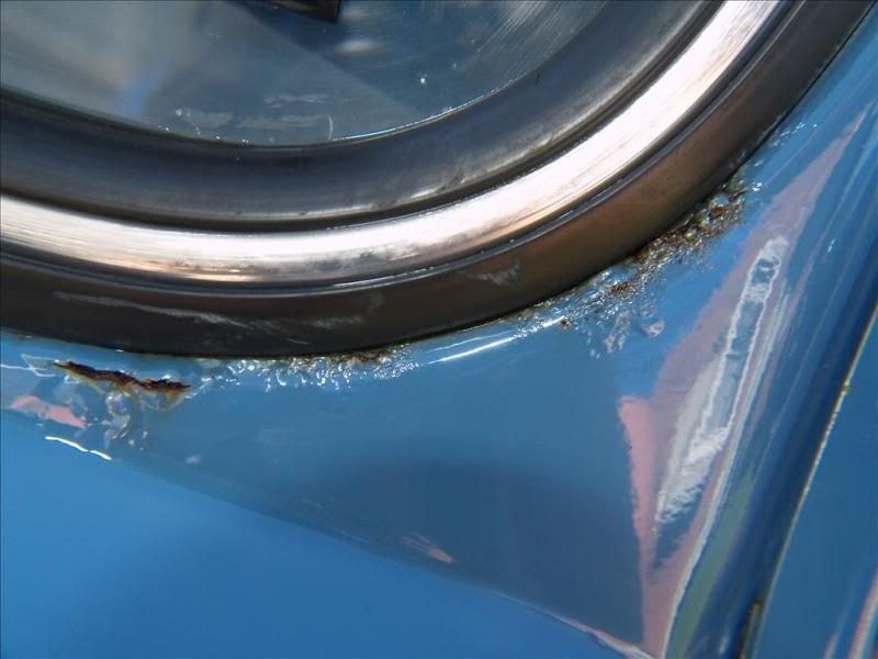

but my seals are fine, this on the other hand is not!

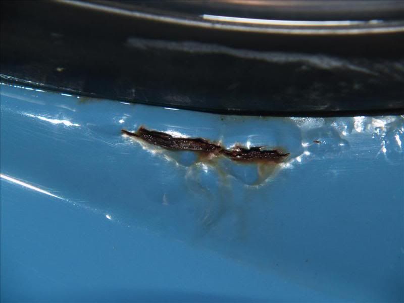

so i pulled my dash out today to take the top dash rail off (didnt manage get it off) , while i was doing this it started raining and water started to come in , noticed its mainly round the windscreen seal so i think thats my biggest problem for water getting in i did take some pictures of what i found
this is the drivers side
this is the passenger side ,looking up under the dash rail
