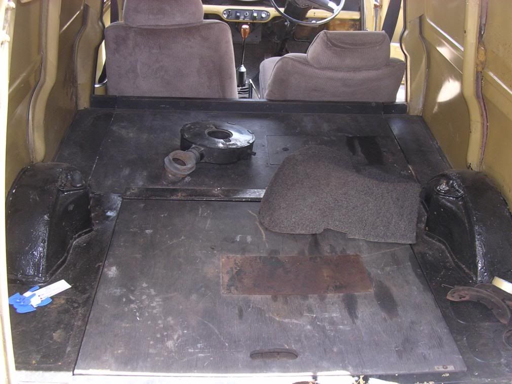

Could always do this,
http://www.theminifo...5&hl=van restro
It's one of the wagon load floor vans, he has more pics on his photobucket, I'm actually going to put a wagon floor in my van so I can have the extra storage I would get :)
If you wanted to do it totally as a metal load floor van you would want to pick up a van load floor assembly the van/pup inner sill strengtheners, a van/pup heelboard, and then the inner brace for the center of the tunnel http://www.somerford...roducts_id=1331, There is also a brace section that goes along the bottom of the center of the load floor between the front and heelboard. Then you have the battery bracket and the spare tire brackets. The main things that are not available anymore is the load floor front finisher and the load floor front rail that strengthens the front of the load floor in the van. then you have the side braces which are on both styles that went from wheel arch to roof seam that I think are also NLA.
It's actually easier to go from wagon to wooden load floor van. the rear companion boxes stay just cut off level with the floor, the center brace supports the load floor. The only things I'm not sure where to get are the metal decks that mount over the companion boxes, I have been hoping to ask l_jonez for some good pictures of them for my conversion.

From what I have seen, the forward deck for the wooden load floor seems like it is more or less... just the back section of the estate seat without the cushion folded flat with metal sections over the companion boxes at the same level. The van likely has it fixed down to prevent it from folding up, I am going to hinge the sections over my comp boxes with a lock so I can have secured lock boxes. And I think the side stiffener is to keep the long unsupported sides from flexing in the wind... but no I don't think it is necessary for operation.
Chris
Edited by CLM, 03 January 2012 - 08:16 AM.

Big picture from his post.
Chris
