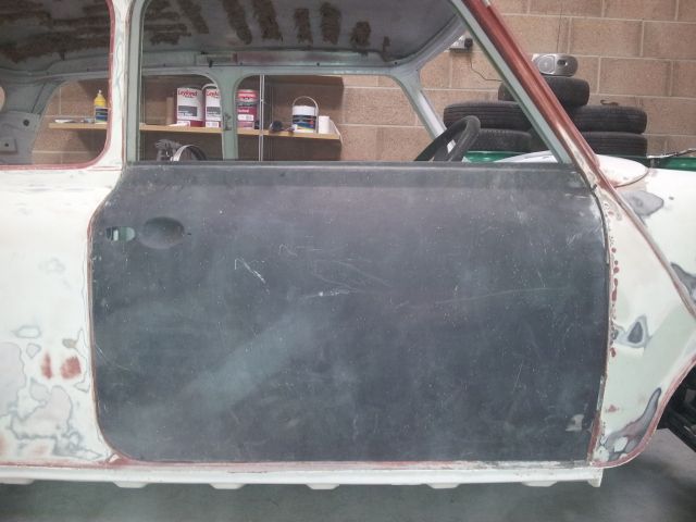

Posted 07 June 2012 - 06:36 PM
door gaps all over the place when the door was 1st fitted . but i think the window frame will need to be cut down to help with the gaps but i just hope the glass fits right if i do that ????
#351 STREET TWEAKS
STREET TWEAKS
  • 662 posts
Posted 07 June 2012 - 06:43 PM
the door gaps look better now as i have reshape the a / panel alittle at the top but the door needs new or better hinges as there is to much play in them .
and made a start on makeing good the crap filler work on the qurt and wing
#352 ToM 2012
ToM 2012
  • 4,066 posts
  • Location: halesowen
Posted 08 June 2012 - 04:30 PM
wow looks like you have been busy mate how did you get on with the door gaps as it looks better on the last picture better then before cheers tom
#353 STREET TWEAKS
STREET TWEAKS
  • 662 posts
Posted 08 June 2012 - 05:33 PM
not bad just need to cut the window frame down as in above pic , have a look on ebay for the hinges or have a look to see if you can get just the hing pins as that may work to ?

#355 minimuk
minimuk
  • 1,947 posts
  • Location: Midlands
Posted 08 June 2012 - 05:40 PM
Me thinks get a new set Tom,£52 from minispares, hinge pins you can get but are only for the external hinges Mk1and Mk2, internal hinges are a closed unit.

#357 ToM 2012
ToM 2012
  • 4,066 posts
Posted 08 June 2012 - 06:18 PM
hi mate if you fink a set of new hinges is going to solve the problem then i will get some and bring them to you tommorow? cheers tom
#358 ToM 2012
ToM 2012
  • 4,066 posts
Posted 08 June 2012 - 06:23 PM
is this the set you need??http://www.minispare...|Back to search
#359 minimuk
minimuk
  • 1,947 posts
Posted 09 June 2012 - 12:05 PM
If you are asking me, yep thta is the set, -7.5% TMFdiscount, it is worth it in the end, otherwise in time hinges and door starting to wear faster even hinge pins can break off......
#360 STREET TWEAKS
STREET TWEAKS
  • 662 posts
Posted 09 June 2012 - 06:19 PM
yep that looks right to me , do thay come with new bolts and washer ? if so great not bad on price by the looks .
are you happy to get them ?????
