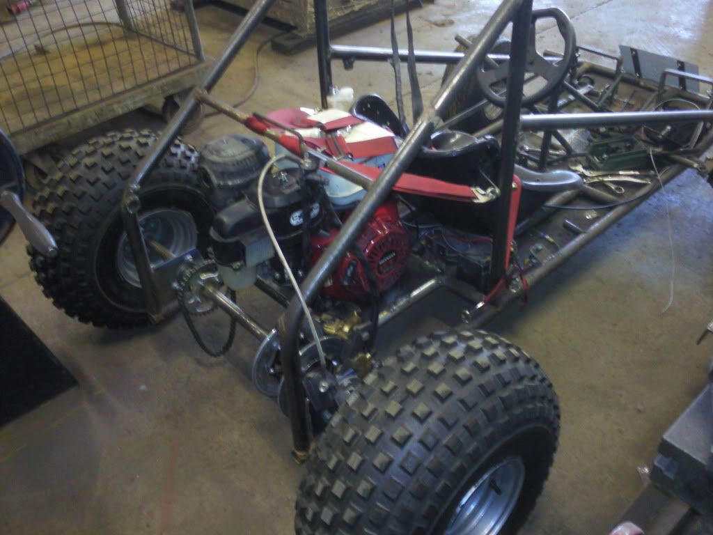

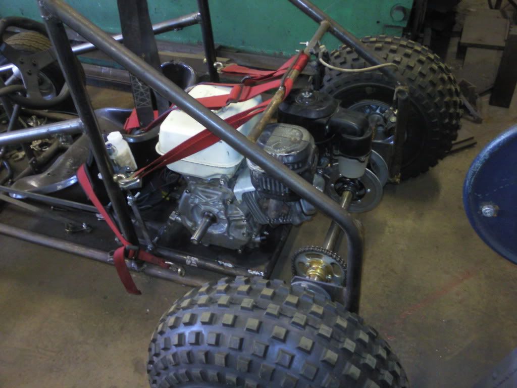

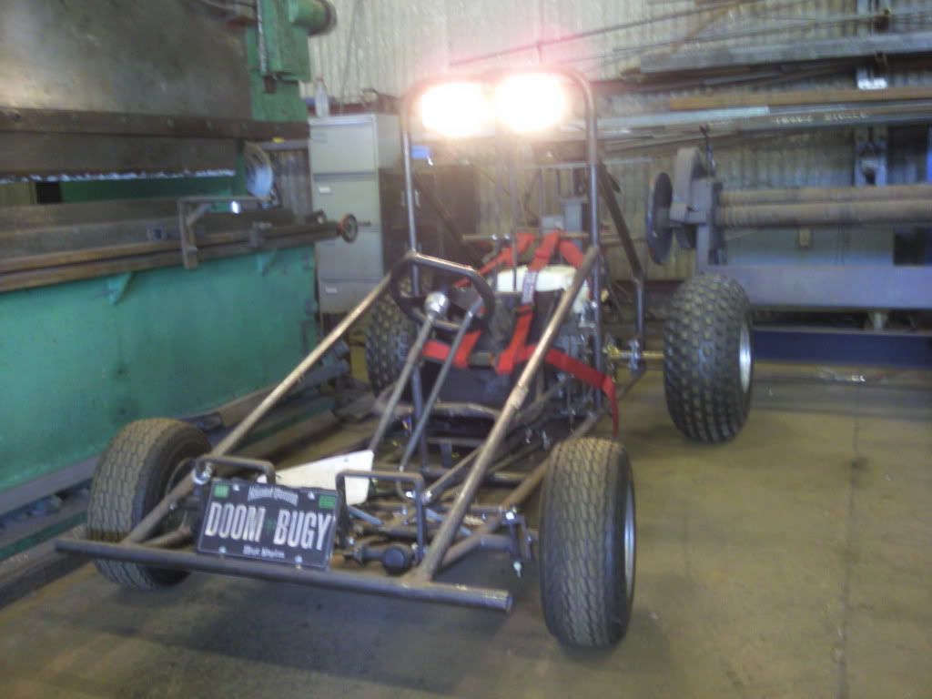

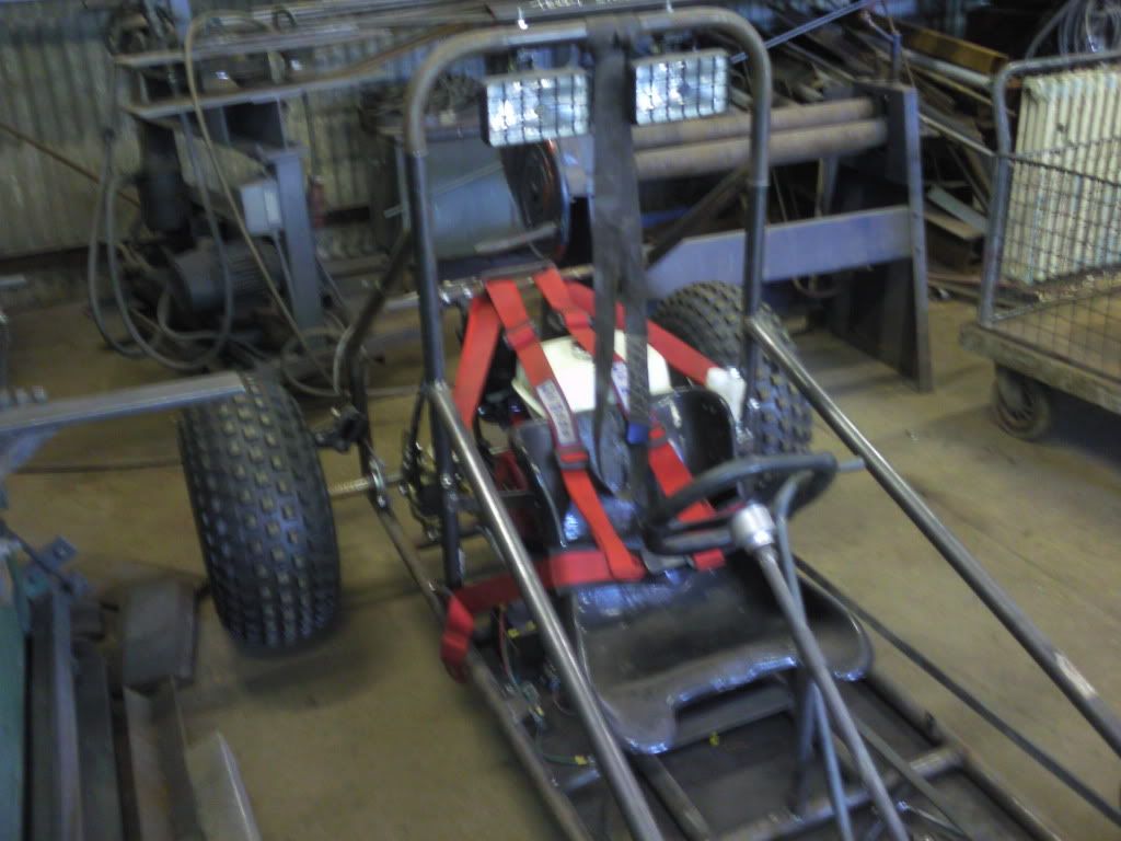

Slightly off topic but i'm building an off-road gokart (apologies for the giant pics) O_O :

cool what engine is that? 270? 390? we build an off roader in Cyprus but it was just a normal kart with bigger wheels. i'll try n locate some pics

It's a gx390, im gonna be running a torque convertor with 3:1-0.43:1 gearing
Had a centrifugal clutch but it melted in just 10mins of use!
There's a vid on youtube:
not very fast because the gearing was so high it took a while to get going.
