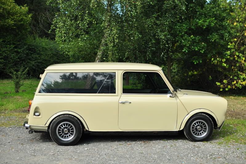

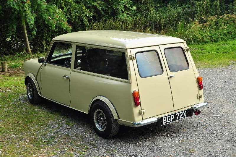

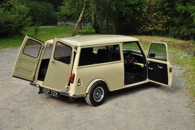

A couple pics of an estate with one piece side windows from my collection of clubby estate pics. =]
I know, it's an old,old thread.  Tupers, have you got anymore pics of estates with one-piece rear windows?  I have an estate with leaky windows and I'm trying to figure out a solution.

I helped build that beige estate, the rear windows took some head scratching but weren't actually that bad.
They're made from 4mm polycarb. We got some U shaped channel and fixed it to the bodywork around 3 of the sides if I remember right, then the bottom piece went in with the window and a dab of sealant and probably a spacer behind it. The original outer frames bolted back on to sandwich them in place.
